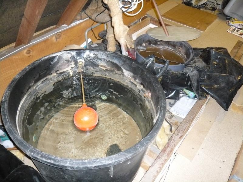

Hi Guys, can you help me?
I have recently changed all (but one) my radiator valves to TRV types.
As has been (laughingly) summer I haven't had to use the CH.
Now I have started to use the CH I noticed water coming from the overflow, on checking the cold water tank hot water is venting into it (over pumping).
This happens whether its heating the water or the CH.
The header tank is also filing up and the water being drawn into the system.
All the rads have been bled
Any ideas

It is generally correct for the Hot Water Cylinder to vent into the Cold Water Storage cistern (large tank of tapwater) if the cylinder overheats, e.g. immersion heater is faulty and it is boiling and the hot tap water rises up.
and for the central heating/boiler circuit to vent into the Feed and Expansion (small)
So I wonder which is the vent that is causing the trouble, and if the vent has been put over the right tank.
Water from the radiators/boiler is not supposed to get into the tap water, since it will be contaminated with rust and chemicals. And tapwater is not supposed to get into teh radiator water, since it causes rusting. One cause can be a fault in the cylinder where the coil has an internal leak, otherwise it would be poor pipework design.
I also wonder what sort of cylinder you have got. i am not familiar with the old primatic cylinder.
Some photos of the tanks and pipes in your loft, and of your hot water cylinder showing the various pipes that go into it, top, sides and bottom, would be very useful.
It is important to know the relative heights (above ground level) of the large and small tanks.
BTW Sentinel X400 is the Cleaning (sediment loosening) chemical. the Inhibitor is sentinel X100. You don't want either of them to get into your tap water. You might have to rig up a hose so any pumping over goes into the F&E.

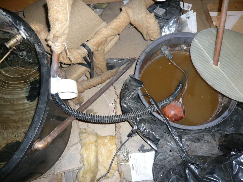

If you look closely at the LHS of the cold water tank you may see the vent.
I lifted it out over the tank to the side and then connected a black hose to vent into the F&E tank.
Try the 2nd image
I will post up a clearer image on my album.
Cheers
can you trace the vent pipes back to the airing cupboard to make sure the vent from the cylinder goes to the big tank and the vent from the heating goes to the small one.
then you need to check to see if you are pumping over, which I suspect you are. As far as I can see the obvious cause would be a partial bockage around the coldfeed/open vent connections.
