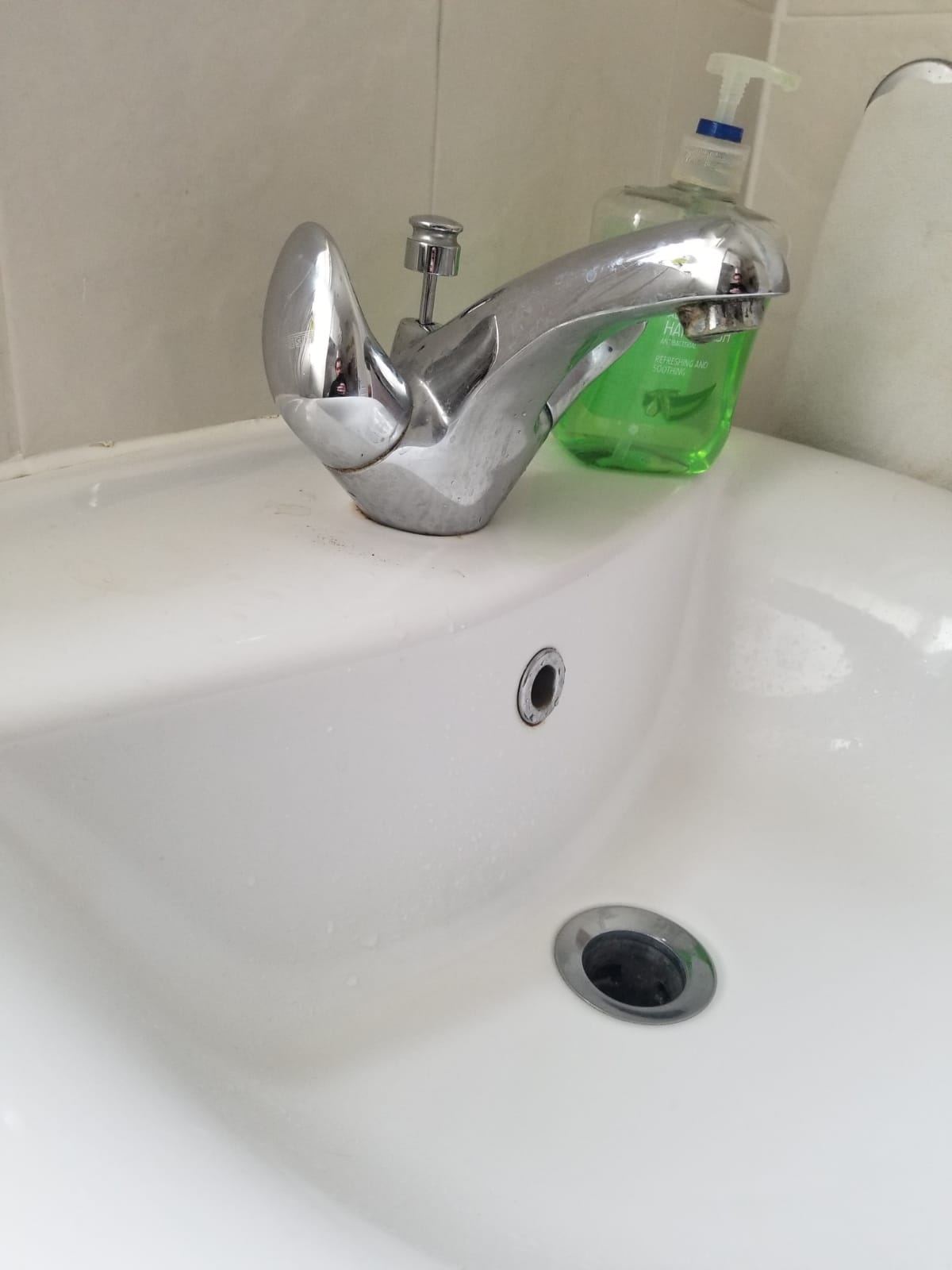

I have a water tank in the attic and a gas boiler and an immersion tank. Yesterday I drained the system (including the water tank in the roof) because I wanted to fit some isolation valves which I didn't actually fit. Now one of the taps in the upstairs ensuite won't put out hot water. Nothing has changed in the system other than me draining it. In hindsight I didn't realise that I didn't need to drain the water tank as I could have just turned off the outflow from it.
Is the hot tape in the ensuite not putting out water because of an air pocket or could it be because of rubbish going from the tank which might have blocked this pipe? Cold water comes out of the tap fine. Or is it something else? Wife is loosing her marbles over it, so any help much appreciated!

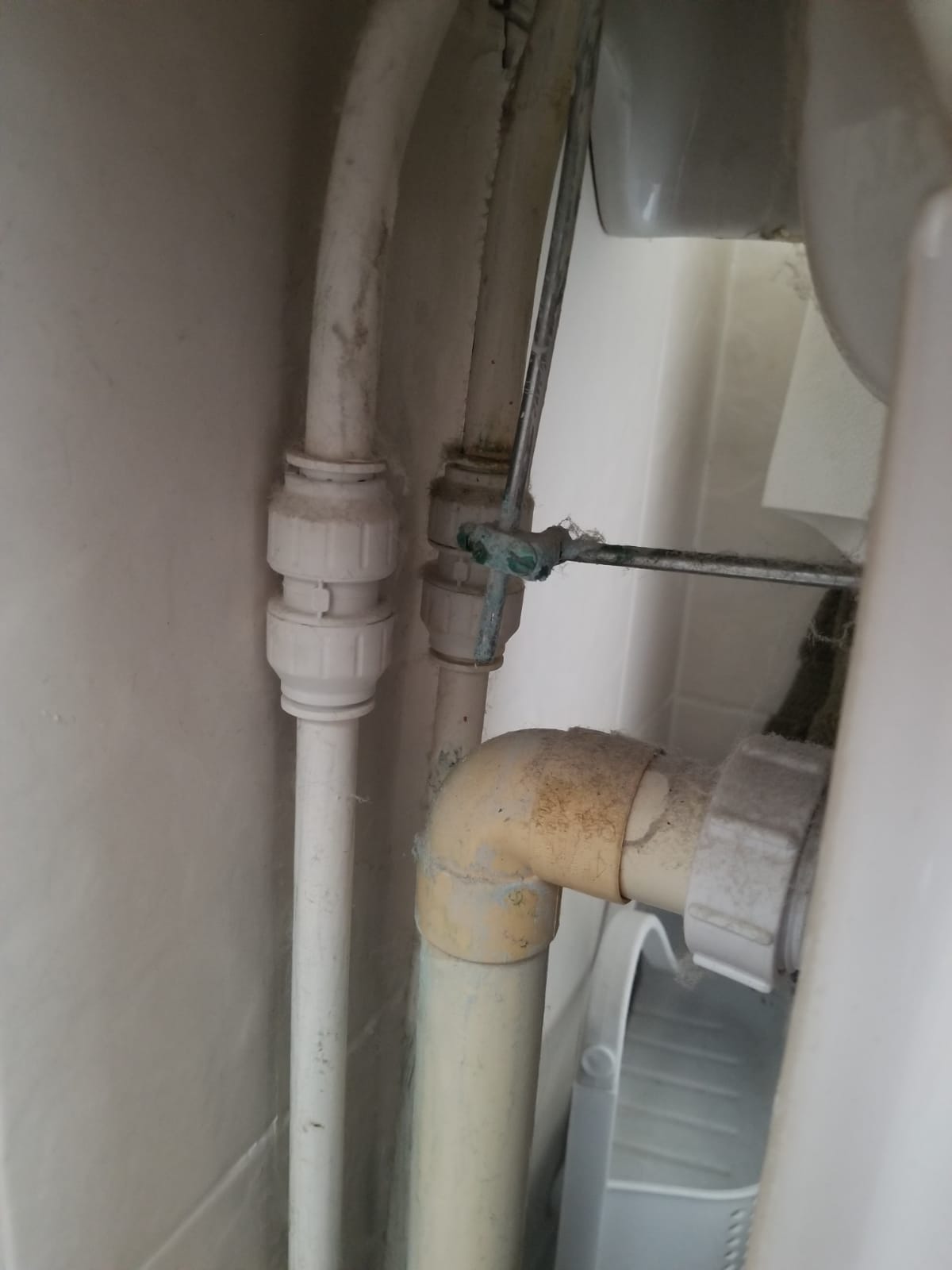

Is there an isolation valve on the hot supply pipe to the tap in question ?
Can you show pic of the actual tap ?
And is the problem no water coming out at all ,or is it coming out but just not hot ?

There's no isolation valve.
Water will come out of the tap, but just not on hot side.
Is the cold side of that mains fed or from the tank too? Put your finger over the tap and open the tap to the hot side and then bring it into the middle to open the cold side, if you're lucky and it's mains cold then it should back feed up the hot line and clear the airlock.
Is the cold supply to that tap from the mains ,or is it gravity fed from the tank ? If it's from the mains you may be able to force cold water into the hot side ,to help shift trapped air.

There are seperate levers for hot and cold Madrab
Yup, for some reason I looked and didn't see the other lever, jeesh!! Think I'm still asleep (y)
With any luck though it's a single flow tap so OP, finger over the spout, open hot then cold and you may be lucky and it'll back flow and clear the air.
Ok. So from my understanding upstairs cold comes from the water tank and it's only the downstairs that comes from the tank. I tried your technique and it seems to have done something as I now have a trickle of hot water coming out of the hot water side and I can feel the hot water pipe is now hot. How do I turn the trickle into a flow?
