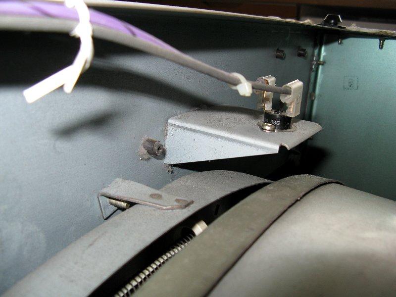

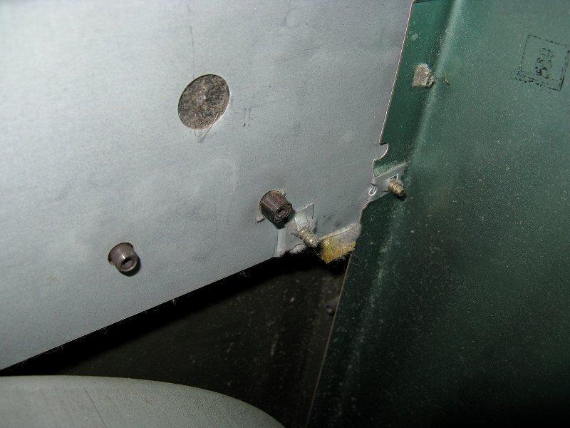

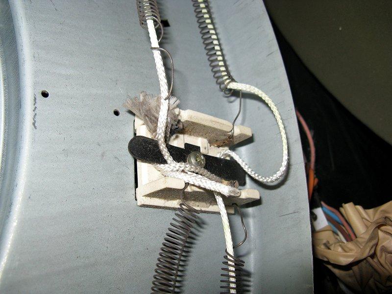

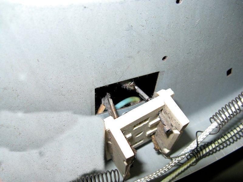

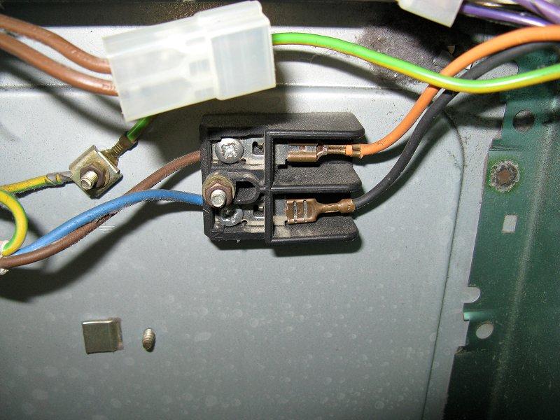

For info - I have completed the repair by replacing the heating element.
It wasn't too tricky, just a bit fiddly.
I did take a few pictures along the way, and am happy to post them if people wish. They are only relevant for wiring - so that I didn't mess up :)
post them
Sorry for the delay. I've put up some pictures.
Taking the lid off is trivial as is removing 3 lower screws from the bottom of the front area.
I suggest lying the machine on its back when removing the heating element, this will allow the drum to be better positioned a the front of the machine acts as part of the drum "spindle".
Any questions, please ask.
