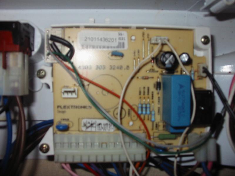

i cheked the main PCB board all looks good there i reseated all connectors too.

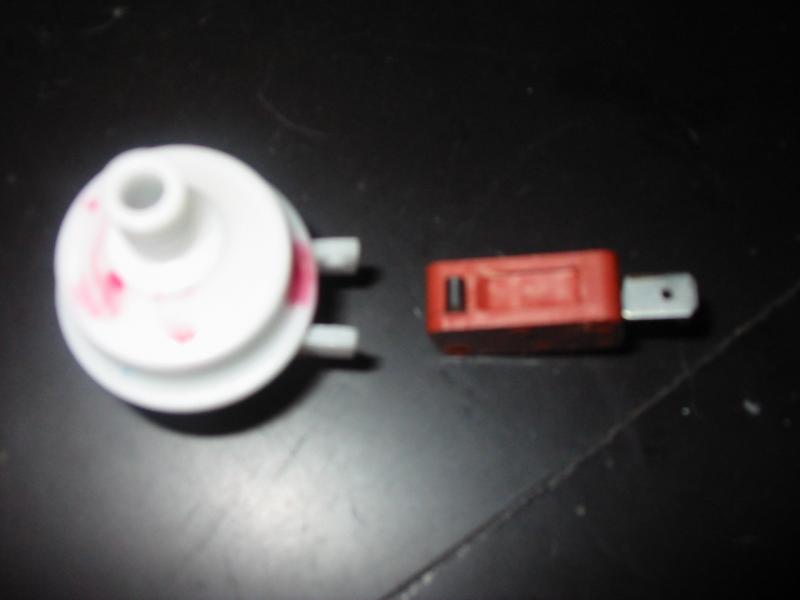

Now i also took out the high pressure sensor to test that also
http://www.hotpoint-spares.co.uk/high-pressure-sensor-for-fdw20p-p-122251.html
there are 2 pics attatched ,
i took the actual switch (REd) out of the sensor housing (white)t slides out with the help of a flat blade screwdriver.
it works perfect , there is continuity between the two contact points when it is out of the white housing,
and when it is out and i press the black button contunity breaks just as it should
when i put it back in the housing continuity does not break,which is normal
But then i blowed and sucked down the pipe to create pressure , i hear the insides move up and down but that does not activate the small black switch,as I would expect..
so then i used a fooot pump that created enough pressure for
the switch to be pressed and then the test worked continuity was broken
and upon releasing pressure from the pump ,
it went back to its normal state of continuity
Question do i have a faulty switch here as a lot of pressure is required for it to click the small black button should it click the black button by just blowing down it ?,
when the black button is down continuity is broken as it should.
anybody got one of these at hand they can check :)
or any ideas I can work with :)
thanks
any suggestions appreciated..

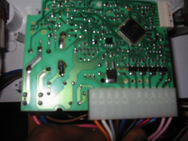

I have included pics of the back of the PCB also , looks like the diodes are micro diodes on the PCB
