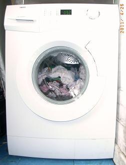

It's fairly straight forward IF you've done it before - I hadn't!
With a bit of help from Tinternet, it took me 12 hours including head scratching, sourcing of parts / tools and
occasional spanner holding moments by partner. I could probably do it in six next time knowing what I am about to
impart plus holding toolkit.
You must equate the value of your own time weighed against repair person.

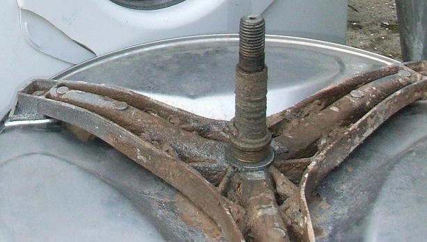

Slacken off motor and remove pulley belt.
The nut and pulley may be unscrewed (I had to drift the drum shaft forward bit by bit)
The Pulley comes out from beneath.
Remove inner drum forward to reveal the two bearings (remains of seal in front).
Both mine were intact but my front was clearly shot.

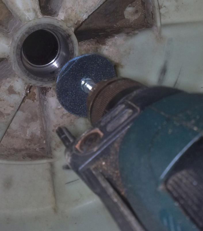

From hindsight, I would suggest it is well worth great effort to try and remove all trace of front seal and clean at
this stage.

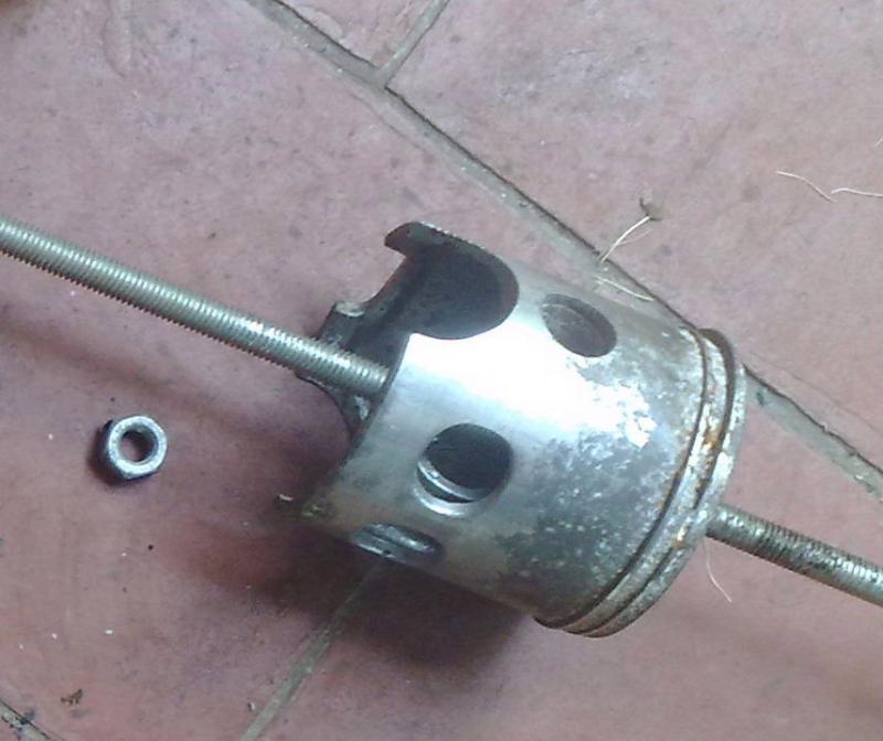

I proceded to create a puller from an old piston with a long bolt and socket to draw out the front bearing. Only with
additional drifting from rear did I get some movement but, eventually, the bearing race collapsed. The seal was
mostly out - well corroded and (I suspect) the bearing was siezed on this crud. Oh woe woe and thrice woe!

Machine Mart offer a three puller set from which you need the 3" & 4" in combination.
Because the bearing has collapsed and is forward, the 3" puller will fit inside but nothing to bear against.
Take the thrust bolt out of its centre.
Take the legs off the 4" puller, reverse it and nest it inside the 3".
With all the link bolts tight, this stiff assembly holds together as one whist positioning it.
The hybrid puller now activates from the rear but - again - additional drifting is required.
