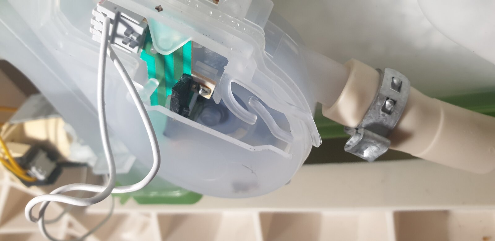

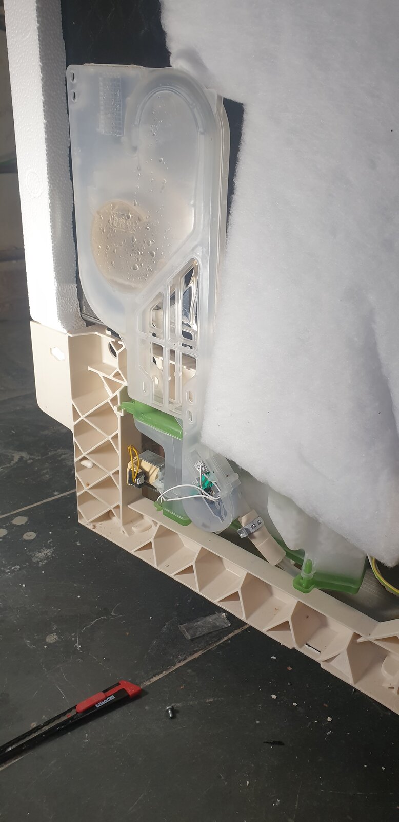

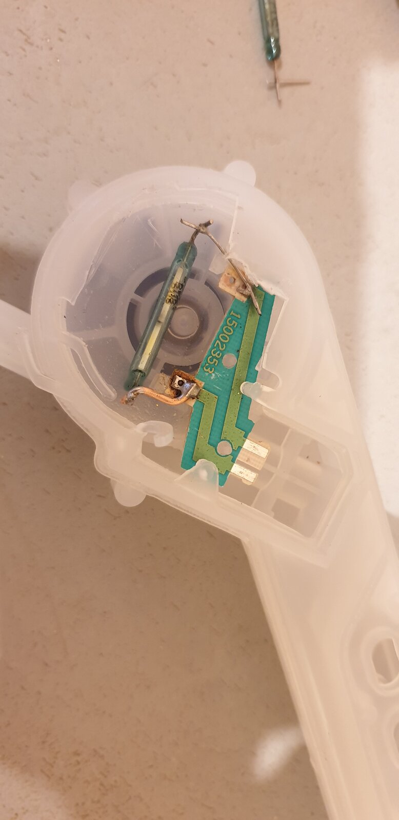

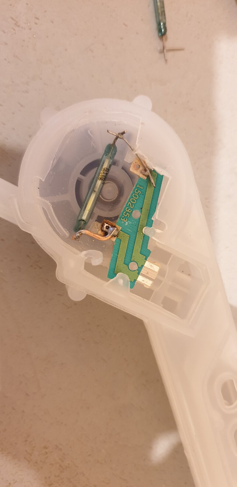

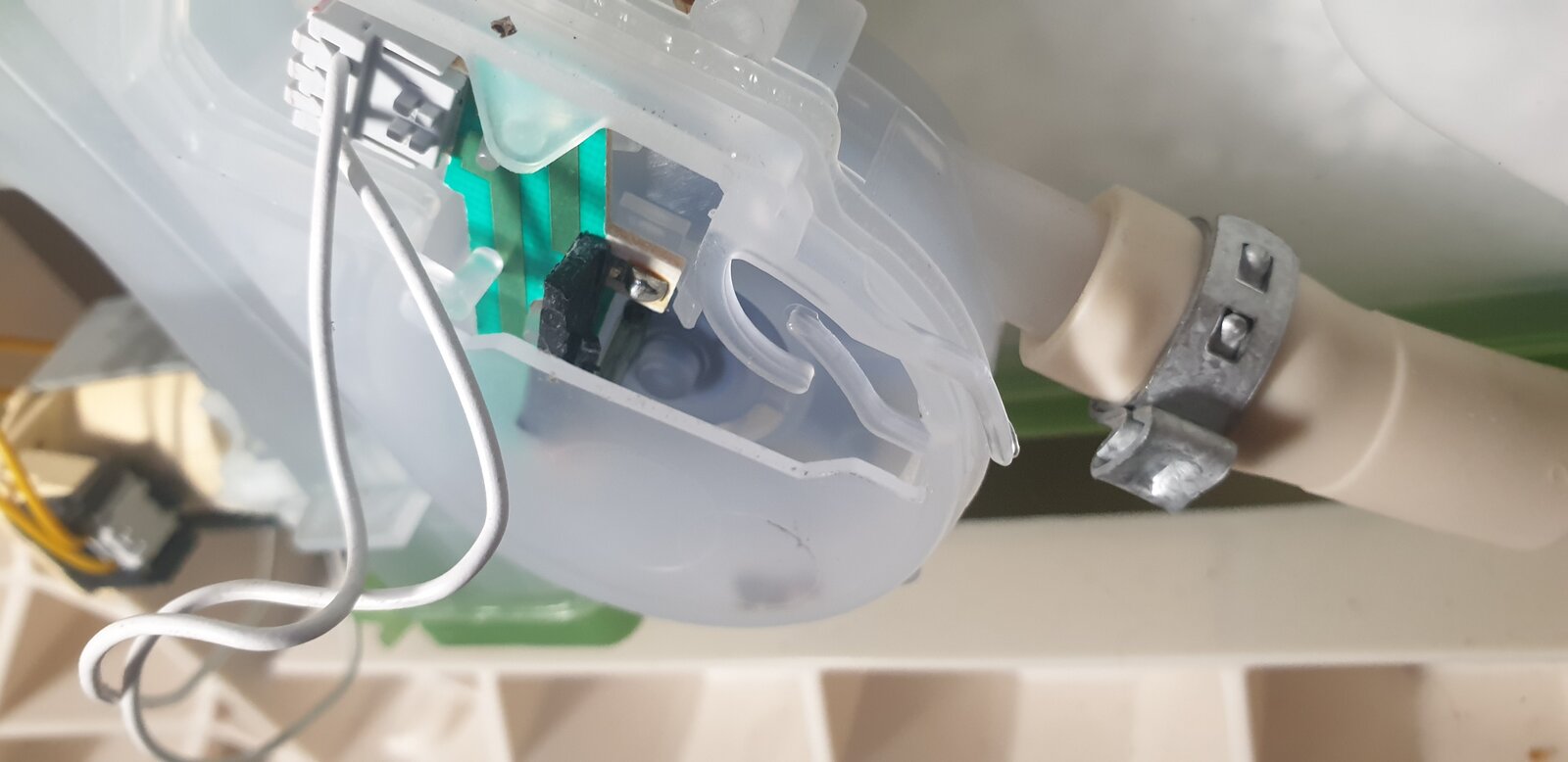

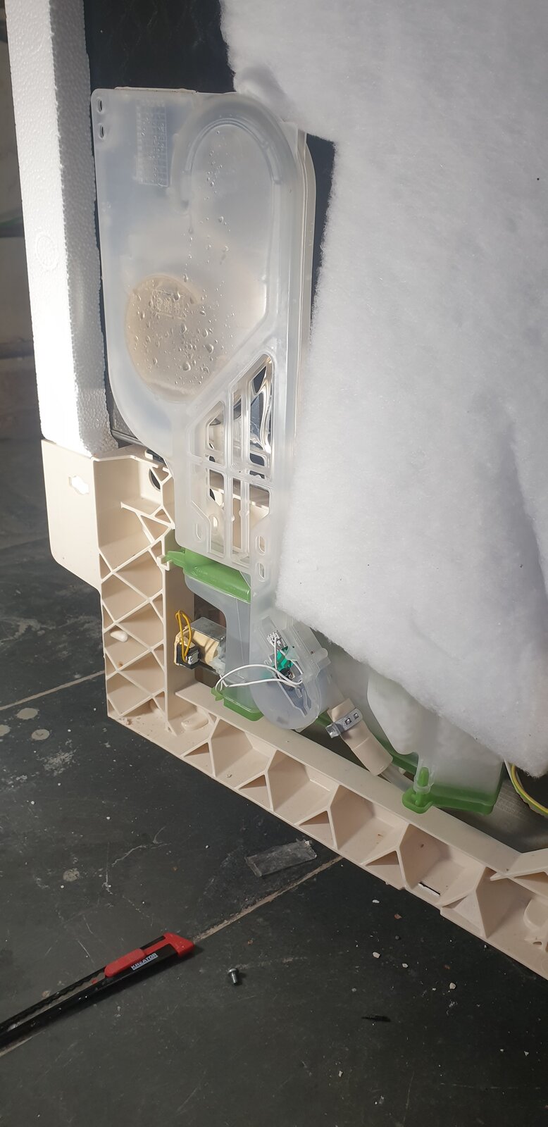

I've pulled the side of the machine and located the air break and turbine. There's a small flow wheel and red sensor that measures the rotations of the wheel letting the machine know how much water has been pumped in. The red sensor is worn out. If I push it closer to the motor the beeping stops. Tried wedging it but not reliable. See pic. I can purchase a new air brake and turbine unit for around £20. But I'll have a go at replacing this reed sensor with an off the shelf one. Fingers crossed.

Only reed I could get in my local was a bit big. Thought I'd give it a go but the magnets in the flow wheel aren't powerful enough. I can find smaller more sensitive reed switches online. But at this stage I might just replace the unit.
