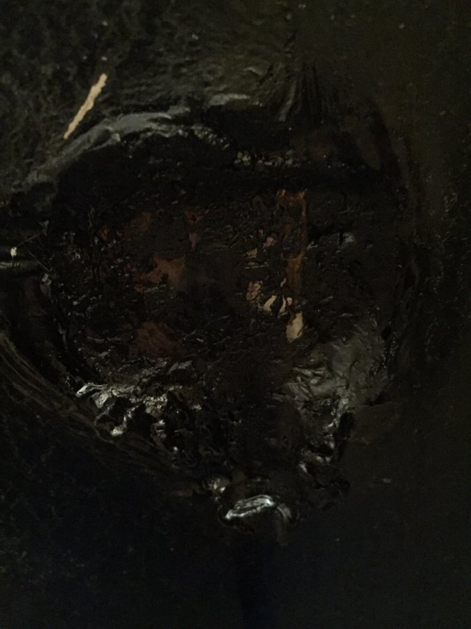

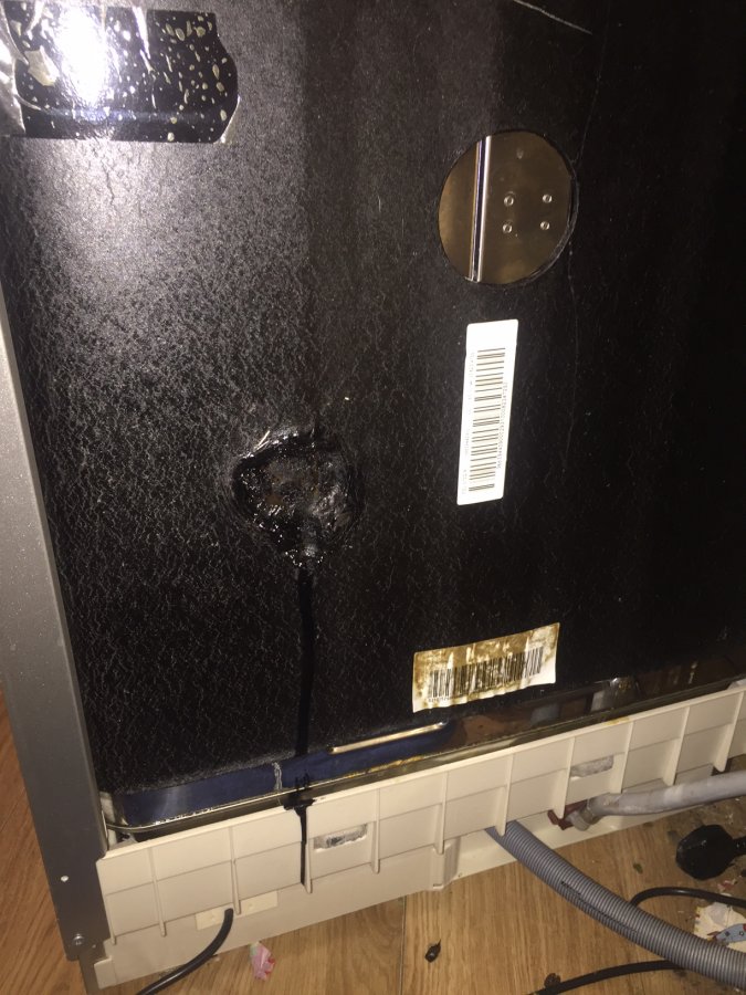

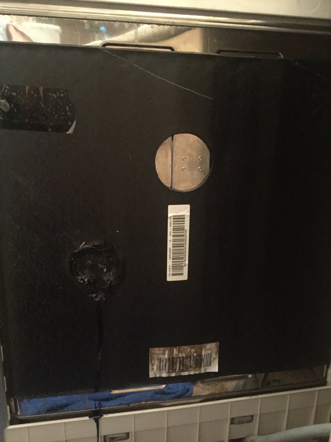

Weve had a Hotpoint Dishwasher FDL570 for 3-4 years and tonight it stopped working mid cycle. All of the lights started flashing on the front and since then it will not start or finish a cycle, it just appears stuck.
Doing some troubleshooting online caused me to pull the dishwasher out and I saw this melted away at the back of the dishwasher! (it isnt fresh btw so I dont know when it melted but it literally did a wash a couple of hours before it broke and it finished fine!) Ive done a search on the internet and it looks like this model was recalled due to someones catching fire - link - http://gcmagazine.co.uk/warning-released-recalled-dishwasher-causes-blaze/ We clearly need a new dishwasher but not sure what we should do about this one. Im joining the website it states on the link but I just thought id post on here to see if anyone has any experience or advice?

Ive just joined the website and been on the hotpoint website but it says no further action is needed i.e it hasnt been recalled? Abit of a contradiction but i guess i'll ring hotpoint on Tuesday. Washing machine broke last week and now the dishwasher! grrrrrrrrr Thanks again in advance for any advice :)
the back of many dishwashers has a sound-deadening coating which is soft and sticky. If it touches something, for example a plug in the wall behind it, it will stick to that thing.
The damage in your pics looks very much like a section of the sticky layer that has pulled off because it was stuck to a plug.
Is it?
Thanks John, I think your bang on there. Im going to take another look but I think your right....I didnt realise it had a coating on the back. Back to square one lol Is it dangerous as is? (providing it worked fine i mean)
Mine did the same. I taped a piece of non-stick silicone baking parchment to the back of the machine to prevent it sticking again. If you can, it would be better to leave a bit of a gap to prevent it touching, which would also allow air circulation.
Thanks alot mate, really appreciated! Ive just looked again and its definitely the coating (I just saw it melted and assumed the worse lol). Yeah we'll leave a bigger gap next time, I ddnt even realise it had a coating on...I think its game over with this machine though :(
