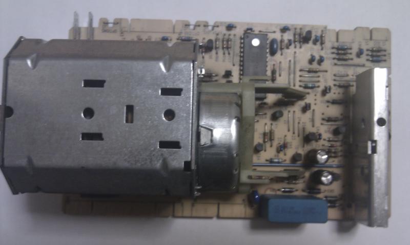

my Hotpoint WD71 has a new fault
the infobubble display say close the door
but i think the circuit board in the facia display is the guilty party.
because
when you close the door it seems to shut ok and hasn't been slammed and has no signs of a breakage
and also when you switch off the thing takes 30 seconds to delease the door
if the door interlock was at fault then the above sentence wouldn't be the case or would it ??????

you have date code 07 in the corner its been replaced .check the pcb for a burnt track. date codes for the locks when they are made are in the top right hand corner .door locks should be replaced every 4 years due to useage.check door rubber also for a split above the door lock water can get onto the lock and blow pcb .your lock is fine pcb has blown some where.
impressive stuff rocks1
the pcb located in the facia panel was faulty before
hopefully getting a replacement on order tomorrow

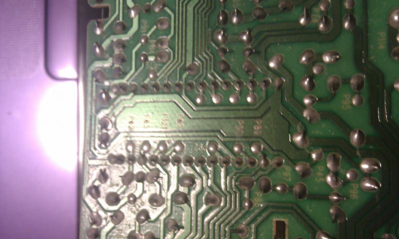

Now check the pcb on the top. There will be a blown track on there. It's under the first black block. It the netural wire from the door lock that's blown it.
Remove screws from the dispenser, then consol panel pulls off. Then remove 2 screws that hold the pcb in place.
