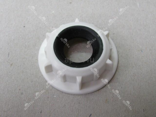

Hi,
My FDW60 Dishwasher stops and flashes two lights just before the drying cycle, Eco & Prewash, this indicates the filters need cleaning. All filters and pipes have been cleaned I have even replaced the drain pump. Still it will not finish a cycle and stops. The lower arm is also not spinning, so I suspect the circulation pump is not pumping water with enough pressure.
Everything has been cleaned and there is nothing stuck in the arms or pipes or pumps, all were stripped down.
It's possible an outlet valve is stuck open but not sure if this model has such an item, can anyone clarify if it does?
What is the part in the attached picture, it's attached to the dishwasher water sump and looks like a solenoid?
Any help appreciated, this is really annoying.
Many thanks
Half load solinoid , check it with a continuity tester see if it's open circuit. Otherwise you will need a circulation pump.
Thanks for the fast response and identifying the part on the photograph.
Do you know if there is any drain valve on this model that may be jammed open, I didn't see anything during the strip down and the circulation pump looks good and appears to push enough water to spin the top arm.
I thought the fault could be caused by a leaking top arm that would reduce the pressure of the water, however it all looks very good. Reluctant to spend more money on this now as it has become a bit of a guessing game.
Thanks.
Check the ring nut at the back of the tub , which the top draw goes into that's poss perished.
I know this part well, I have replaced it on numerous occasions before to improve the Upper Spray Arm performance.
The one on the dishwasher is new and so is the seal between the upper spray arm and the basket. I have even checked the little ball that moves around in the upper basket depending on the height setting.
I think it is either a faulty Circulation motor, although it forces enough water to spin the top arm or a faulty control board.
Is the circulation motor controlled by a Triac, I wonder if the output voltage is a little low?
Still not sure why this would cause the Eco and Prewash lights to flash...very confusing.
It's the circulation pump. Done 2 today for same fault. It gets hot and stalls , the error lights are not always right just a guide.
Thanks so much for your advice, I will try and obtain a circulation pump and give it a go. I will post an update as soon as I have confirmed that the new pump has resolved the issue.
