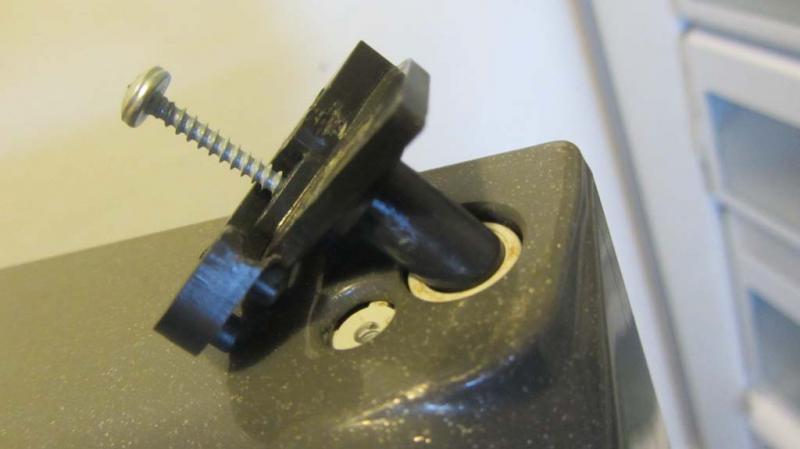

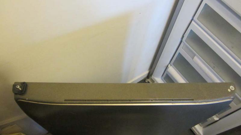

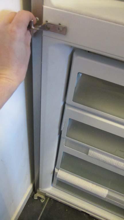

I have another issue at the moment and currently in the process of revesing the doors on a FF187E Fridge Freezer, I have inserted an image for review also.
if you notice the plastic brackets which have one screw into them I'm trying to position the door hinge to be on the left side as you can see I have posted pictures of the plastic fitting both sides as an example, one side fits fine for "right hand hinge operation" but when I exchange to the left and screw it in, it does not seem lined up properly or compatible, when I just screw it in anyway the door jams. any help appreciated thanks.
PLEASE NOTE - FREEZER DOOR IS UPSIDE DOWN IN ALL PICTURES
PIC 1 - you can see where the original position of the plastic bracket was
PIC 2 - you can see the destination and the screw does not line up with the screwhole
PIC 3 - if I line it up incorrectly the bracket is not twisted to the wrong position (you can also see the little mark where the door was jamming when I tried screwing it in
PIC 4 - and overall view of the hinges on the left (which is my destination position)
Hi Zorgan
I have exactly the same problem as you. It would appear that the plastic brackets that are fitted are DX (right handed) you will need SX (left handed) brackets but nobody seems to be able to supply them. Did you find a solution?
