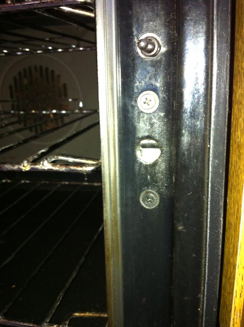

Hi,
The main oven door catch for my Hotpoint HUE61G cooker is broken. I can get a replacement easily enough. I'm trying to work out how to fit it !
The door has hinges on the side, not the bottom. And the catch fits behind the front panel oven surround. There are two screws I see from the front which hold the catch in place, screwing though the frame into it.
So how do I access the rear of the front frame ?
Do I have to take the door off, and how ? Does the frame come out the front, or should I try to take the side panel off ?
If anyone has any mechanical diagrams of how the frame goes together, I would appreciate the help.
Cheers,
Colin.

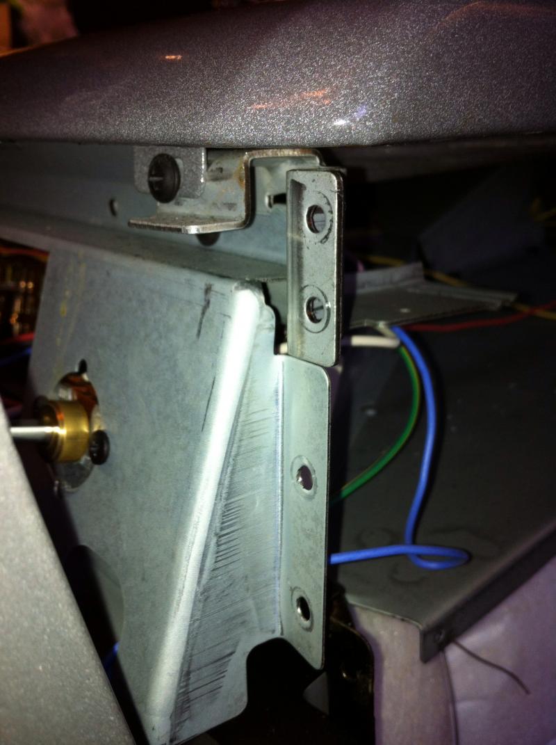

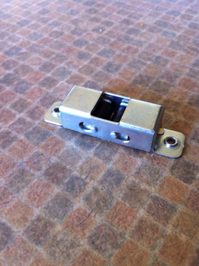

Some comments and pictures while fitting the door catch.
New catch, . . . . . . . . . . . . . . . . . . .where it goes.

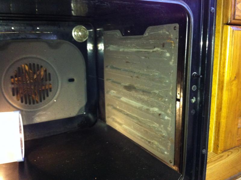

You DO NOT need to remove the oven self-cleaning linings.

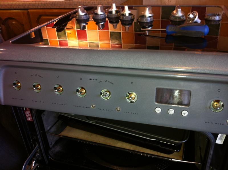

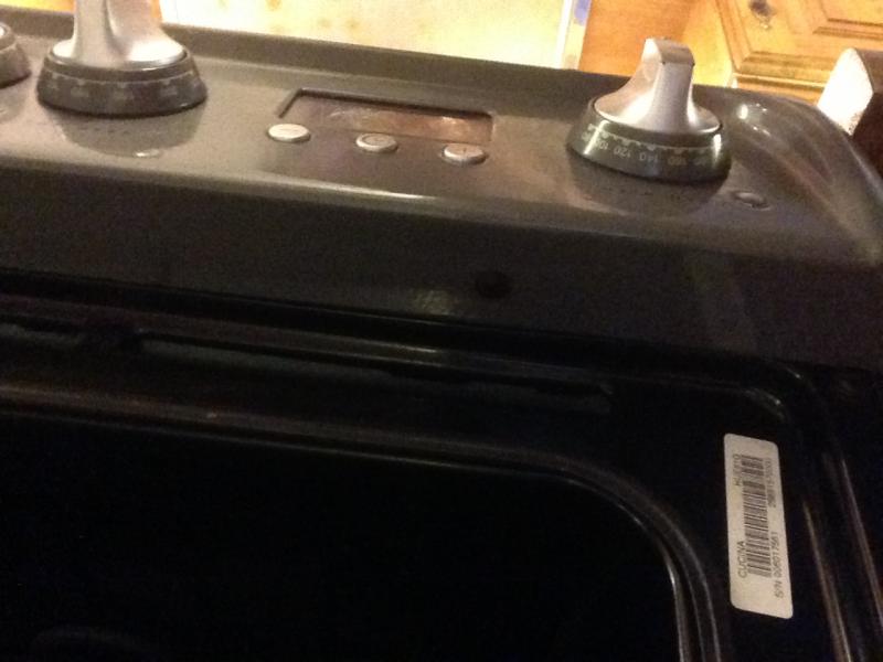

You need to remove the knobs and front control panel.
There are two screws under the control panel, open the top oven door fully to access them.

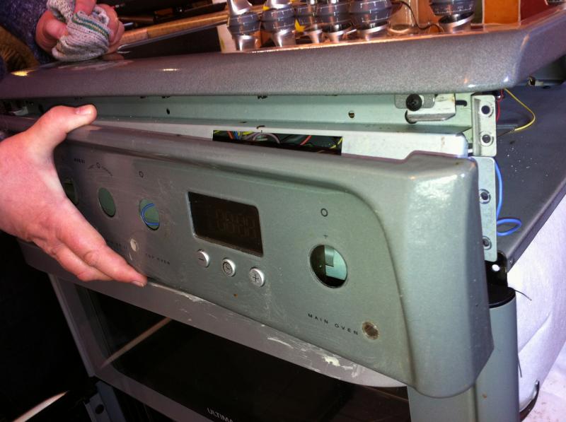

Then with the knobs removed the panel pull out gently.
There is a cable connecting the clock and timer, so dont pull too hard.
Then some screws behind the control panel, and further down the right hand side.There is a line of screws down the rear of the side panel too (sorry, no pic of the rear.)
Then the top lifts up a little to release the whole side panel.

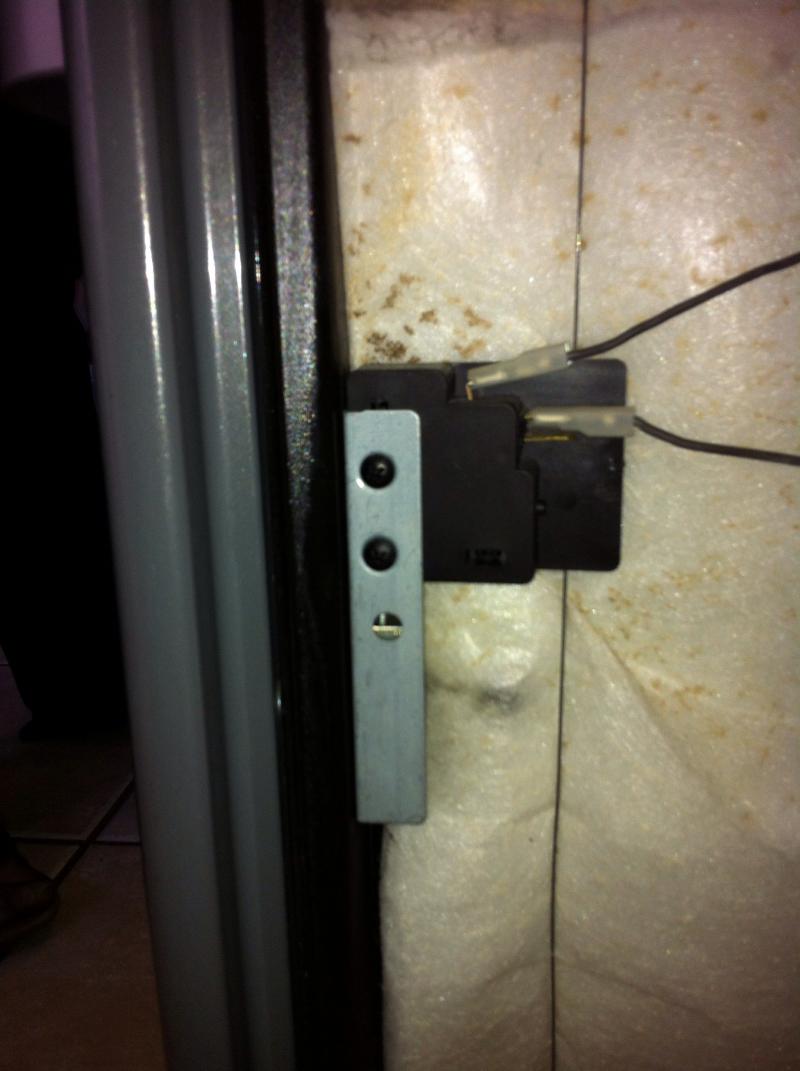

And eventually you get access to the door catch.
The screws from the front (picture above) release the catch.
Refitting is straightforward, but do note the side panel has some tabs to be engaged behind the frame before screws are fitted.
Overall the job took me one hour, including cleaning around the control knobs etc when things were accessible.
Cheers.
HI Colin
Tried really hard but cannot take the front panel off where the buttons are. Managed to get the buttons off easily but cannot find the screws underneath. Can you help please? :?: :?:

Hi Clause,
Apologies for the delay in replying.
If I remember correctly there are just two screws under the knobs panel. About 3 cm in from each end. You have to open the top oven/drill door fully to see them. I will take a picture this evening and post it.
Cheers
Colin.

Pictures of the two control panel screws now added to above sequence.
The panel is still quite a tight fit under the top cover, so with knobs and screws out you have to pull at it quite firmly, ease it out either side a bit.

We have a HUD61K and these instructions worked! I would add three notes:
1) we struggled to get the front electronic panel off. If you unscrew and lift the bottom slightly and then slide the entire panel to the left mabe an inch or so, it should come free easily!
2) we really fought getting the side panel off too. Ensure you have removed the screw on the front (above the screws you removed under the electrics) which will help loosen the top. There is also a screw on the back to help this too. The panel needs lifting slightly to get it over two locator tabs on the very bottom edge. We mostly only managed to get the front section of the panel off at maybe a 45 degree angle away from the body but this was enough to get fingers in to fix the latch. P.S don't lift the top too much if you have a glass lid, ours didn't break but I envisioned it happening!
3) when you unscrew the latch it falls out, ok that is perhaps obvious but it is not attached in any way to the part (shown in colinregan's final picture in black and silver) which is the switch for the oven fan. The latch sits behind the silver part. Our latch needed to be held incredibly firmly as the screws had to partially cut into it! So we found it easier to cut it first before trying to fit it!
Thank you once again people! Hope others find the additional instructions helpful, and they save you half an hour in pulling, pushing, sighing and scratching your head with an incredibly greasy finger!!!
