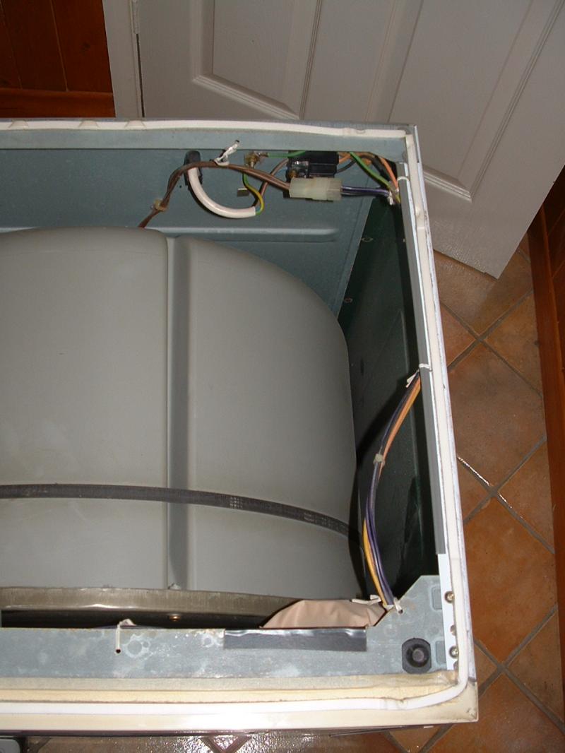

I have had the top and the back off this machine and can’t see anything that resembles the stat. The heating element seems to be at the front of the drum (making it nigh on impossible to get at - see pic.1 NB. the front of the machine is at the top of the picture) and under the drum is basically the drive wheel and motor for the belt (and air intake fan).

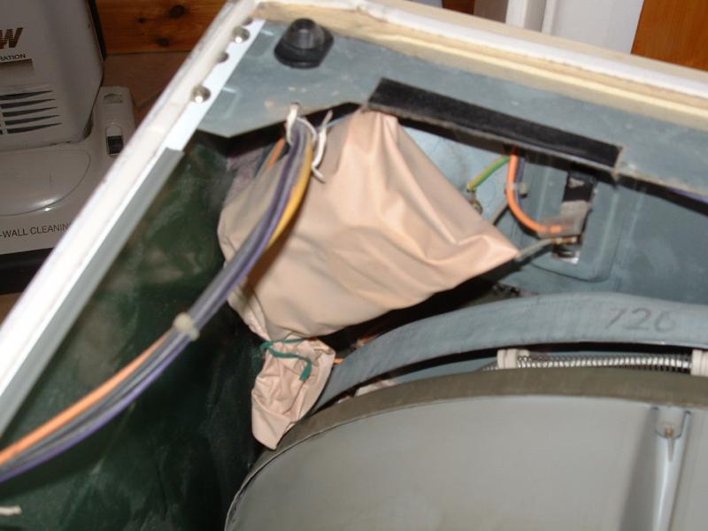

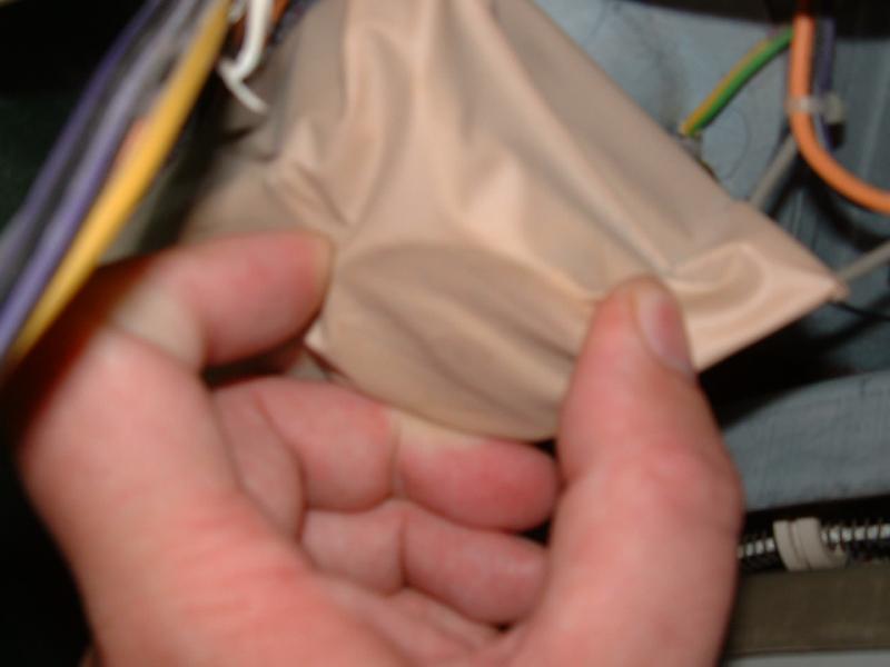

The only thing that might resemble a stat (without taking the drum out to check down the front but there doesn't look like there is room down there for the stat anyway) is behind the timer wheel. The timer wheel (on the front of the machine) has a small 'bag' of electronics inside directly behind the wheel (see pic.2). This bag is quite tight and is tied at the bottom with a sandwich bag type tie. Feeling the bag, I can feel a round device that would appear to resemble the stat in shape and size (with a very small dimple in the middle - see pic.3). However I cannot remove the bag (have tried by removing the tie and trying to tease the bag up). I don’t want to tear or cut the bag as I assume it is there for a purpose.
Can anyone tell me is this likely to be the stat ? If so, what is my best way at getting at it ? If not where am I likely to find the stat ?

The item with 2 wires, fixed to the bracket above the heating element in pic 1 looks like a thermostat. It is difficult to tell from the pic, but if it has a little red button between the 2 wire terminals then it is the resetable type & you just press down the button gently until you hear it click to reset. If there is no button & it tests open circuit with a multimeter then you will have to replace it. I am not familiar with your drier, but they often have 2 stats, 1 resetable & 1 overheat stat that is not (usually next to one another), so you may or may not have to look for another one. I doubt if the other item you refer to is a stat as it is not fixed to anything that will conduct the heat from the drum area to it. It looks like the timer motor to me.
Thanks jj. You were right, that was the stat.
Had it off and it looks OK. As I don't have a multimeter I did the naughty thing of disconnecting the wires from the stat and connecting them together (temporarily, have now put back as was) to see if the heating element would heat.
As it didn't I assume the heating element is actually bust !
Thanks anyway. Much appreciated.
Andy_P.

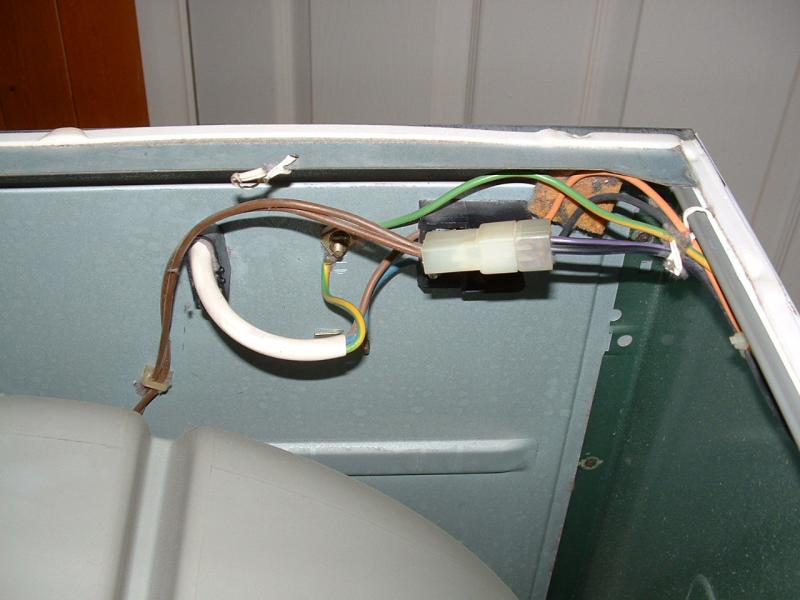

The other thermostat is located by the mains lead at the back of the machine.It has a plastic push connector which you can unplug to test it.However the most likely cause of no heat on this one is the spiral elements coming detatched at the terminals.

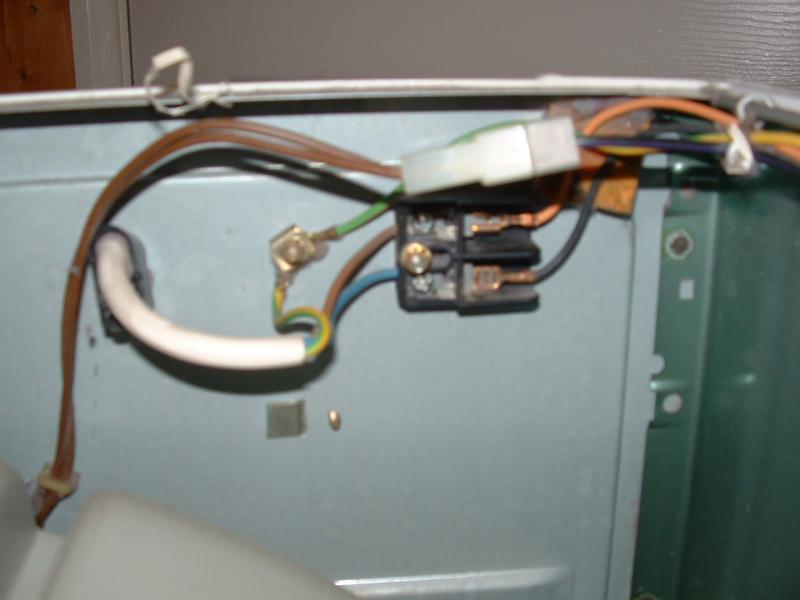

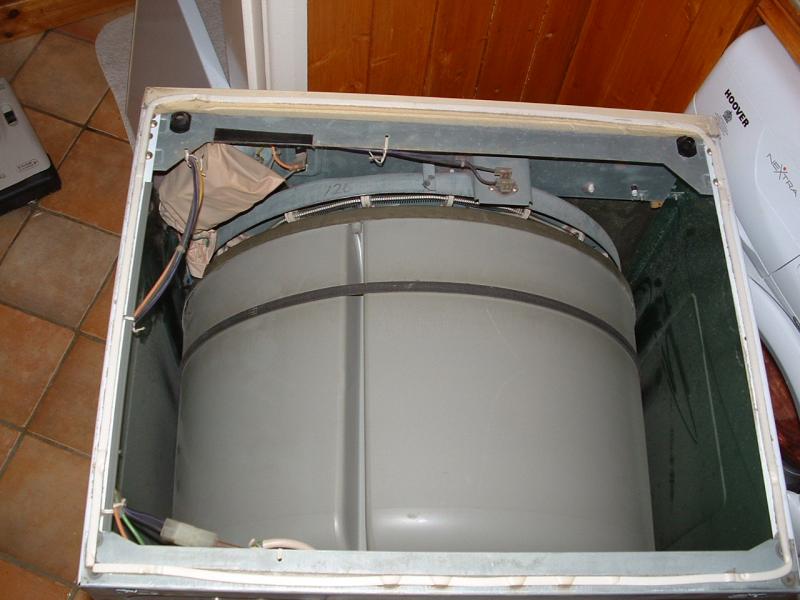

I can't see the stat at the back (have taken a few more photos to make sure I am not missing anything obvious - this time the top of the photo is the back of the machine).
Firstly, am I missing the wood for the trees here guys (ie can you see the stat) ?
Secondly, assuming that it isn't the stat and is the element that needs reconnecting at its terminals, can you tell me where I would locate those terminals and how I get to them? Is it a front off the machine job ?
Really appreciate your help on this guys I would love to nail this problem.

I am really just guessing now, but as I cannot see any cables going to the element in pic 1, then I suspect the terminals & possibly the thermostat are at the bottm of the drum. Have you tried turning the drier upside down?
The exhaust thermostat wiring goes to the plastic connector with two brown wires coming out of it just next to the mains block,clearly visible in pic`s 4,5&6.
