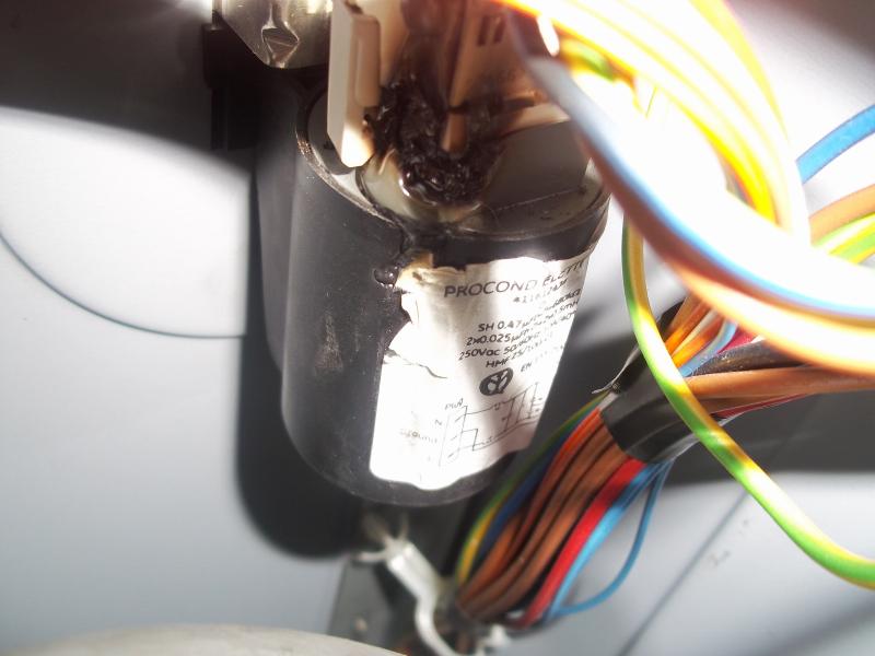

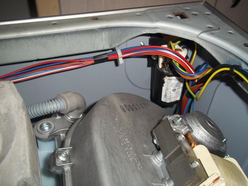

I need some help with my Hotpoint wd440 washer/dryer. Keeps tripping mains electric, water didn't drain away mid cycle. Managed to take off back panel and clean filter, a few coins etc, took off lid and noticed at the top right hand corner where the mains cable enters into a small black filter box it has melted. Blue wire has also melted.
Have found this part cable/filter on hotpoint site for sale. Can I just buy it and replace or is this a sign of a bigger problem that needs expert help?

Yes just replace it. As long as the top wires are not damaged otherwise new wires are needed.
