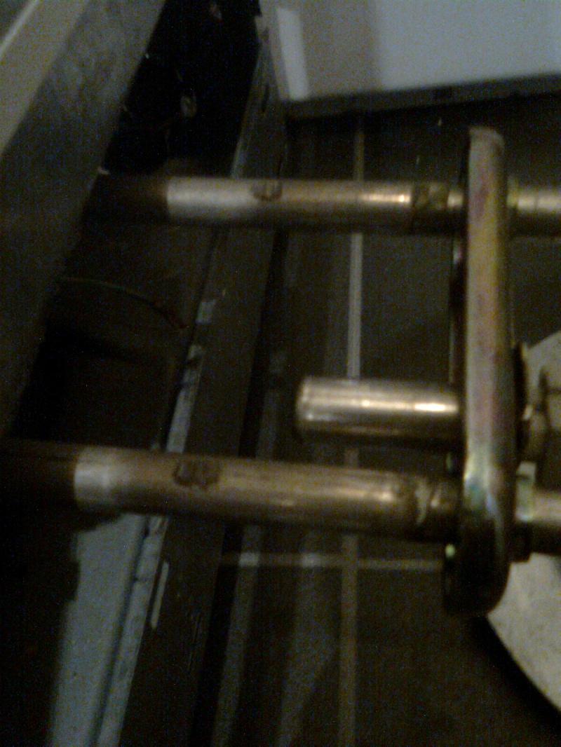

OK ended pulling the thing apart last night - very easy thanks to your clear instructions works1 (apart from a slight disagreement with my knuckles).
Having looked at the element, there appear to be two score marks which I would not think are there by design, about 2" or so in from the plate - see pic:
Would this indicate a problem with the spider? Just trying to see if something has actually caused the heater to go - not much point just replacing it if that's the case...
Yes, it is almost certainly the spider but now you have dismantled it that far it won't take much more work to get the drum out. To do this you need to remove the belt and undo the large locknut from the drum spindle then unscrew the threaded drum pulley from the spindle. Unclip the front of the tub and pull it off then tap the drum spindle with a mallet to release it from the bearings. You can then take out the drum and inspect the spider.
If I go down the route of taking the drum apart - and do have to replace the drum spider, how likely is it that I'll need to replace the bearing as well? Am I likely to get the assembly apart undamaged?
Need to make a call really - cost of element say £20, spider £30, my time (and knuckles) plus any other parts? When I get the drum apart do I need to replace a seal/gasket or anything?
We got the machine free as it was left in the house when we moved in six years ago so have had a good free run out of it...
Hmm, thoughts?
OK final update on this - dismantled as per fidom's instructions, no issues in doing it, drum spider cracked as suspected.
Costed it all up to around £70 (element, spider, tub gasket), and have decided to put it toward a new machine on the basis that the Hotpoint is about 8 years old and we've had 5-6 years lucky trouble free use from it.
