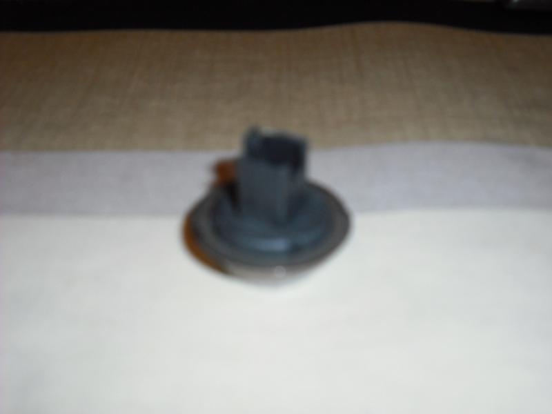

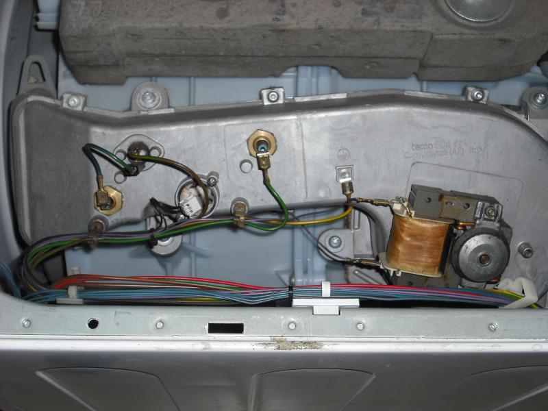

I have a Hotpoint WD440 which is not getting hot on the dry cycle. I have removed the lid and checked the heater element which has a resitance of 49.8 ohms, which I assume is ok. I am not sure what the other parts on the metal tube that the heater is attached to.
In the photos below I have tested the round thing shown which I assume is some sort of themostat. It has an open circut. However I do't know what the other things are? There are two that are held in with a bolt but there is only one wire going to them, how can I test these with a multimeter. Or is the item below the one that is faulty?
The thing in the top left of the picture also seemed to have an open circut but the wiring seemed strange

The thing on the left is a one shot stat and u can reset it with pin on the blob of paint push pin though the paint till it clicks,if it goes again then check for air flow/fan jammed etc.
Thank you very much! Reset the one shot stat and it is now working again! :D
Just out of interest what are the other things in that picture and how come the circular stat had no resistance when I tested it?
That's a thermistor it measures temp it will measure once it's got heat in the heater box.if you google thermistor it will tell you too long winded to explain it , glad it's fixed.
