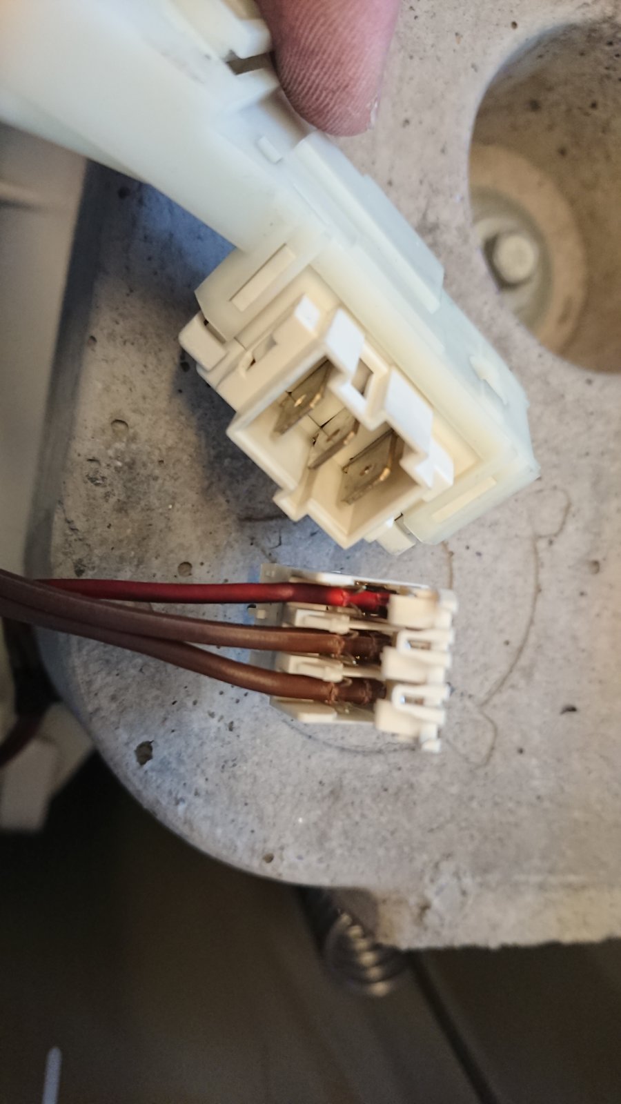

So it turns out I have one of the Hotpoint\Indesit models that likes to occasionally catch fire. I'm a bit annoyed about this as I spent good money on this machine. Thankfully mine has been working perfectly so far. I rang the hotline (on hold for 30 min) only to get a clueless operator who couldn't give me any info on when my machine would be replaced, couldn't look up any of my details from the web site and took 3 attempts to take my details again.

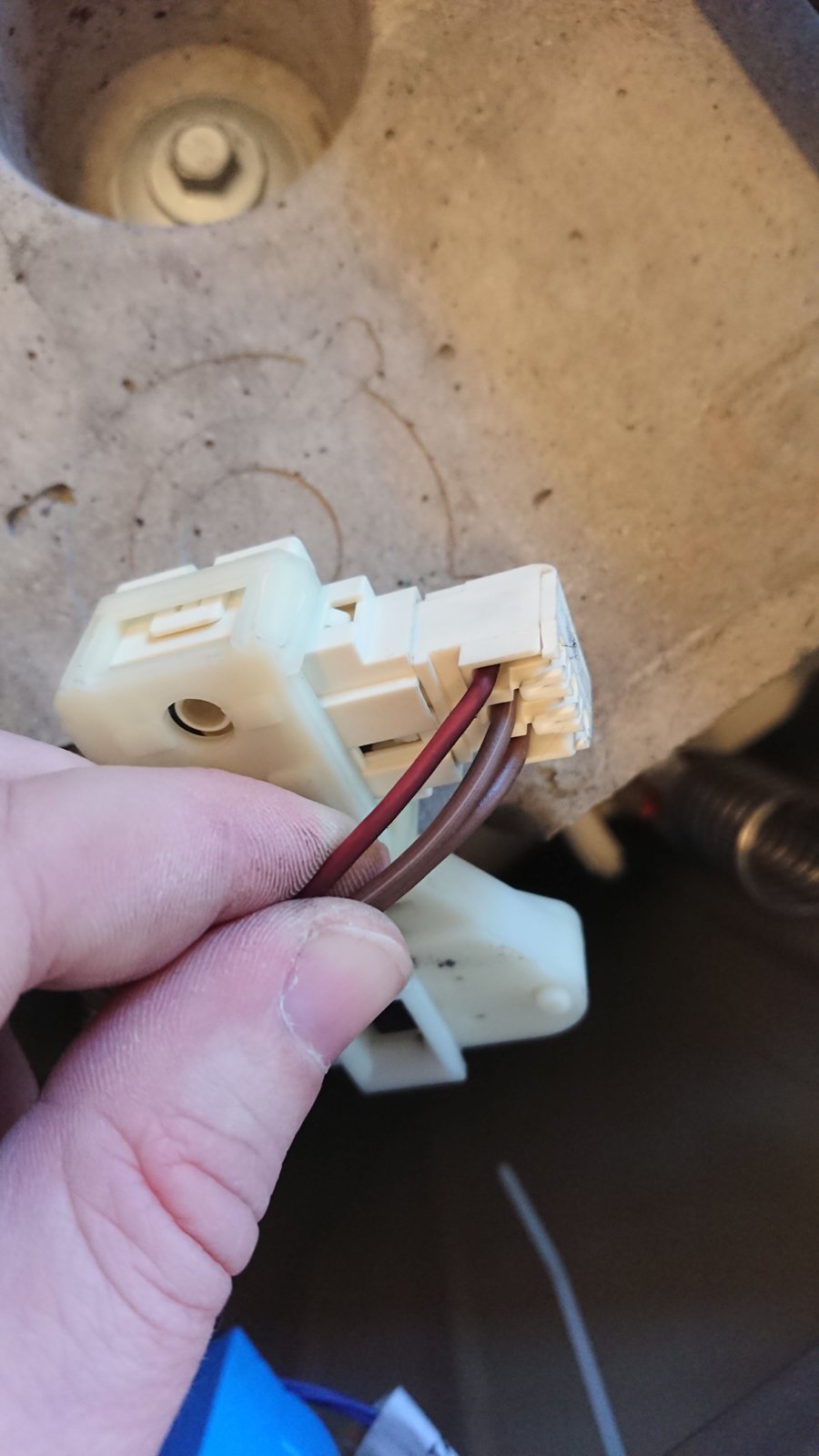

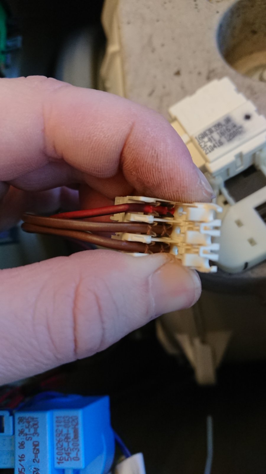

So since mine is out of warranty anyway, I popped the top off to have a look at the door lock connector that is supposed to be the cause of the problem. As you can see the door lock itself has 3 spade terminals and where the wires go into the plug connector there are 3 insulation displacement (IDC) connectors. The red wire is a smaller diameter than the other 2 which is odd, and it also seems to have soot on the outside of the wire at the plug end as some of it rubbed off on my fingers. See pics:
I appreciate that the advice from the manufacturer is "Option 1 - unplug it and don't use it, or only use it on cold wash" but as I have wife, baby & mother-in-law living here and it's going to be January at the very earliest for a repair/replacement and they have around half a million machines in the queue, I'm looking for advice!
Option 2 - Snip the IDC connector off the end and replace with 3 crimped or soldered spade connectors.
Option 3 - Keep using it, just don't have it on when we're asleep or out of the house
How dangerous do people think this connector is? What would you do?
