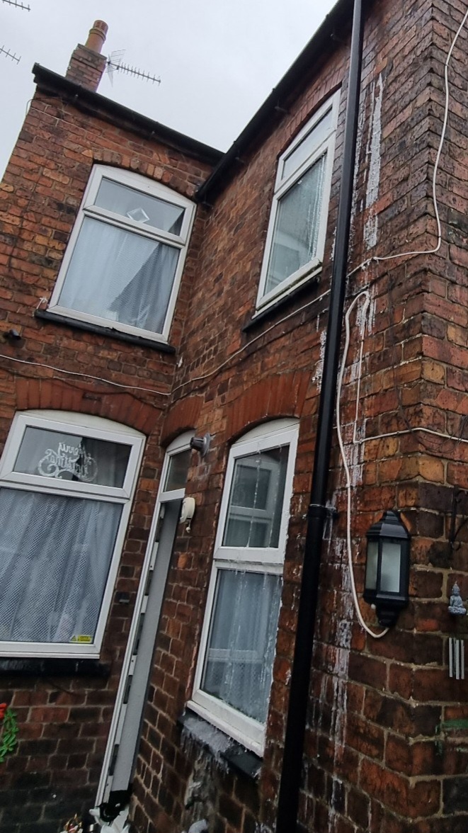

My home has recently had a burst pipe and damage as a result to the boiler that was in the kitchen below.
It was a conventional boiler with cold and hot water tanks.
I'm told by plumbers that I'd had in that the boiler can't be located back where it was as its in a space between an opening window and door, where I can't get 300mm from either side.
They had quoted therefore to relocate the boiler into another suitable room, but my home insurance whom I have a claim with are saying the relocation cost is nothing to do with them.
Is there any obligation from the insurance to comply with building regs when it's reinstalled? My plumber won't put it back where it was as it'll be unapproved by GasSafe (previous location had been there for 25+ years).
Any help or guidance mostly appreciated!

Just seen your last post- a pic of the outside wall will allow the gas-safe on here to tell you whether a flue can exist on that wall.
Flue can be seen at door height
Your right insurance is hiding behind betterment, and already said they will replace old for new but relocation is not their problem.
Looking at that wall (again I'm no expert) I'm sure a flue of some sort will be possible but fugly.

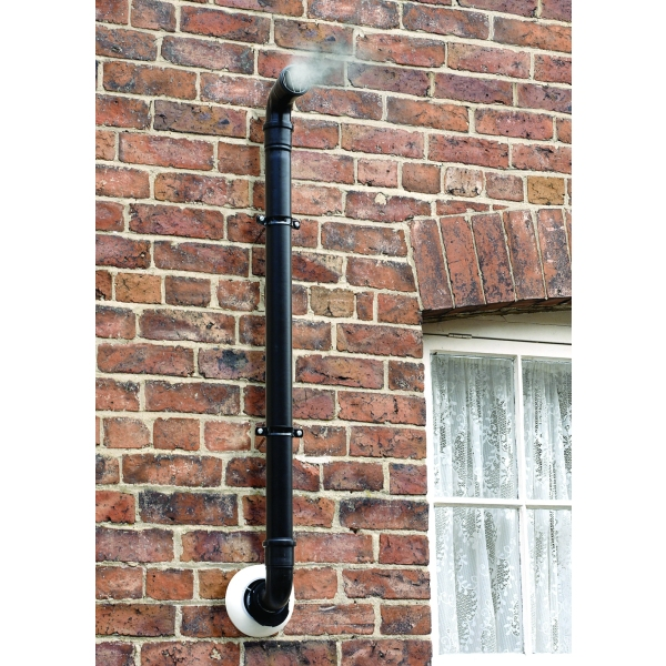

A short flue plume management kit would get the opening 300mm from all the windows and doors. 300mm is only the length of a school ruler. The plume kit goes on the outside of the building not on the inside and 300mm would be where that black wire is.
Plume management kits are not expensive sub £100.
