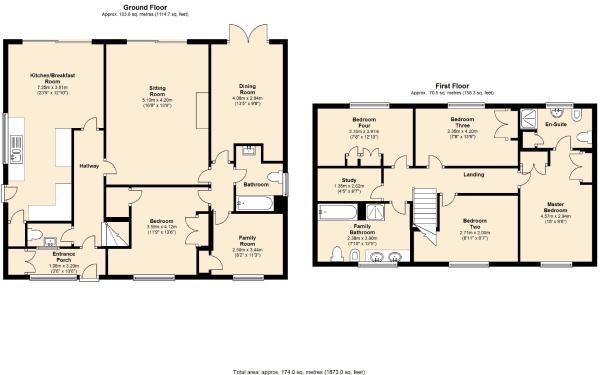

Hi all,
I have posted a few times recently. My wife and I are about to complete on an extended bungalow (extended up into the roof to 30 years ago).
We are going to be doing some extensive work over the next couple of years, including rebuilding garage and potentially re-designing the layout of the rooms - especially the kitchen and hall.
So the idea is to remove the wall where the hall run parallel with the kitchen units to create one big open space.
Another suggestion was to brick up the side door in the kitchen (but leave enough for a window) and move it further back so we can have units on all 3 walls (the larder door will also be blocked up and access via the Entrance Porch created if possible.
Another idea is to block up the front door which leads into the Entrance Porch and change the downstairs bedroom into a hall with a new front door then swing the stairs around and have an opening into the Sitting Room. The current sitting room door will be blocked up.
A new door way also created either into the old Porch or under the stairs (if there's enough headroom) to lead into the kitchen. This would hopefully make the the downstairs flow better and also centralizing the front door might make it look a bit nicer too.
Interested what others would do with this floor plan as I need some inspiration :)
Once we are in, will get pictures posted up and update as we go along.....

My first thought was to extend the wall that runs between the sitting & bedroom all the way to where the sink is, this would leave a utility room big enough for a pantry, and all the white goods and associated kitchen storage stuff. As you have a separate dining room I'd remove the kitchen/sitting room wall to make a large space that way log burner/sofa one end kitchen the other. depends if you like that sort of room. Definitely en vogue at the moment though.
syne, interesting ideas. I'm not a massive fan of one massive room so like the sitting room to be separate. Make heating each room quicker.
