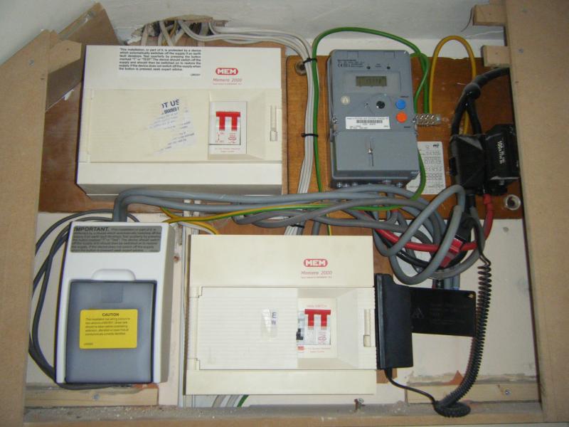

hi all,,
basically have an old house and am aware that the wiring is not to 17th edt regs...
had the kitchen movved and a sparks came in and installed a new distribution box and ring for it all which is cool but the problem is now i have a distribution box for that. another large one for lights/sockets (and old kitchen now a spare),.. and anopther for econmy 7 storage heaters...
i think the lighting ccts are ok, but the sockets are not, they are the old coloured wire system and not a ring cct....
what i want to do is rewire the lot with new distribution boxes and get signed off,,,
Questions:
1- can someone from the councel come and sign it as current? am concerned becuase i know most sparks dont want to sign other peoples work., or how would i go about achieving this?
2- where the distribution boards are its a right mess, i mean i have supply in, then a double pole 6 way connector block, 2 large boards a further kitchen board and the meter,,, can all these go onto a single larger distribution box? or what would be the best advice here?
3- can someone point out the type is distribution box (s) required... storage heaters, sockets, lights. also exact type and grade of wires.
4- want to provide power to the garage, is 10mm armouded cable dug into ground ok then to a breaker box in garage ok,... also where exactly do i take this from in the house??
//www.diynot.com/wiki/electrics:part-p
Although to be honest you don't yet have anywhere near enough knowledge to be able to ensure that you comply with P1.
Yes.
To get an electrician.
See the questions above - if you want to take on this job then you have to make those decisions, and you have to be able to make them on the basis of a sound underpinning of knowledge and genuine understanding.
Rewiring-by-numbers is an extraordinarily bad idea.

look,,,,, i understand your comments all i want to do realistically is remove old socket wiring and install 2 rings,, one up stairs and one down...
and tidy up what you see in the picture,,,
But you will not be able to sell the house if you do the rewiring work yourself and it does not comply and/or does not have all of the required paperwork.
I suggest that you talk to a registered electrician and offer to do much of the grunt work for him. You will then be working as his apprentice under his guidance. He can then do the final fix and testing. Possibly then he will agree to sign the installation off and do the necessary notification.

atm i have 3 boxes, 2 of which are half empty as things have been removed. so i thought, ok, could i re-do the sockets with the correct cable and correct layout (ring) to make it current at the same time tidy the mess i have with all those boxes.
he told me nothing is dangerous or out of the ordinary,,, just i am worried if i come to sell will this be a big factor??

Sadly, not only was your electrician expensive and unable to install wiring without ruining the walls, he was generally incompetent.
There is nothing wrong with radial circuits, not now, and not ever. In some ways they are better than rings.
There is no need to remove the old circuits and replace them just because they are radials.
There is no need to replace cables just because they are the old colours.
There's nothing wrong with one downstairs socket being on a different circuit (arguably it's a good thing) provided the CU is properly labelled.
There is no need to bring any existing installation up to the current regulations per se. (Although any new work should be to the 17th.)
You won't be able to present an electrician with a part-completed rewire and have him sign it off - if you do want to do some of the grunt work then do what TTC said - find your electrician and agree with him first what he is happy for you to do.
As ever, personal recommendations are always the best way to find a reputable tradesman, but if you're having to go ahead without much in the way of those, or references, don't put any store by registration itself - sadly it is possible to become registered with woefully inadequate qualifications and zero practical experience. You don't have to spend long here to see people cropping up who are registered and "qualified", but who are clearly seriously incompetent in reality and who should not be charging for their services.
It's your money and you have every right to ask prospective tradesmen what their qualifications are. Just being listed here is not a good enough guide. No genuinely experienced electrician, with the "full set" of C&G qualifications will mind you asking - in fact he will wish that everyone was like you.
I feel sorry for people who have been misled by training organisations and (shamefully) the Competent Person scheme organisers into thinking that a 5-day training course, a couple of trivial examples of their work and some basic understanding of how to use test equipment will make them an electrician, but not sorry enough to agree with them trying to sell their services to Joe Public.

Was this a repo house? ("do not use" stickers)
Just wondered, the device hanging off the meter tail - is this a transmitter for an energy meter?
no,,, we got that sent through from our supplier,,,
its one of those monitor things that tells you how much your using an cost etc,..
my main concern was really not that the house was going to blow up or anything like that.. more the fact if i was to sell it would be a major issue... ???? would it be?
Nope.
The mess under the stairs is not ideal but in reality is not as bad as it first appears, and a periodic inspection at the time would show that the wiring was sound.

but if you enlarge that picture i posted on here,,, it makes for a really unpleasent sight,
It could be worse:
:D
and like i say the 2 larger boxes half of each are empty as old things were removed etc..
Why did the electrician you had install an additional CU if the others had space in them? Is that the one to the bottom left? What circuits are in it? If you can relocate them to an existing CU then you could maybe remove the RCD and stick a 50A breaker in there to supply the garage.
Are you keeping the storage heaters, and the off-peak supply? If so you'll need to keep 2 CUs anyway.
If not then having 2 makes it easy to split the installation across 2 RCDs, and all the spare ways can be used for new circuits as needs change. It's not as if you've got rubbish CUs either. Is the non-storage heater one a split-load, i.e. does it have an RCD part way along?
A bit of work to dress the cables better (particularly the tails), maybe some trunking to enclose the circuit cables and cover up that ragged hole in the ceiling and it'll look just fine.

whilst am here asking silly questions,., is there any reason you may be able to advise why all upsatirs sockets are singles??? there is like 3 rooms upstairs and each room has 4 single sockets each ????
None that I can think of - feel free to replace then with twins.
