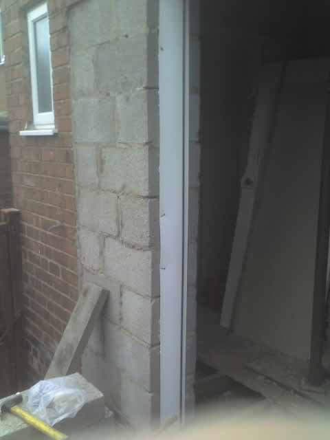

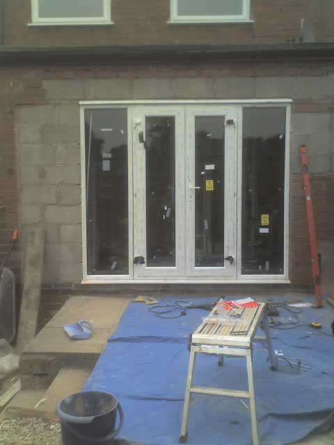

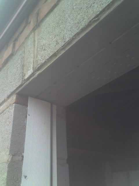

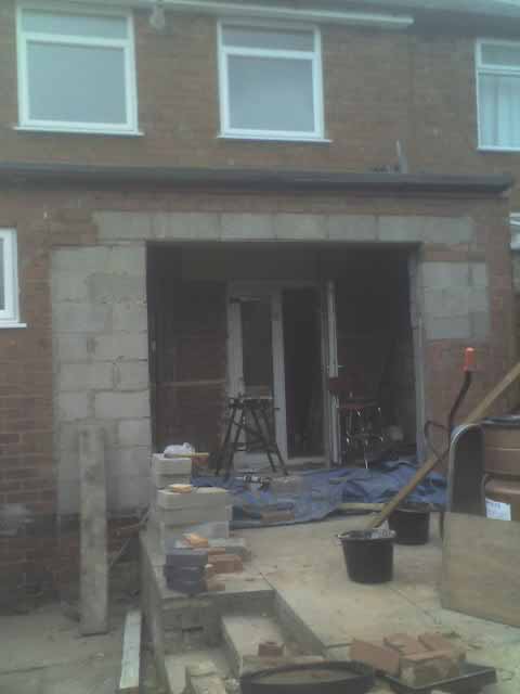

Picture 1
Picture 2
Picture 3
Picture 4
Picture 1 gives an overall idea of my little project. The blocks on the right as you look at it were a window, the brickwork below is original.
Picture 2 shows the cavity closer in place. Just noticed that the camera angle makes it look like the wall is about to fall down!
Picture 3 shows the lintel in all its magnificence. This will be filed for when the house is sold, as proof positive of its existence.

I've requested one final photo from those awfully nice admin guys, just to show the finished article. The last thing to happen now will be the rendering and pebble-dashing, but since I'm not going to do that myself it seems a cheat to claim the credit!
