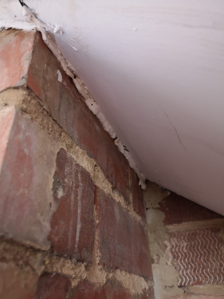

Hi
I am going through the process of selling my house and my buyer after putting in his offer 3 months later decided to have a home survey performed. And one of the items highlighted was high damp readings in the internal roof void indicating water ingress from the chimney stack area. I converted the attic around 5 years ago into a small gaming area for my son and I insulated the roof with insulation board and applied plasterboard to cover the roof. Due to the area being used often I have never seen any damp areas around the stack. As the survey was performed the day of the last storm I would have thought if there was a problem then it would be clearly visible. I think that the problem is with the testing equipment that is used is not accurate and picking up salts etc in the brick work. I had new flashing around the chimney when we moved in 25 years ago as it was leaking. The survey report is asking for details of the extent of the works done in the attic conversion. I am unsure how to proceed regarding the supposed damp problem and how much detail to go into regarding the conversion of the attic. I gather any information I give will only go to the solicitor and client

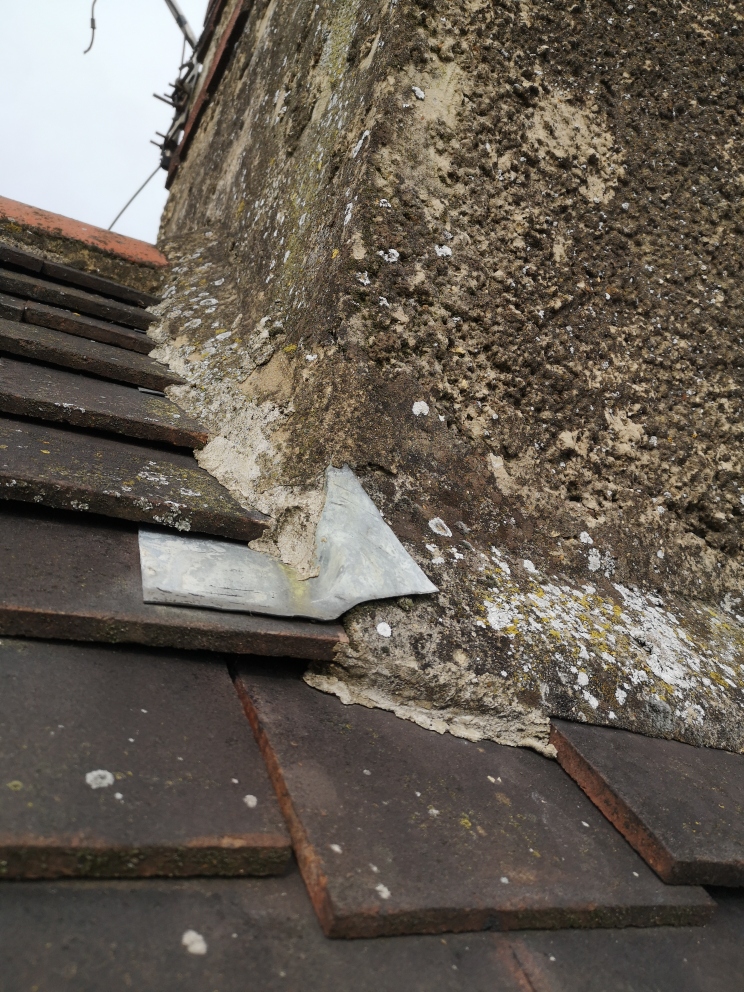

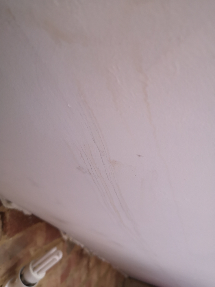

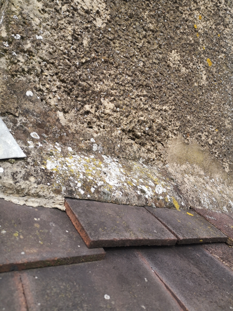

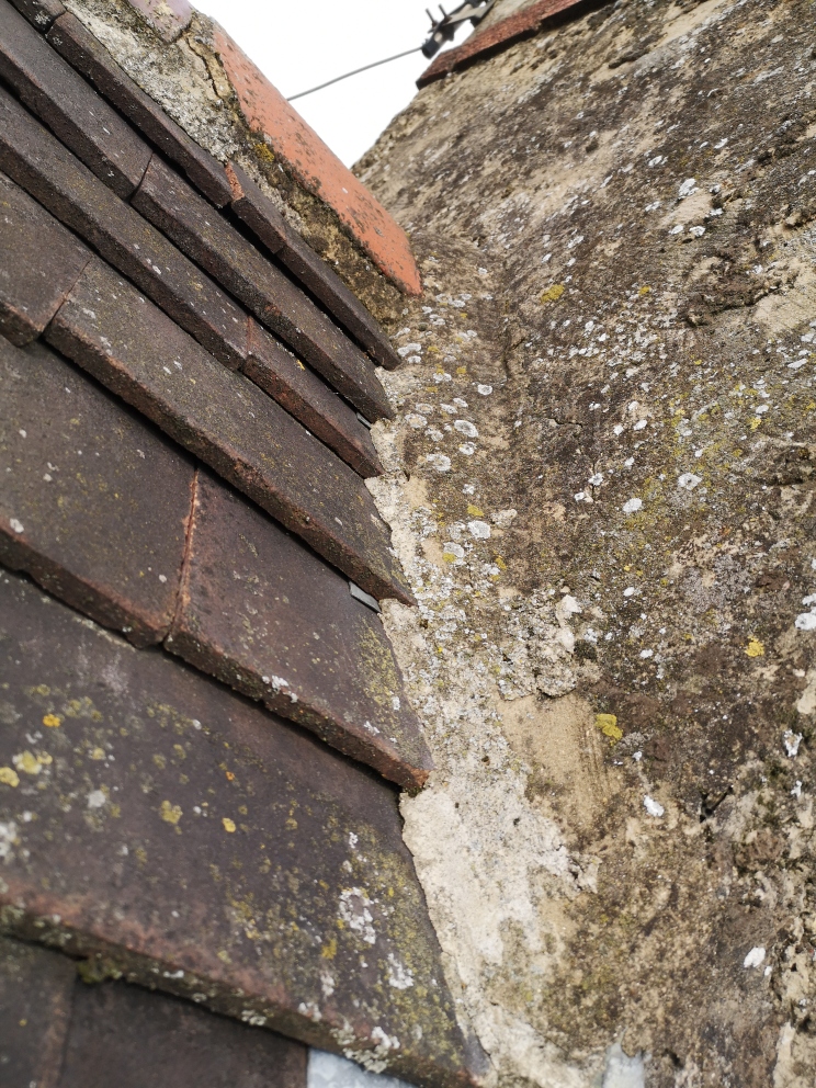

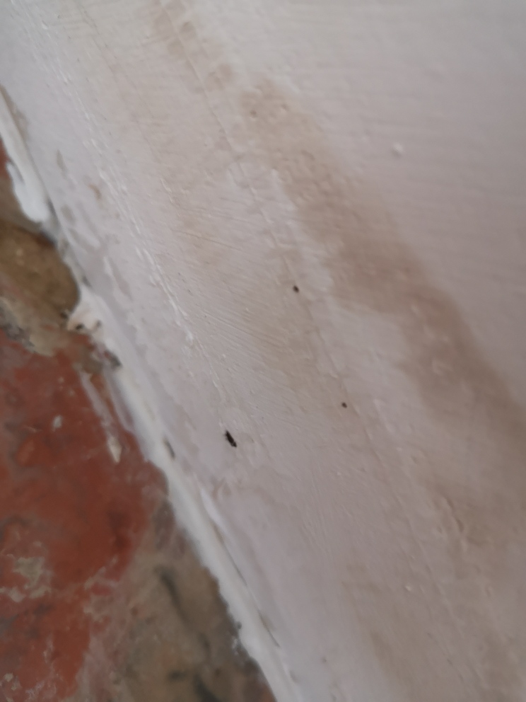

Thanks for the help. I have put my camera out of the window and taken some pics. Along with some internal ones of the stack and roof area. I cannot feel any damp but the plaster is showing through the paint on an area down the roof area that I have taken pictures off. A couple of tiles look a uneven but all look like they are still okay. The pic of the internal roof space with the light bulb showing looks like something may have run at some point but feels dry.

Pic 507 shows maybe failing dashed render. And sand and cement fillets used instead of code 4 or code 5 lead flashing. There appears to be a soaker every other course of tile but no sign of cover flashing.
The soaker at the base is wrongly fitted possibly allowing moisture entry.
Pic 676 The render again looks to be in a poor way - a previous patch repair can be seen.
A S&C fillet has been used.
The tiles are uneven and will possibly allow moisture to enter.
Pic 199 shows signs of water leaks on the chimney breast.

Pic 207 shows more plasterboard water damage.
Conclusion: you have active leaking from failed flashing, tiles & render - there might be further damage occurring from a failed stack crown (moisture down the flues)?
