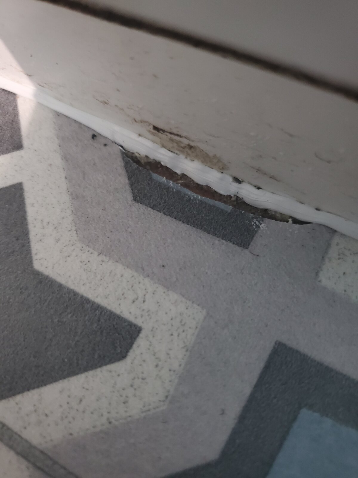

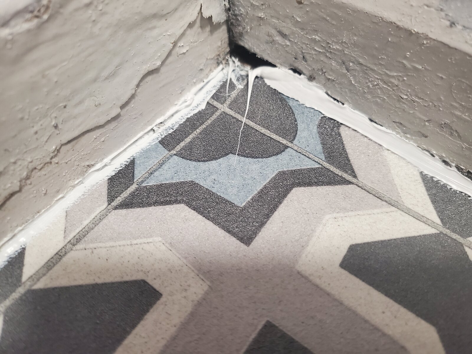

2 days ago I had new vinyl floor fitted. There's bubbles near the edges, and a lot of the edges are like in the photos below.
I only noticed how bad it was when a painter came round today to sort the skirting boards out, and said outright the installation is shocking and he can't do his work (which cost me £50 to pay off a very unhappy painter....)

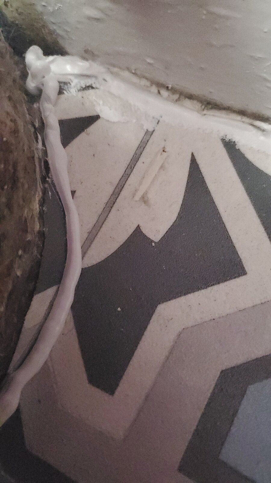

I thought initially maybe just a mistake but the more I look at the work...the more I realise how carelessly it was installed. Please look at the picture of the base of the toilet especially....he wasn't even looking at the installation.
The manager has contacted me, admitted its shocking and wants to rectify it...the problem is that this company installed it this bad in the first place...utter disrespect and takes the p*** in my opinion. I personally now don't think I could trust them in my house to even fix it.
You can see in one of the photos....the vinyls been cut too short and theres a gap in the floor....how is that supposed to be recitfied!? More caulk?!
Is it just me or is the work that bad....also, what should be done? Is it fair to demand a full refund and just have them rip it all up and go elsewhere?

It's an absolute disgrace and I'd ask for a full refund plus a bit extra for having to send the painter away.
What I would recommend is to get the skirtings sorted before re-doing the flooring. Trying to cut flooring can be difficult at the best of times but trying to cut an exact trim to damaged surrounds is nigh impossible.
Can you explain/take a long shot photo of the first picture? I'm curious as to where you would get such a big gap and hope it would flatten out to close up.
I have to agree. If the skirtings area sanded, filled and primed, at least the next floor fitter will have a better shot at doing a good job

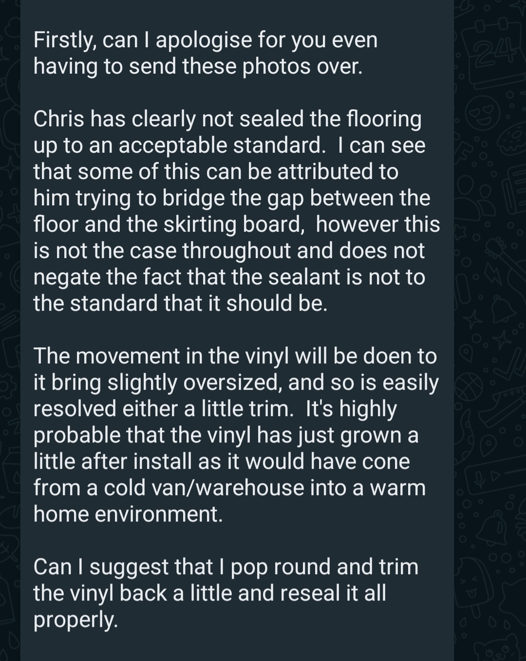

Thank you all for confirming that the work is actually shocking.... this is the response I received from the boss.
What move should I make here?

Shocking that. Fitter should have scraped the bottom of the skirting and cut the vinyl in flat if the skirtings are bad.
a thin smooth bit of silicone then.
Trimming any edges will not repair the gap in the middle section.
as I said in my earlier post. The skirtings need to be done first, (either replaced, (preferable), or repaired to a standard that gives a nice clean edge flush to the floor), they don't need to be primed and painted but it will save getting any on the NEW lino when it is laid properly.
The NEW lino does need to be acclimatised to the room it is going in, so the manager does have a point about it being moved from a cold place without being allowed to settle. If they delivered it they should have brought it at least the day before, but preferably 2-3 days before and leave it loosely rolled without any ties/tapes around it.
Tell him you are prepared to accept a completely new installation, (new flooring and laid by an experienced fitter), after you have the skirtings attended to first, but you retain the right to reject it with a full refund if it isn't done to an acceptable standard.

Not good but I would just fit lengths of 1/4 round beading to cover the gaps. Just tack it to the skirting board.

The skirting is being replaced and they will be redoing the floor. Just waiting for an update
