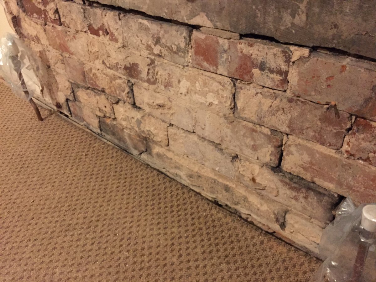

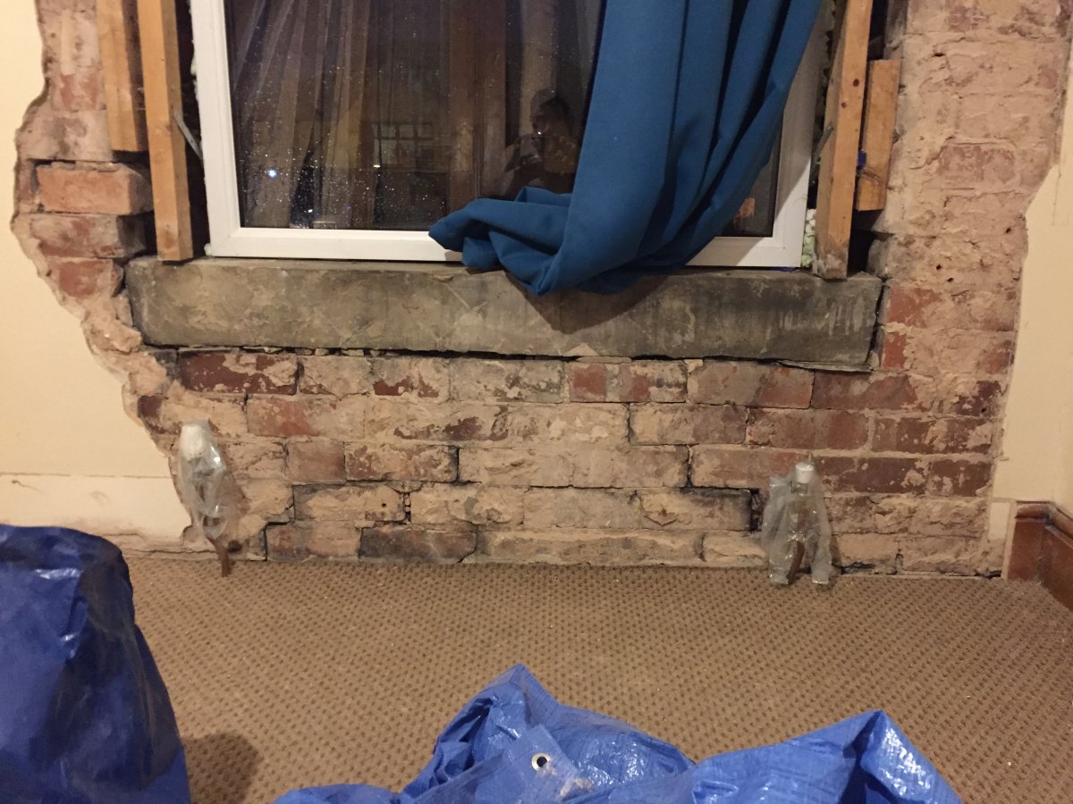

I have a bunch of loose bricks under an upstairs window which I have uploaded pictures of.
When taped, a big section of them moves as one, I've outlined this in blue in one of the pictures.
Should I remove the bricks and relay them, or just repoint around them?
I think that what you've exposed is an old double hung window opening that was badly filled in when the new frame was badly fitted.
The secure fixing of the frame should be your priority.
Do you have another exit window in that bedroom?
On the face of it, you could gradually remove a couple of bricks at a time from the same side, and then re-lay them.
Take care not to disturb the stone sill.
But whats happening on the outside wall face, is it sound? Can you post photos?

What drew me to the issue was we had a new window fitted, they had to remove the plaster around the window to remove the old PVC frame, exposing those 2x4's. The plaster below the window was blown which I removed to re-plaster and found the bricks.
No there is no other window in that bedroom.
I think you're right that it originally was a double hung window, how should it have been filled?
The outside wall face is fine, the stone sill rests on the outside and inside wall.
Whoever fixed that frame was a clown. Its insecure therefore unsafe.
Typically, double hung openings are bricked up to provide the correct width dimensions for a modern frame.
PVC frames, for instance, can then be plugged & screwed into the brickwork.

The outside is sealed with foam and sealant. You're right that I should get them refitted, I suppose the window isn't very safe.
In terms of the bricks, would I have to remove each one and relay, as a pose to just repointing? The reason I ask is because the bricks in the middle of the blue lines are still firmly attached together, they move as one, and have unattached as one from the rest of the wall, so I thought it might be an option to repoint around the blue lines.
Do it properly, there's enough bodging already.
As long as the sill remains stable you will have no trouble pulling a few bricks from the centre - pull them first. Clean up, brick up and leave them for 48hrs and then do the others.

Really appreciate all the advice, I've discovered this whole house has been bodged over the years.
Am I okay to use cement mortar or should I use lime? And when you say centre, do you mean the centre in between the blue lines?
There is 1 other installed this way, they all open fully though.
Any mortar.
Yes.

In your opinions, what's the best way to remove the centre bricks without breaking them, as they're firmly attached to the surrounding ones?
Should I just remove all the bricks in between the blue lines at once - as they're completely separated from the sill.
