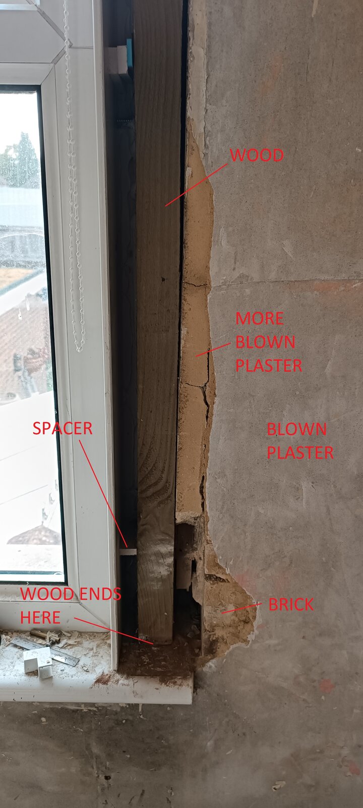

Hi All,
We're redoing a room for the rapidly approaching birth of our son. A lot of the plaster is blown and we will either replaster or batten and board (I would prefer this way)
This area has me baffled, though. As you can see in the image, all the plaster is blown, including the thick plaster between the wood and the brick. How would I go about replacing/repairing that thick plaster? Also, I'm not sure what the wood is doing there, because it ends on top of the bottom sill (which also goes under the window, not up to it)
Any advice is much appreciated.
Neal
The timber was fitted to create a fixing point for the window as the house possibly had box sash windows originally hence the deep reveals. I would build out the timber to sit flush with the face of the brickwork and then use expanding foam, applied steadily so as not to bulge the pvc reveal liner, to fill the cavity in at both sides of the timber and then trim it flush when set. You can then dot and dab new plasterboard onto the brickwork and fix to the timber face creating a square edge and either skim the boards or fill and paint/paper etc...
Thanks for your reply. Any particular expanding foam that's good for this job?
All pretty much the same to be honest, i would remove any of the loose thicker plaster near the timber too once you break off the blown section.

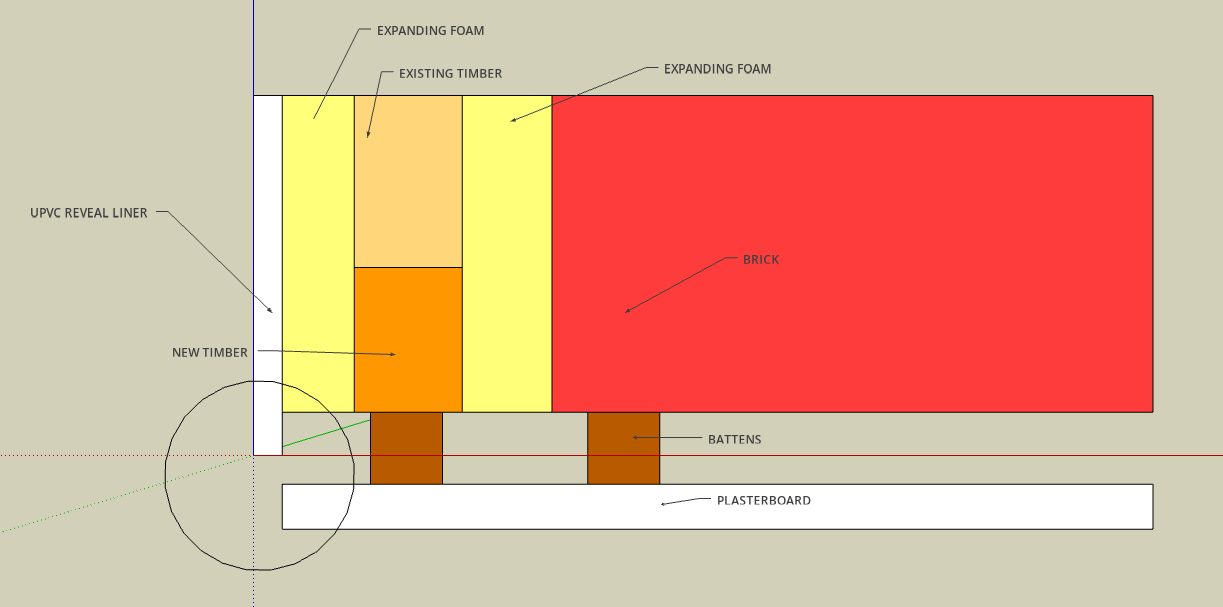

@DAZB If I was using batten and board (I want to add some insulation) , it would obviously stick out further than if I were dot and dabbing. How would you approach the upvc reveal liner then? The plasterboard might stick out further than the liner (which is fixed in place by the window screws)
You could form a corner with the board, angle bead it then skim the return up to the liner
Use expanding foam. If you press lightly, the foam comes out slow, it stays relatively thick and minimal expansion, and sets quicker if you spray it with water.
Build up in a few layers until it gets the shape just below the surface. Then trim any excess, as need be and finish with plaster or filler.
Sorry mate, what do you mean by return?

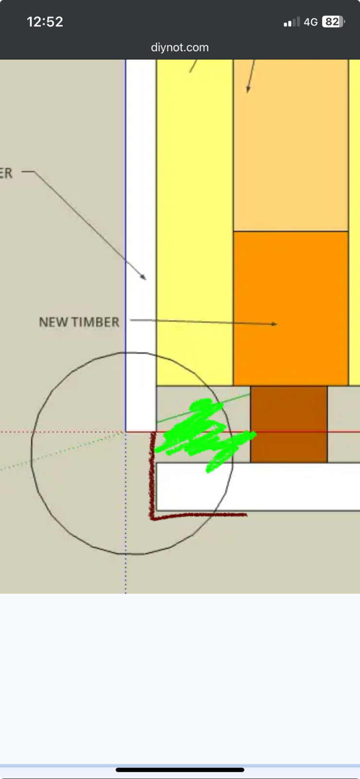

This is what I've got so far. The circled area is the problem...
Ah I see what you mean. Then just skim up to the end of the reveal liner. Many thanks!
