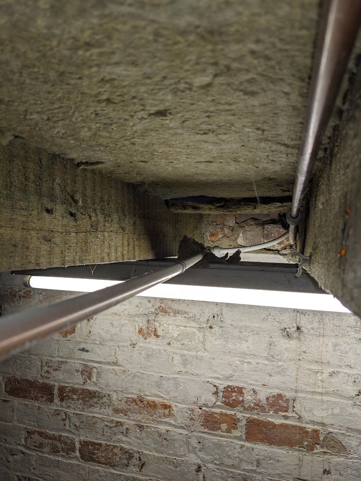

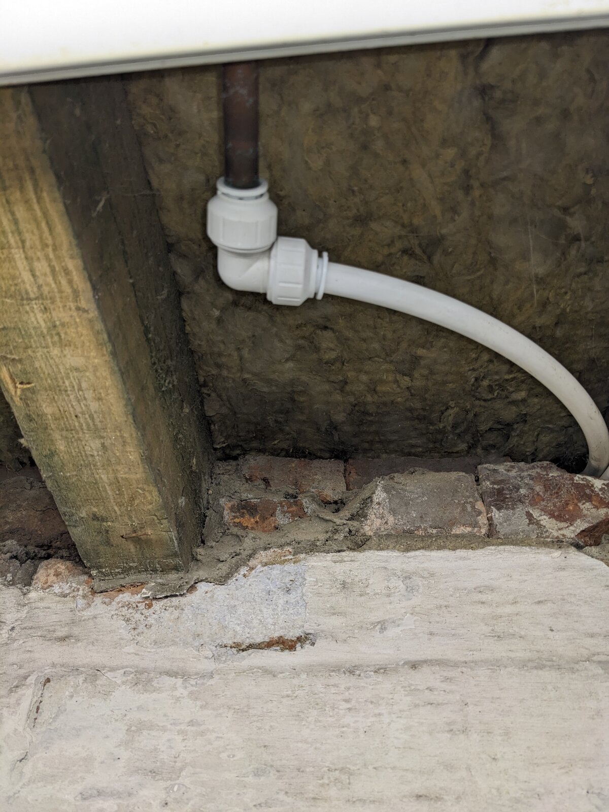

Hi there. Long time lurker, first time poster so apologies if this breaks any rules. In my cellar, this pipe (I assume for heating?) is away from the joist. The flexible bit of piping (white) seems like it's cut too large and is pushing the pipe away from the joist. As such, I cannot push the pipe against the joist without force and most likely breaking it. It should run parallel with the second pipe that you can see already attached....One thought I had was to try and rotate the angle of the connector in some way to try and put some relief on the white pipe to see if that help? Another idea was to somehow detach the white connector and cut some away before reattaching? Literally not got a clue though and never done anything like this...Any advice greatly appreciated!

That's a 15mm speedfit elbow white pipe could be speedfit but who knows?
If you really want to move it and it part of heating system it's drain it down and alter .
Maybe another elbow and short section of new tube?
Erm, maybe just cut the pipe to the correct size and then use a straight coupler to run it straight. Whatever it is supplying will need drained down first and the plastic cut to size.

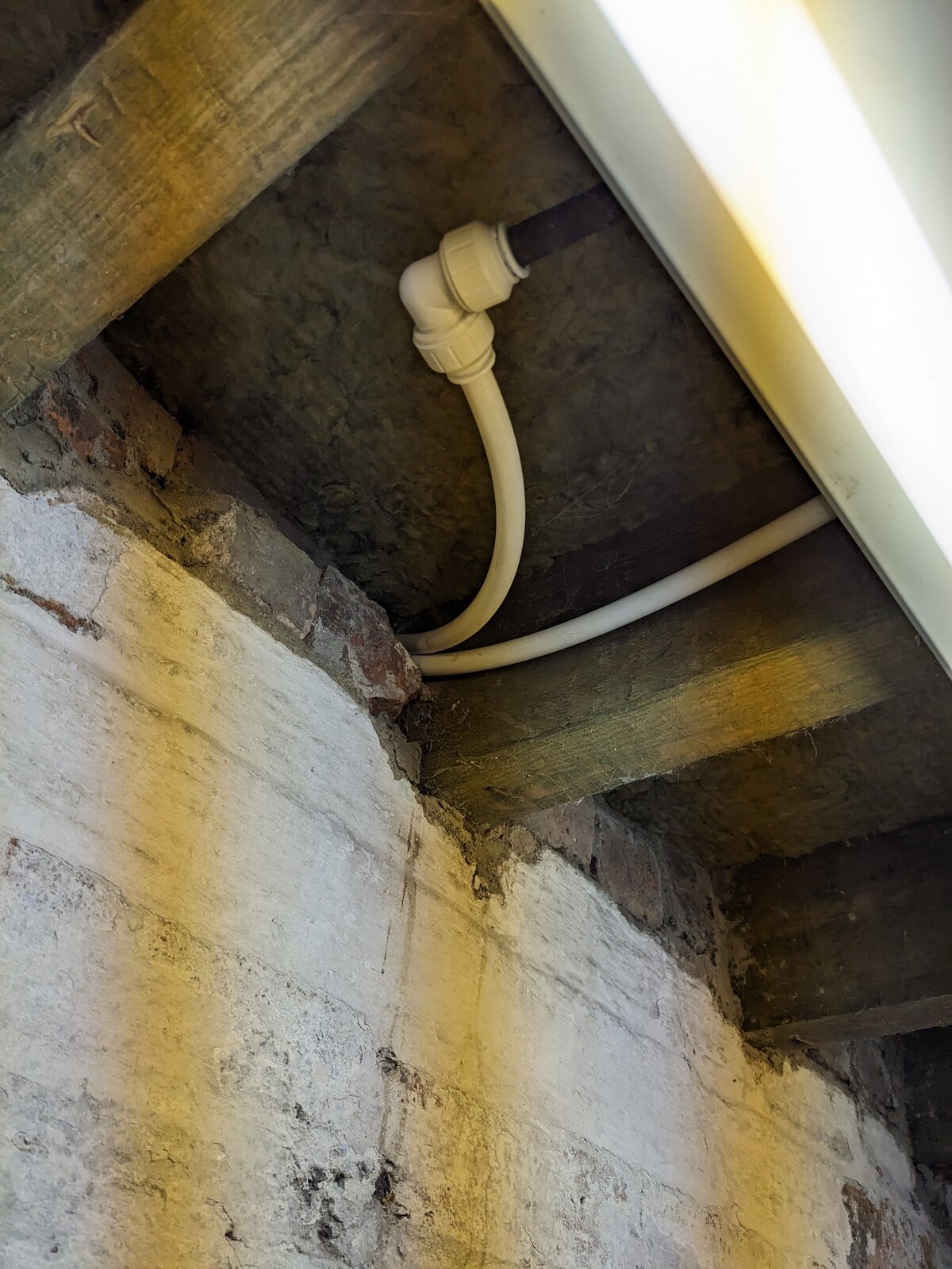

Well at the moment it's just resting atop a light fitting, propped up by some loose insulation...Not my doing, but doesn't seem wise? Thanks for the advice - not too sure what a speedfit is I'm afraid!

The added time will be in what it's connected to an what needs to happen to allow the pipe to be emptied and disconnected, cut to size and re-made and then re-pressurised and tested. The actual work of cutting and re-adjusting the pipe is 5mins.
Make sure they put a wooden support for the copper pipe in. Spanning the two joist to prevent it flopping down again.
