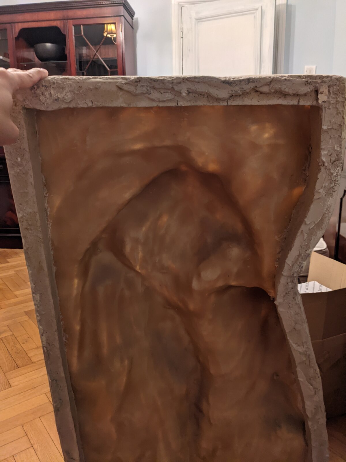

I want to display a heavy marble resin sculpture on my wall, but I'm struggling to figure out the safest way to 'hang' it.
It weighs about 20kg, and - unfortunately - I can't drill into it or otherwise attach any other kind of fixing.
The picture shows the reverse of the piece; you can see the 'lip' at the top. The lip is about 40mm deep.
I was planning to simply hang the piece, by placing this lip on a wall-anchored batten of similar dimensions. (And perhaps adding some kind of very mild adhesive to ensure it doesn't move off the batten).
Any other suggestions!?
Thanks!!

Hi,
I don't know how sensible this is, but could you wedge and epoxy a French cleat onto the back?
Final option is to create a shelf to lean it on, rather than hoping it doesn't fall apart from it's own weight!
Bond a board on to the back and use that to mount hanging cleats.
You will support all of it and provide a large area for bonding doing it this way.
The inside face of the reverse side is an irregular shape (as it's from a mould), so I could only adhere a board to the inside sides which are straight. Would this be enough?

Fit timber baton too wall and hang sculpture on it, double sided foam tape will prevent any movement .
Foam tape is a great idea, thanks.
I'm now heading towards the shelf idea, simply because I'm worried the weight of it will tear the top off, if it's 'hanging' off something
Foam tape is really good idea though, if I can be more assured re coherency of the piece itself

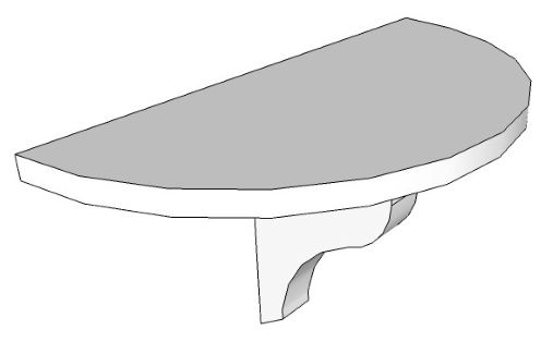

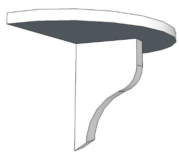

I might consider going all traditional and making a corbelled wall shelf to sit it on in order to carry the weight, then using an epoxy foam tape to stick it to the wall behind and the top of the shelf to prevent it getting accidentally dislodged
Two bits of planed wood and not that difficult to form (admittedly a lot earier with a jigsaw to make the templates and a router to shape the edges) and if screwed and glued together it wouldn't matter if the screws were visible as they'd be beneath the piece when it was mounted
