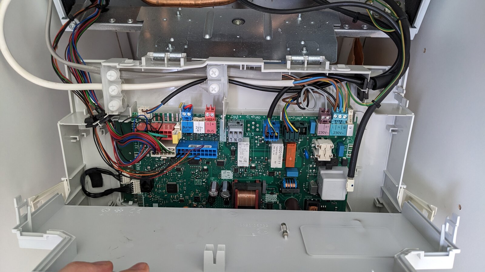

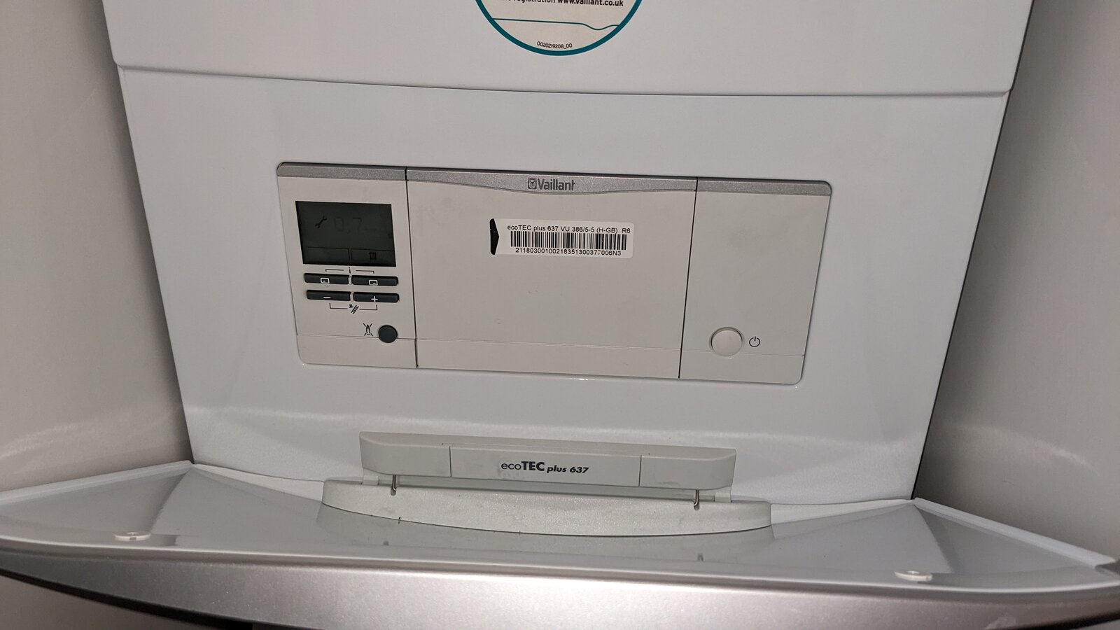

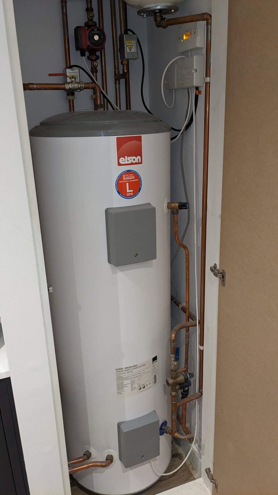

New house, new boiler! The set-up is:
- Vaillant Ecotec Plus 637, system boiler single plan
- Tank elson zircon 250zi, no immersion
- Programmer Drayton LP722 (dual channel, heating and hot water)

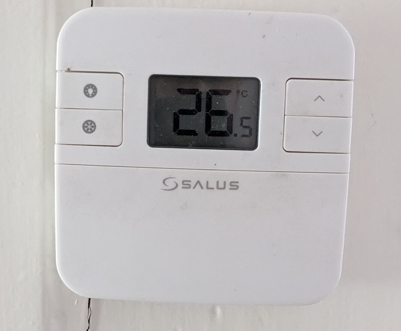

- A Salus controller, not too sure what does is used for.
As you can see from the PCB photo, the eBus port are not connected. I am concerned that this is a simple on/off set-up with no modulation and poor efficiency. On top of this I cannot control the hot water temp on the boiler, I'm concerned this would heat at maximum temp unecessarily.

Where is your room thermostat?

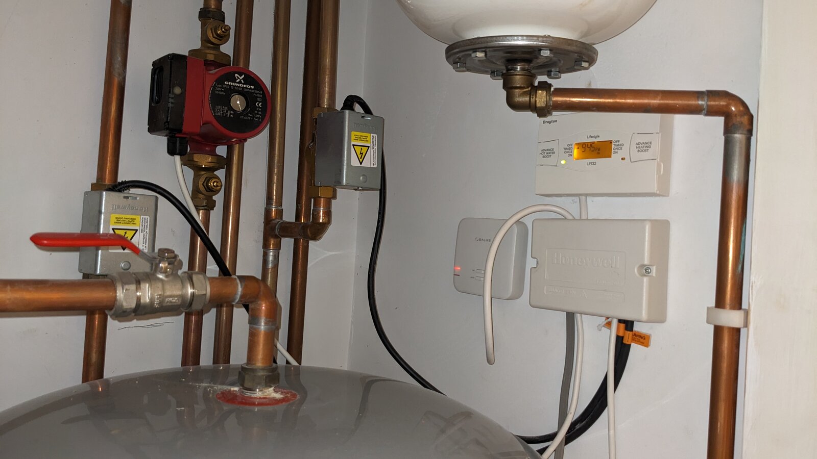

Why are your pipes uninsulated?
Do you mean the cylinder?
As above - Vaillant ebus controller (thermostat). Grey cable should be heat resistant flex and you shouldn’t be removing the cover on that boiler. Also as above, insulate the pipes.
insulate dhw pipes yes but not CH pipes unless they go outside the heated envelope of the building
Assuming you want to deliver heat at random amounts and places, including unused rooms, storage areas, and voids under floors, instead of specifically into occupied rooms until they reach your desired temperature
the heat isnt wasted as it heats your house, ive tried micro zoning it isnt worth it and actually costs more for me than letting the weather comp do its thing and heat 247
and voids under the floor i said to insulate those as i clearly said(unless they go outside the heated envelope of the building
and under a suspended ground floor is that, under a suspended first floor its effectively ufh
in a new build you are going to have sod all thermal mass internally so zoning hardly works as the heat will always migrate to where its colder
and unless your actually recommending them to rip all their walls and floors up to lag the pipes what are you hoping to achieve?
So you've revised it to "don't insulate the ones you can't reach"
Boiler size:
Thanks for pointing that out! It's a 2000sqft terraced, 5 beds 3 baths and there were 5 renters before. What is the implication of having 37 kw? Is there a risk of overconsuming energy? If that's the case I would definitely consider downsizing the boiler.
Thermostat:
Currently there is this in the corridor:
It's not connected to ebus so I'm concerned this is not efficient at all and just goes on (max power?!) / off..
You mention Vaillant SensoComfort being better but better than what? How does it compare to their vSmart controller (which I think is also ebus and can be controlled remotely via internet which we used in our previous place before when we had a Tado).
insulation:
Will get this sorted ASAP however sadly I can only insulate those I have access to. I fear the part underfloor between the boiler and the tank and the parts going uptsairs inside the wall are not insulated either :(

Over sizing means the boiler will short cycle - turn on and off with too much frequency, even when it modulates down to minimum. Such behaviour will cause extra wear on the boiler and waste gas.

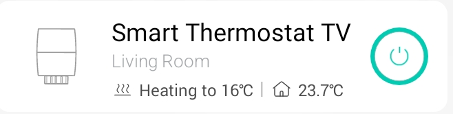

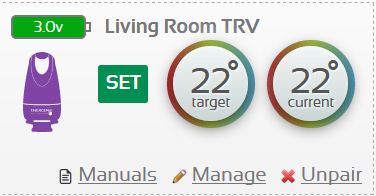

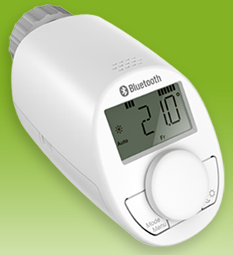

My TRV shows 1694380755126.pngTRV_report.jpg depending on which make, in both cases I have target and current, so you adjust the lock shield valve so in winter current does not exceed target, an energenie one (second) got smashed, and has been replaced with a TPlink Kasa one, but as yet not used over a winter, so no idea how good, both need hubs, and both connect to the wifi. Neither connect to the Nest Gen 3 thermostat, the cheaper eQ-3 61dmtMm13BL.jpg used blue tooth, will only connect to one phone at a time, but does not need hub, and can be set without the phone, the Kasa can also be manually set, but the energenie you need a PC or Phone and hub to set them. Once the lock shield is set the eQ-3 works well, but the price has jumped since we left EU, were £15 in 2019 now over £20 for bluetooth version, although non bluetooth seen at £18:50 does not sound much, but I have 14 TRV's 9 electronic.
