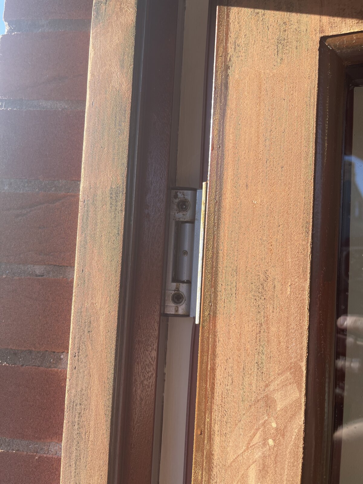

Hey all,
Decided to sand and paint my external doors and would like to remove one at a time to do this. Any idea how I can release the door from these hinges?

Wedge door so it don't drop and unscrew hinges.
Last screw to remove will be the top one.
That's my guess as not my area.
See if that gets confirmed.
More pictures may help
Would have been better posted in doors and windows section. Remove the tiny grub screw, flick off the top and bottom black caps and with a punch or a screwdriver knock the pin upwards

Thanks for the advice. I ended up just painting it in situ.
