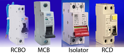

Some times one can mix up the MCB and RCBO
to the outside only the trip button shows what it is. In domestic over loaded circuits are rare, it did happen a lot in the 90's when people started fitting little tungsten spot lights in the ceiling and exceed the 6 amp rating of the MCB but you have not actually said what stops working. If everything works why reset a trip, it may be a redundant circuit.
