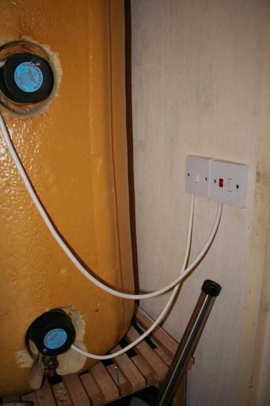

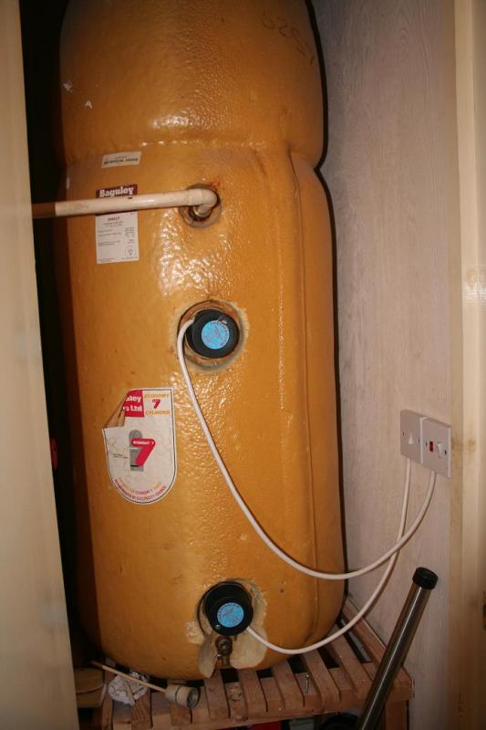

My husband and I recently moved into our flat which has an Economy 7 Cylinder for our hot water. The make is J. Baguley & Sons Ltd. It is a Direct Combination Unit 1400mm x 450mm.
There does not appear to be any timer at all, the only visible controls are two switches that are not labeled. One switch is connected to the top part of the cylinder while the other to the bottom. We have no idea how to operate this and require some assistance as we're getting tired of cold water. Take a look at these photos as an example:
I understand that the most economical time to switch it on is between 12:00AM and 7:30AM. Does this mean that we should set our alarm for midnight to turn the tank on or should we always keep the switches both on and the machine will do the work for us? Any information on how to operate this machine would be most beneficial!

it will only be economical if your electric is Economy 7.
if not it will cost the same to heat day/night.
if you switch the bottom one on when you go to bed you'll have a full tank of hot water for the whole day.
you can buy timer to use on these save keep switching on/off.

yes switch bottom one off and if you use alot of your hot water use the top to boost the heat again for say a hot bath.
but in your case if your not on economy 7 electric it won't be any cheaper what ever you use top or bottom.
you can always ask your elecy company to put you on ec7 then it will be cheaper to heat your water at night and just boost it in the day time.
The bottom element is designed to heat the whole cylinder at the cheap rate to last you all day, but if you do run out of hot water, the top element is to there to top it up when cheaper electricity is not available.
You may find (especially if you also have storage heaters in the property) that the bottom element is automatically operated during the off peak rate. The fact that the switch doesn't have a light on suggests to me that this is likely. However, it's easy to find out if it is.
1. Check your meter to see if it has two readings. Normal and Low, (or you might have two separate meters) If you just have one reading you're not on the economy tariff. Assuming you do have two, then, make sure that both elements are switched off and the water in the cylinder is cool, then:
2. Check that the normal (day) reading is selected on your meter, usually it has an arrow pointing to it. Get someone to turn on the bottom immersion only and see if the meter speeds up. If it does, your immersion is not on the economy tariff. If it doesn't speed up, you will have probably an element that only operates when the cheap rate is on. Try the same test when the arrow is pointing at the low reading (you might have to stay up late, or get up early to do this) and if it speeds up then you have confirmed that it only works on the cheap rate.
If this is the case, then the bottom element switch should be left permanently on (24/7) and it will automatically come on when the electricity is cheaper. leave the top element off and only use it as a top up if necessary as it will cost you about 3 times as much to run.
Don't worry about the cost of heating the whole tank, the insulation will keep it hot for the next day if you don't use it. The far cheaper cost of the electricity far outweighs any escaped heat.
By the way if you are on the cheap rate, some suppliers also give you an afternoon boost for a coupe of hours.

I have a similar cylinder as in the pictures posted by Shanon (Crown Brand - Kesteven Copper Cylinders) and yesterday morning suddenly no hot water. It's been working perfect with only the night time (bottom switch on always) and have never had a need to switch the top (boost) switch on. However, at having no hot water for a shower, I hit the top switch and it 'tripped' the fuse at the mains. I reset it at the mains, tried the top switch again and same thing happened (guessing I will need to replace the fuse but don't know if that will make the switch work).
In chatting with a colleague he mentioned that it may be the elements or thermostat (wherever that may be - I haven't had a chance to investigate the cylinder properly yet to see what else is attached apart from the two switches.
Any help would be greatly appreciated.
more likely the elements are knackered.
do a resistance test on them with a multi meter
make sure the powers off first.
