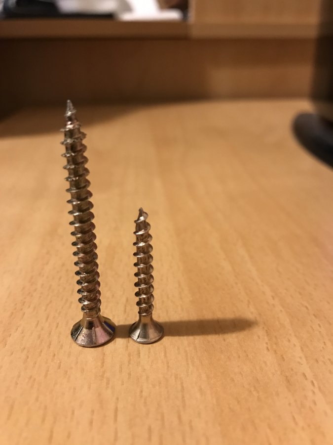

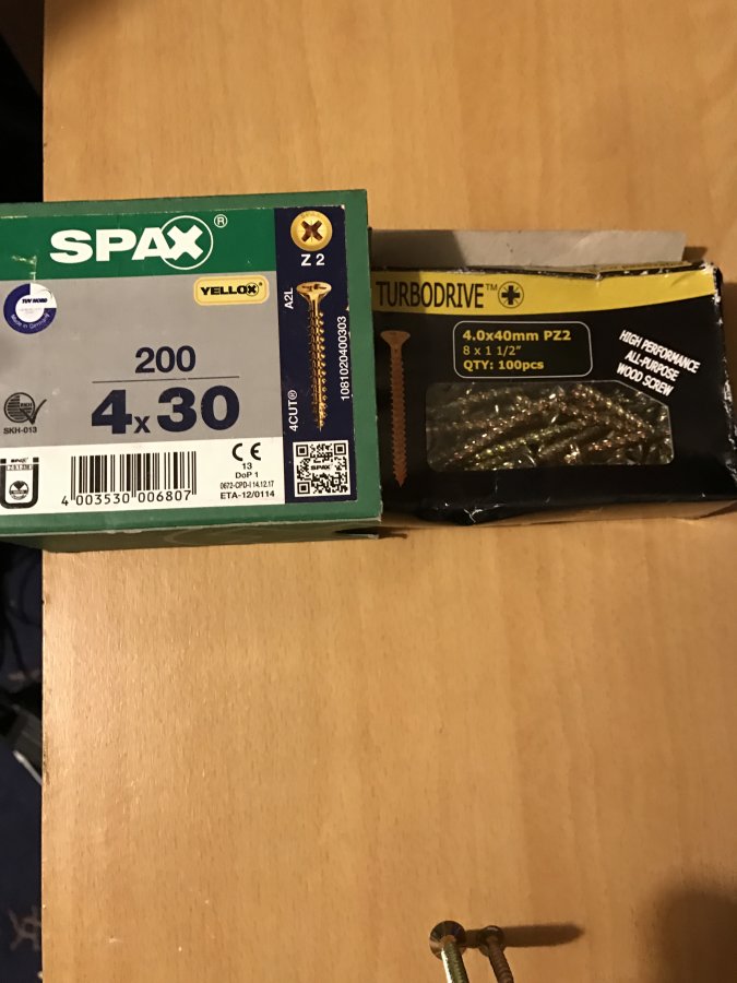

So one screw has the size 4x40mm and the other is 4x30 I assumed this meant that both diameters (thickness of screws) would be same and it's the lengths that are different. However, when I look at them side by side the 40mm seems a lot thicker. Please see pictures-how can there be this difference? Thanks for any help
Measure them, and see which one is actually 4mm, as they certainly aren't 10mm difference in length. I'd say the one on the right is a 3x25, so it's either in the wrong box, or the box has been mislabelled. Had a grey door turn up in a box marked High Gloss White the other day - it happens.
So what are the measurements on a tape measure. It's possible that they are working from two different standards - odd though. I'd be inclined to trust Spax.
No real idea how to measure it using tape for the diameter to be honest. Does the tape need to wrap around the screw? It's impossible to use this method to get an accurate reading. Any tips?
Just hold the tape in front or behind the screw, and see how thick the internal shaft is, and then with the thread as well. It's possible that Spax measure across the central shank, and Turbodrive are measuring across the complete thread, although having done a quick Google search, it seems as though the measurement should be across the thread.
I think the trick in future will be to stick to the same make of screws for conformity.
Mystery solved- spoke to my mate who is a joiner and who left the turbodrive screws at my bit. He says there are mixed screws in the box... thanks for your help though mate, thought was going mad there...

not a hard and fast rule but the head will be roughly twice the screw size so an 8mm head will be around a 4mm screw
