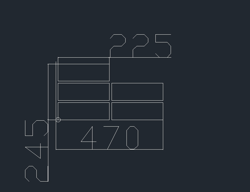

Hi I want to build a set of steps from brick. Profile attached. forty five bricks in total. Nine bricks wide. Sizes are mm
How deep should a concrete base go into garden soil.

It depends what sort of substrate you have and what you're going to use the step for.

Strip foundations can be 200mm thick and have a house built on them (depending on exact conditions)
Reference: NHBC Standards, Part 4, Chapter 4.4, Appendix 4.4A, which quotes Approved Document A1/2, Section 2E.

chapter 4.4 is nothing to do with strip foundation. link?
You need to remove the topsoil layer, and a bit of the next layer. So it's not so much about dimensions or if it's a step or a wall.
Topsoil is typically about 200-250 deep.
