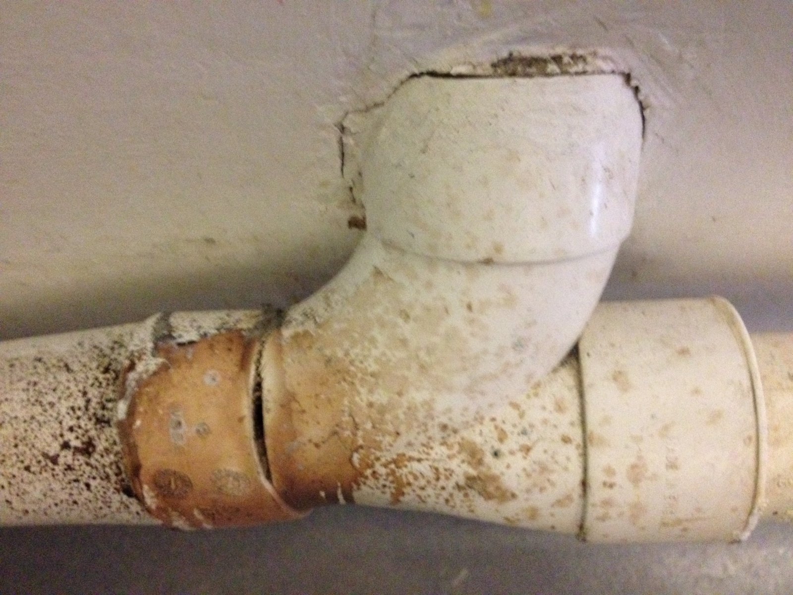

Gasbanni, I take it your question is tongue in cheek? Giving a DIYER a litre bottle of acid is not a wise thing to do.

Why not acid?

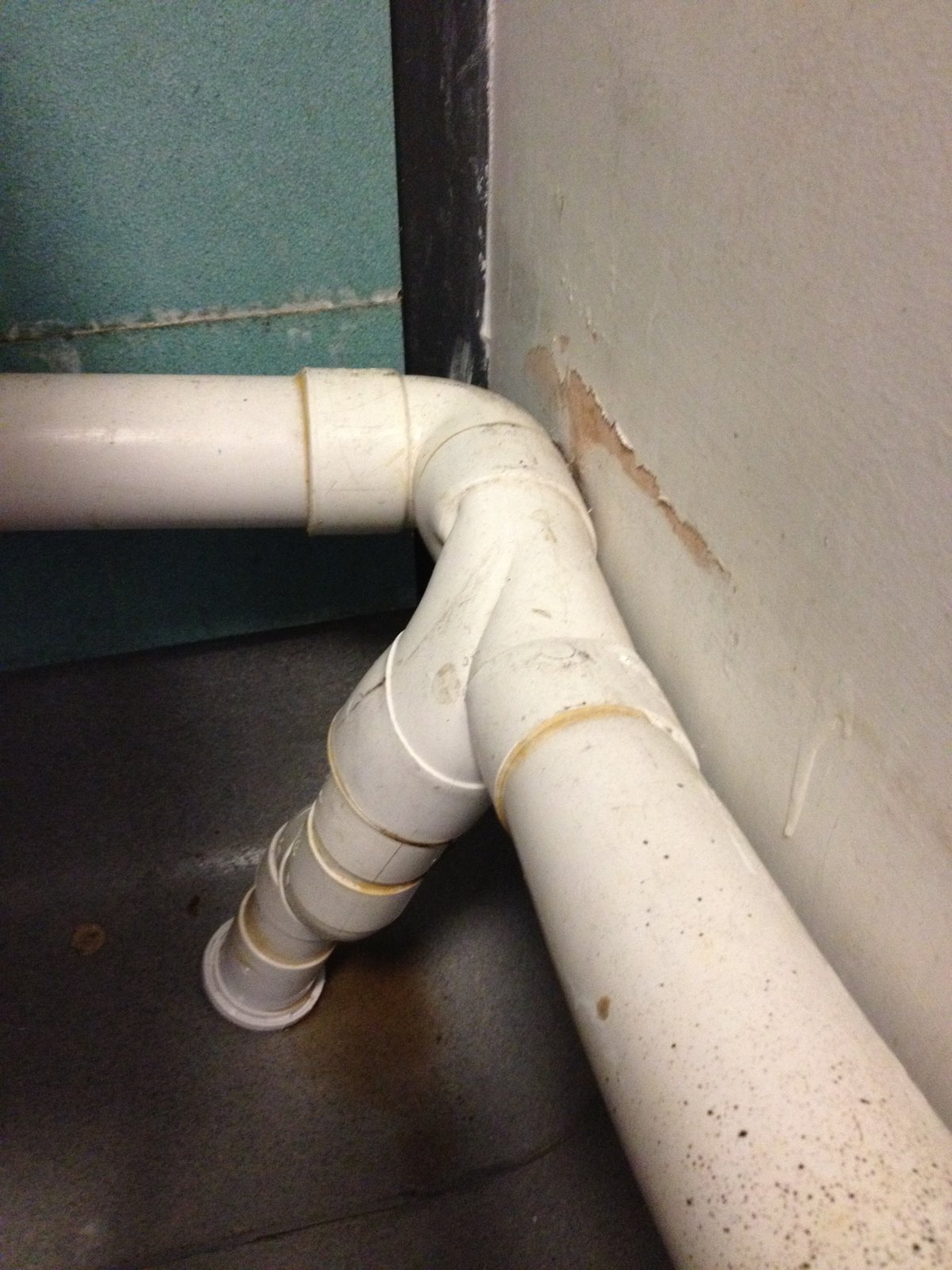

Because this is what happens when acid reacts with the contents of plastic pipework.
The swept tee in the second photo used to be vertical - the pipework melted sufficiently to allow for a 180° rotation.
The service cupboard (containing this pipework) was sprayed to a height of around two feet with the acid and the fumes inside the cupboard were unbelievable.
Andy
I didn't think of that ! I thought there were other reasons you were saying not to use it...... I've used O.. S... numerous times in situations where nothing else could have been used due to access and had sucess every time.
I don't recommend customers use it, it's pretty dangerous stuff.
View attachment 136056 View attachment 136057
The first image is odd it looks like the swept t has come apart at a joint as the break line is clean, it looks like one part was recessed in to the other, never seen a tee come apart like that.
O.. S... can't be used on urinal pipes that's for sure !!!!!
