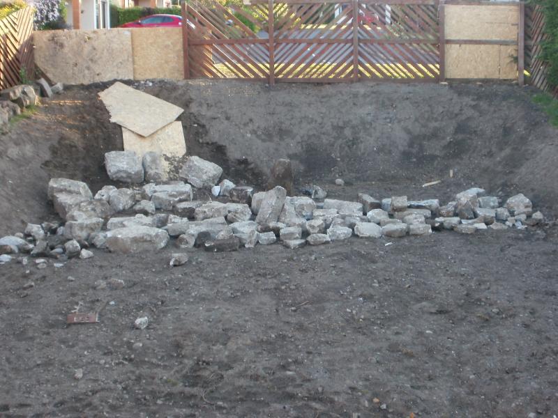

Hi all,
Planning a dry stone retaining wall in the garden and bought a bargain load of reclaimed sandstone where a local railway bridge is being demolished.
However, some of the blocks that were dropped in the garden are nearly a cubic yard in size!
Any ideas on how I can split these into smaller blocks?
Plan B could be a scale model of Stonehenge :confused:

Think an angle grinder cut all around then blows with a big hammer might do it, or am I wasting my time?

Yes, that would do it. Score all the way round with a 9 inch angle grinder. Make sure to keep a good grip of the grinder, using the side handle (and don't wear gloves because this reduces control of the tool and if you slip your glove could get caught in the disc).
Then put a bolster chisel into the slot and hit with a lump hammer (or if that doesn't work, a sledgehammer.

Stitch drill right through right across and then hit with big hammer.
Doesn't look like sandstone.
Sandstone is a more yellow colour.

The first thing is to see if it has any grain, it will split more easily along the grain. The traditional (medieval) way is to chain drill the line. Insert "feathers", a pair of slightly curved (to suit the hole diameter) bits of steel sheet , half way into the hole then hammer a steel pin into the space, on all holes at the same time. The purpose of the feathers is to stop the pin sticking on the stone sides to the hole. could try to grease the interface?
As said grooving all round is the way to go, the only advice I can give is to rest the block on a piece of steel bar along the bottom groove. This will encourage the block to split open at the top, and swivel at its bottom edge. I have actually broken blocks by just dropping them onto the bar.
