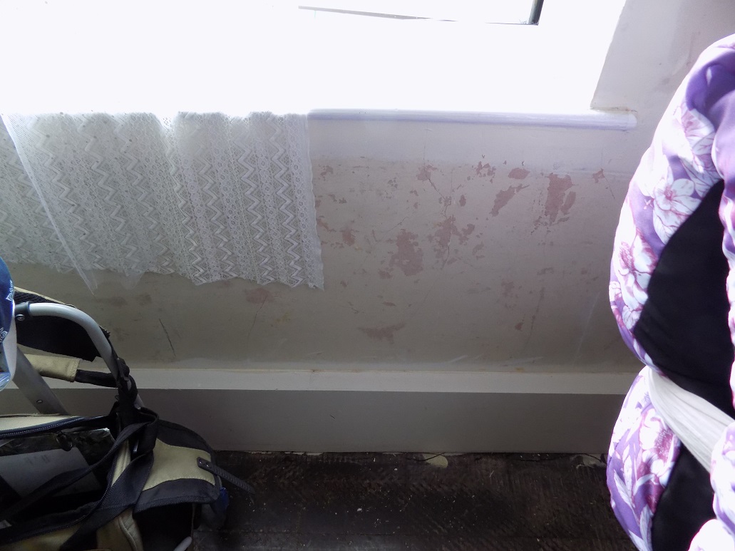

I have removed the wallpaper from the wall & the whole wall has a thin layer of 'cream' coloured paint over the plaster - what is this paint do you think?
Where the wall meets the skirting board there is a thicker paint in a line just above the skirting. It seems to be some sort of seal idea. Can you please tell me what products you think these are as I dont want to change it just fill in any areas where things are not 100%.
Thank you
You can also see the cream line beneath the window sill..its the same as above the skirtings & pipe boxes
it is paint.
When the client specifies that a room is going to be wallpapered, the paint on the woodwork is purposely overlapped slightly onto the plaster, so that when the wallpaper is inaccurately cut, or shrinks back when drying, there will be no patch of bare plaster to catch the eye.
if the walls are going to be painted, there is no need to overlap.
it is paint.
