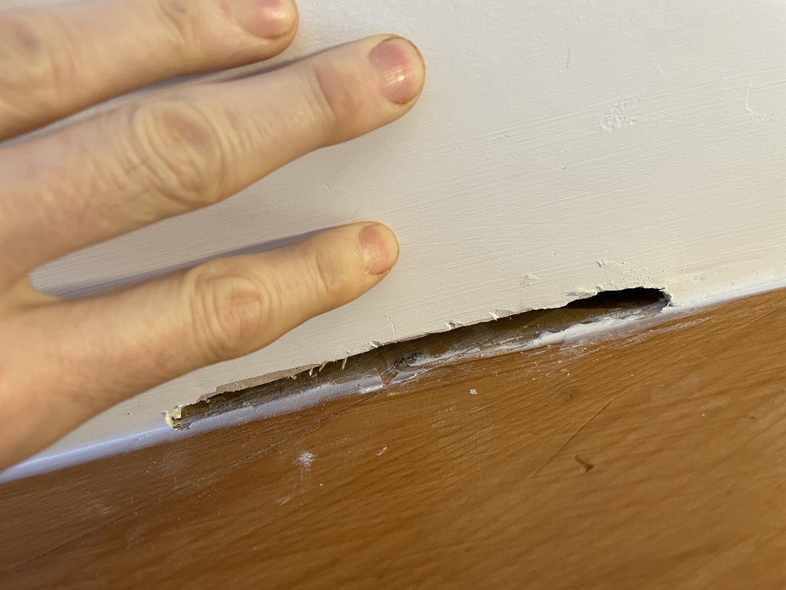

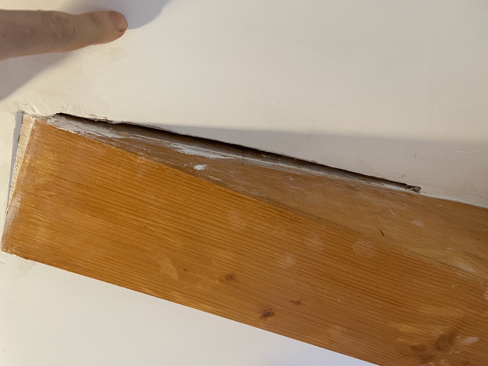

How do I fill this gap?
28 Apr 2021
285
3
i have a large beam that cuts through the corner of a room and there was some loose filler between the plasterboard and the beam which i raked out, now there a few large gaps down the side of the beam, almost 10mm wide that go up into the loft. Whats the best way to fill this gap?
Use lightweight filler. Very low water content and has a bit of give vs other sorts of filler that are hard and may crack out again.
You know you found right stuff as pot feels empty. Push plenty in
