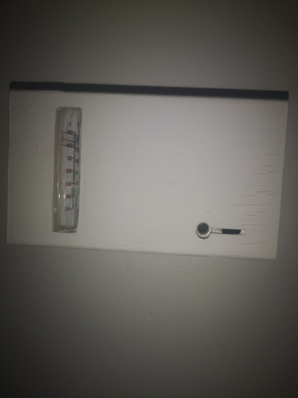

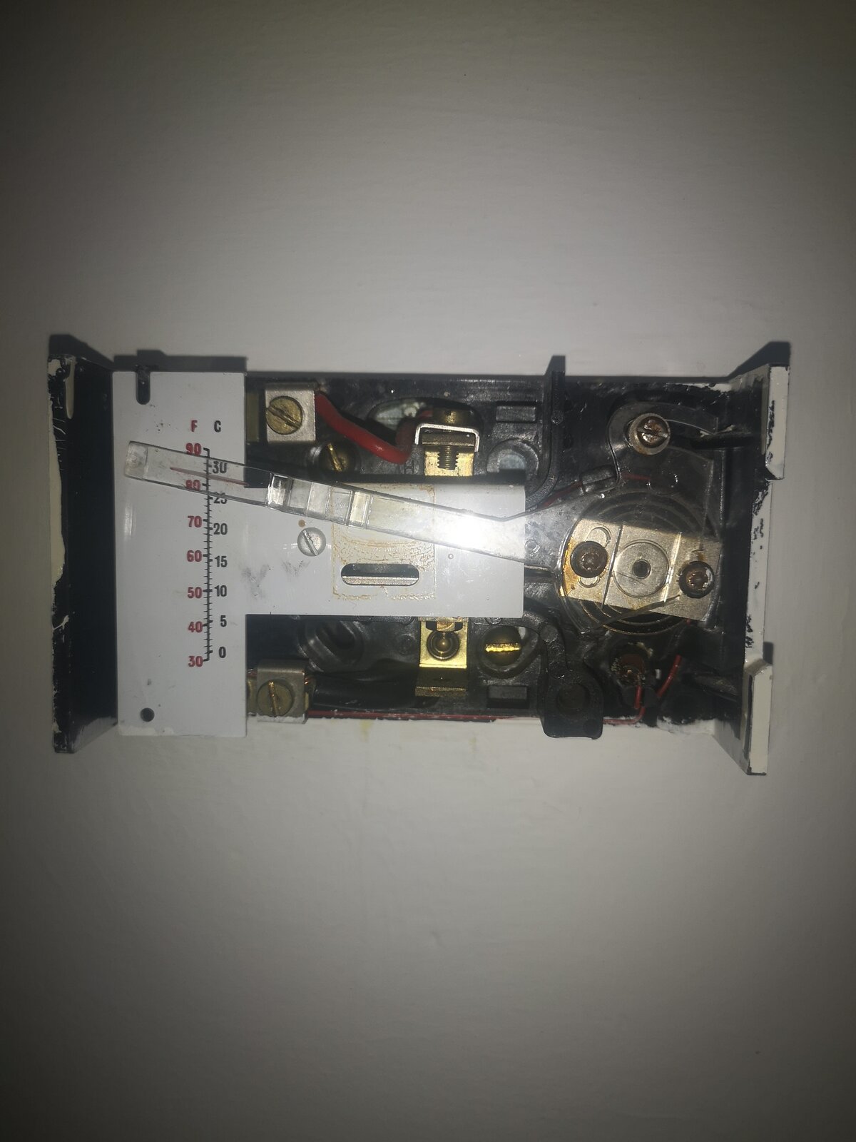

I currently have underflooring heating, however the individual room thermostats are very old and have the bimetal side dial feature. I am wanting to see if it's possible to upgrade the thermostats to a more mordern, digital one. Although, I'm not sure the model of the exisiting thermostats. All I know is they are Sunvic.
Can anyone help at all?

Cannot tell from the picture but if it only has 2 wires then any 2 wire stat will do the job, however most with displays will require a Neutral wire which you may not have,
A black wire is not always a N wire, if you only have 2 wires.
In fact, in the context of a thermostat, "A black wire (or any other colour wire) is never a N wire, if you only have 2 wires".
Kind Regards, John

I have electric underfloor heating. I'm not entirely sure which type though. I'm new to the property, I've just recently moved.
Most thermostats available will NOT be suitable for that.
Those old Satchwell and Sunvic things typically switched 16 amps, which is the full load of the eectric heating for that particular zone.
Most modern thermostats can only deal with 2 or 3 amps at most.
