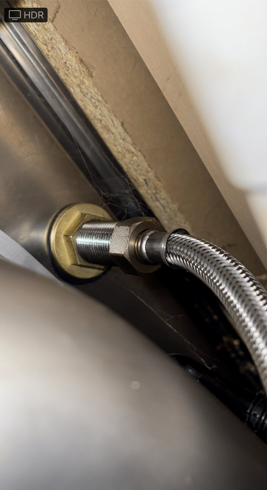

Isn't it held in place by a nut and threaded rod under the sink?
This is how it looks underneath. But that is basically impossible to access unless you’re about half a foot tall.
So I’m pretty ****ed if it is that.
But to my very uneducated understanding; I only need to go under here if I wanted to take the entire tap off - to replace it.
Whereas I just want to replace the cartridge because it’s dripping
