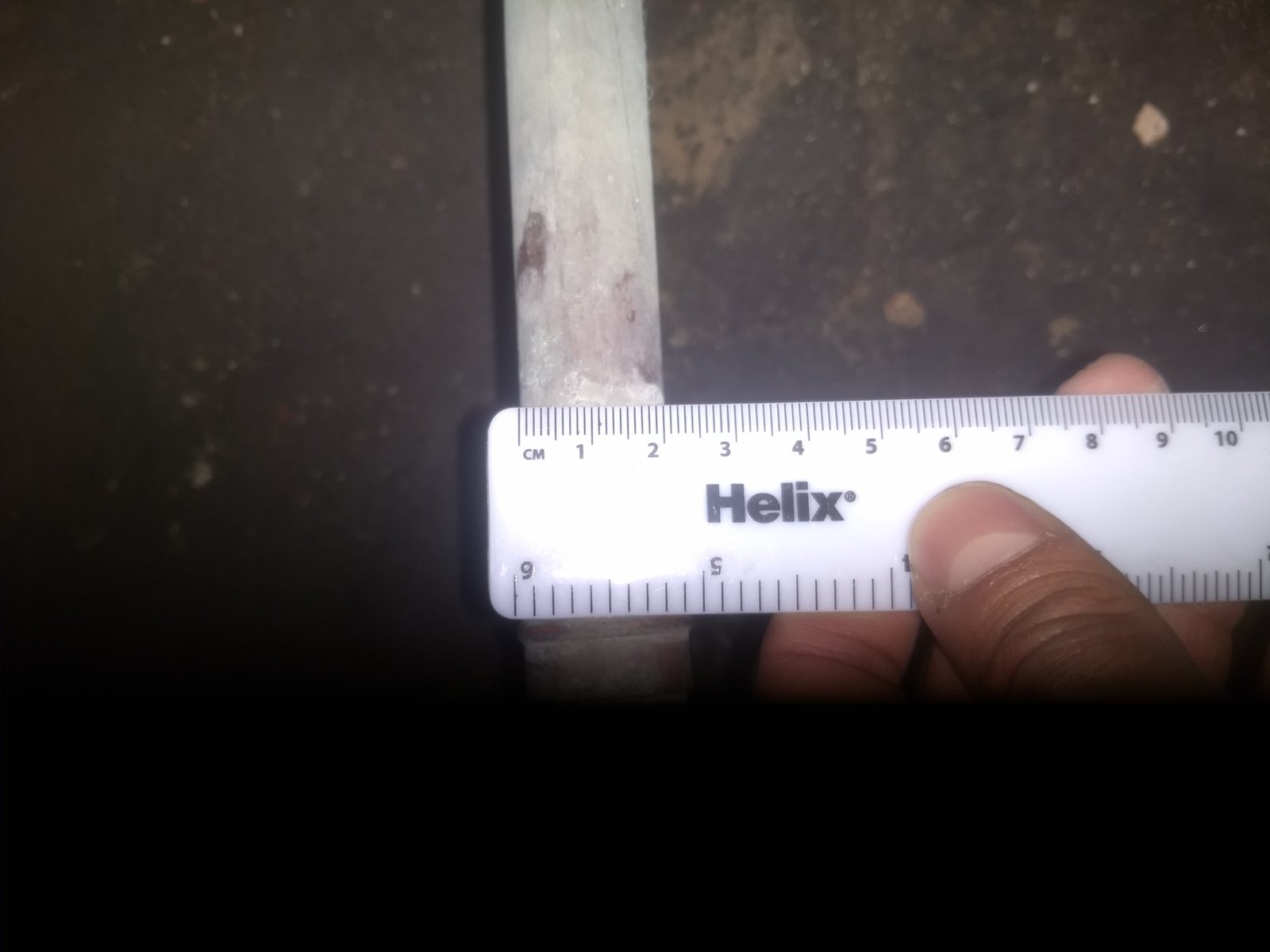

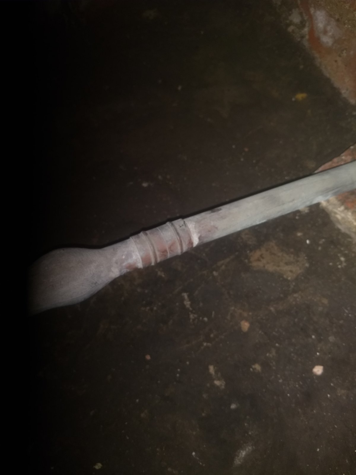

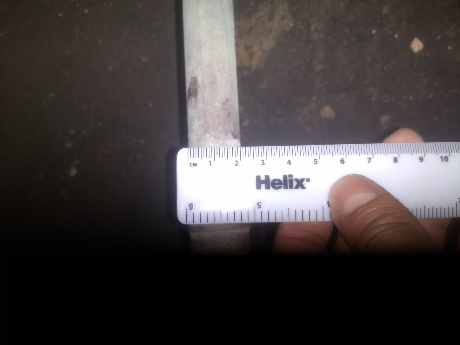

Hi,
I'm sure this would be simple for someone but I'm an amateur plumber and am lost!
I have discovered a leak under my floorboards, in the shared mains water pipe. It is part lead, and part metal. It is leaking from the lead section.
I want to cut the metal pipe and join it to mdpe, but am not sure how i would go about doing this. Any one able to help?
Thanks,
M
A lead to copper fitting, such as a leadloc, plasson or philmac Utc, you just need the lead size, usually 5,6 or 7 pounds. Which part is going to be mdpe?

@Chris_W I was planning on cutting the lead away and connecting the pipe on the right to an mdpe one. I will have a look at those you mentioned. Thanks.
Or taking into consideration @dilalio comments just wondering how I might go about sealing the leaking lead pipe? Its only a very small leak so could i wrap it in something?

You could try some self-amalgamating tape (pipe leak repair tape) but a cut out and replace is needed for long term.
@dilalio thanks for the tip, I've just ordered some bits from Toolstation and will see if that fix holds.

You need to measure the diameter of all the pipes to establish the correct sized fittings - I'm slightly confused about the mdpe , I can only see lead sweated onto copper? If you mean you'll replace a section of lead/copper with mdpe then yes, that's the way to do it - access permitting you should try and replace as much of the old pipes as you can - it's the same 2 connectors and only pennies for the extra mdpe but will reduce the risk of future leaks. Also insulate the pipe where possible as there is a risk of freeze related leaks.
