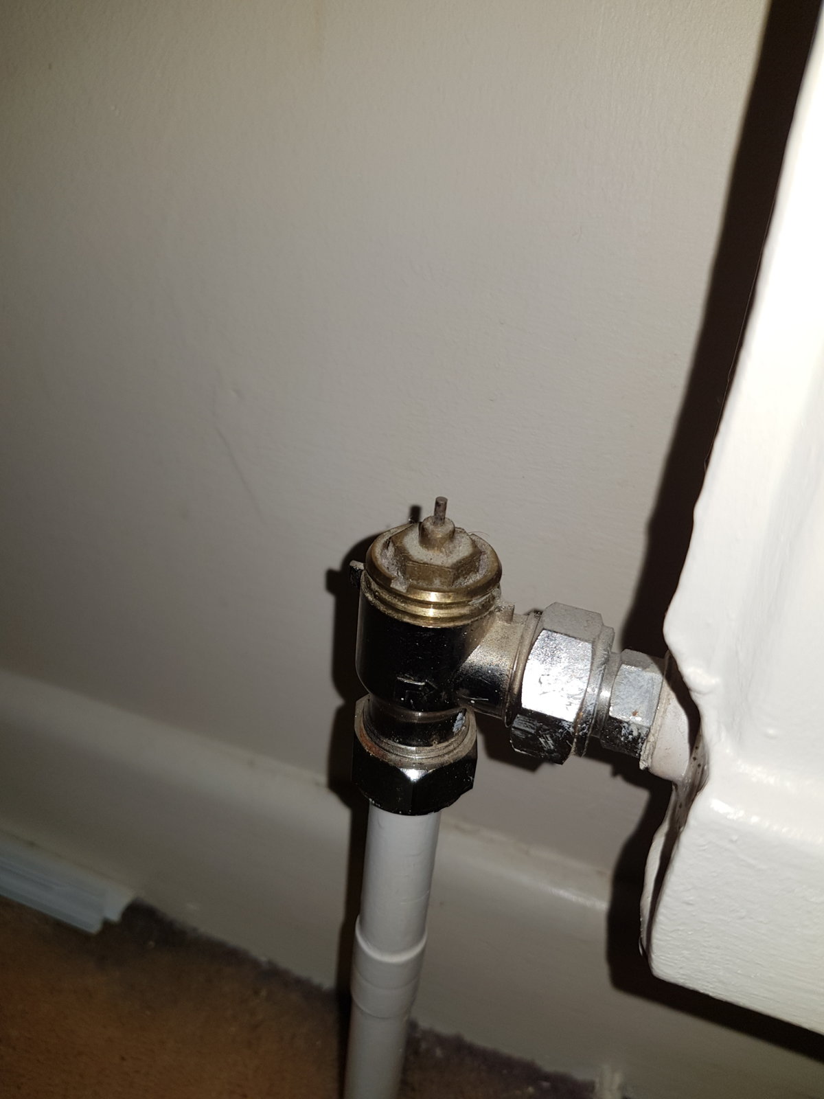

I have one cold radiator in my house, and after some research it looks as though the issue might be a stuck pin in the TRV.
However I can't work out how to remove the cover to get at it!
The brand seems to be Myson. It looks pretty retro - no obvious collar that twists, it feels like one solid unit - and I'm stumped. Even less helpfully, it's right in a corner so impossible to look at it end-on. Any ideas?

Havent seen one of them old boys for years , you need to set the sensor to maximum then slide the securing O ring down with a screwdriver till it is free of the sensor then you will be able to pull the sensor off, once you free the pin put the O ring back on the sensor head before attaching back on the valve then push it all back on and it will snap back on
Ian, your advice was perfect! The pin was indeed stuck 'in' once I got in there - once I'd cleared the dust and rust and taken a little WD40 and a pair of pliers to gently pull the pin outwards, all was well. I can feel it warming as we speak!

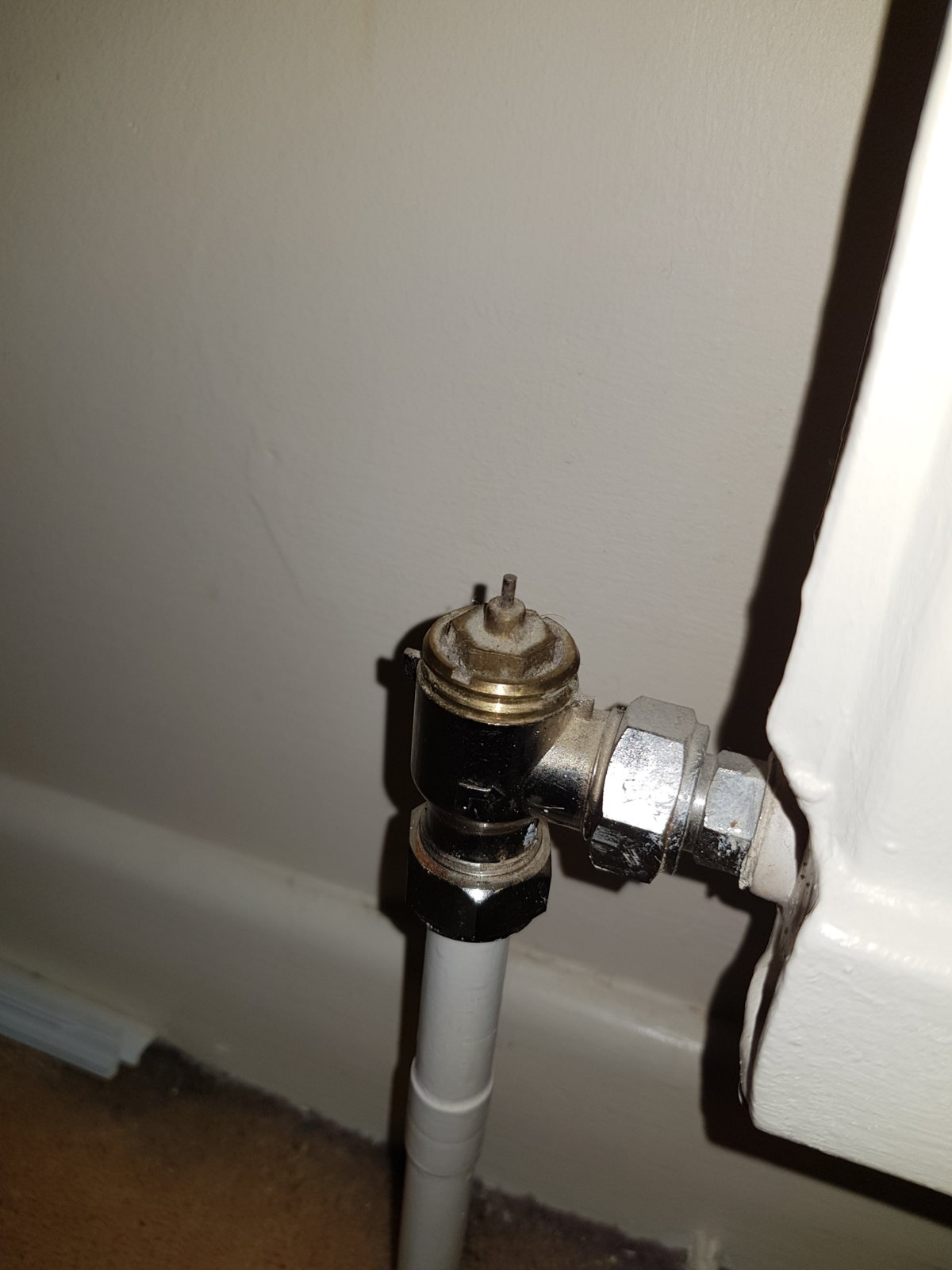

I appreciate this is a very old thread but it's the only reference I came across on the Internet when searching... I have a house with a radiator with this same TRV valve but it's broken and the radiator is on full blast all the time... I managed to get it off using the instructions but notice the valve is not a screw thread but more of a collar that the TRV clipped onto. I want to replace the valve and wondered if there is an adapter.that will allow me to use a modern screw on TRV or whether I just need to get the whole unit replaced.
Here is a photo of the unit to help explain it better.
