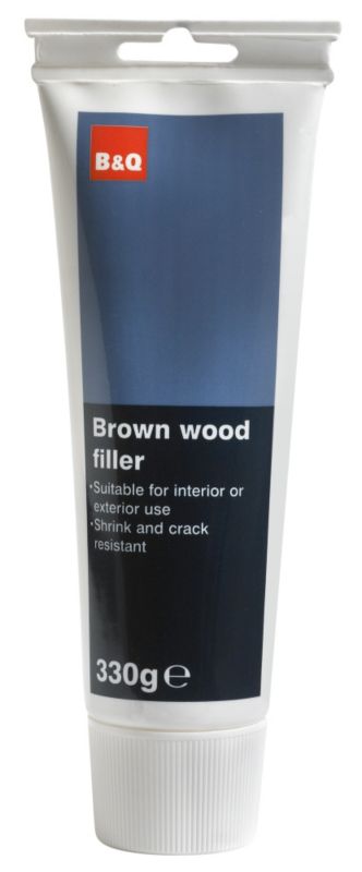

could try something like this, and paint over with wood stain !!
Worth a try, to save £600 !!

Absoluely - I'm willing to try anything to save the money!
The only thing I'm worried about with the filler is, can you paint over it? And will the colour not be different on filler to how it is on wood?

It is Dark Brown wood filler designed for filling on hardwoods, depends on how bad the damage is as to how much it will show.

I would use a two part wood filler to repair the damage. It sets fairly quickly, and sets very hard too - yet easy to sand. Get one that is coloured the same or lighter than the existing wood.
What kind of wood stain is it? If it's something fairly glossy like Sadolin, you may find when you stain over the filler it looks very yellow, and nothing like the colour you want.
In that case, wipe the new stain off, and find a more matt stain a similar colour and put that on. Then, when dry, put the correct stain over.
