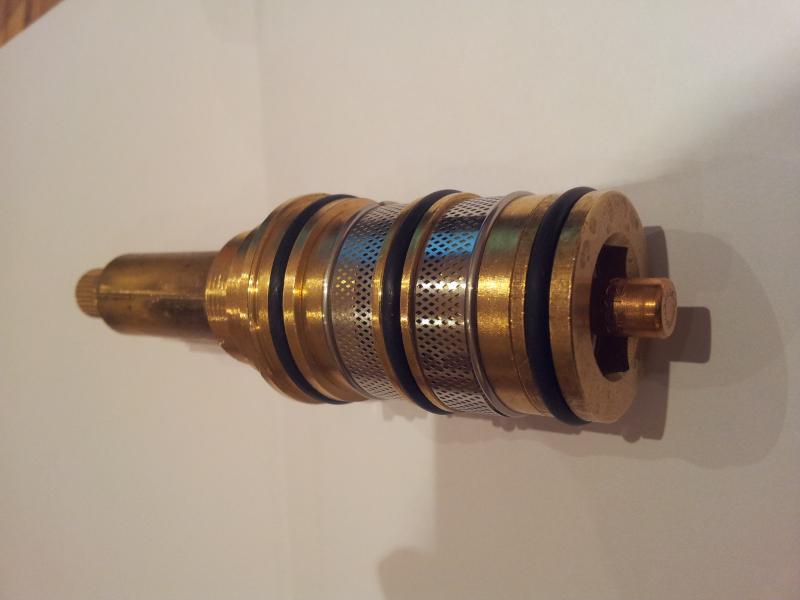

Hi,
The thermostatic cartridge / valve on my concealed shower unit seized and it needs replacing, I had a go and then got disastrously stuck... any hints on what to do would be great!
Basically, I couldn't work out how to remove the cartridge from the unit, I got as far as picture 1 shows, I'm replacing the valve on the left.

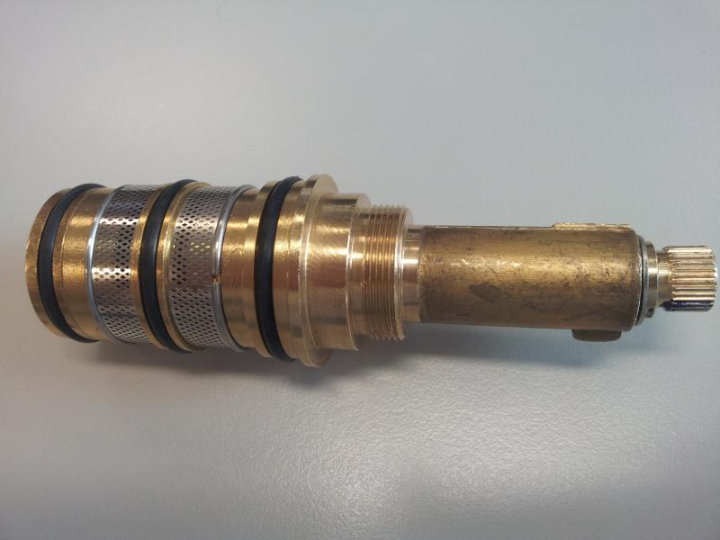

I have the replacement cartridge, shown in pictures 2 and 3.
Any advice with regards how I get the old one out and then stick the new one in and set the temperature correctly would be very much appreciated.
Thanks!
P.s. I did ask for some instructions from the shower supplier (Pura) when I ordered the new valve but the instructions appear to be for a different valve and give details for how to disassemble the valve itself rather than how to fit it.
Looks like a case of getting grips onto the outer casing of the shaft and pulling like bu**ery. Refitting is a smear of vaseline on the 0-rings and a gently push.

I would have thought there must be some kind of retaining ring/circlip/nut holding the whole thing in the assembly or have you removed that already? Plus what fits to the threaded part shown on the new cartridge?
Brute force won't be any good until you are sure there isn't anything else holding it in. For sure it will probably be tough especially if it's well scaled up.

I think the screw thread on the replacement valve is where the chrome cylindrical thing that is between the actual cross head tap part and the face plate goes.

I would assume the thread on the thermostat unit is what holds all the components together - filters, brass waterways, o-rings etc?
I would also guess that there is a locking nut that screws into the body of the valve, as KB mentions, to hold it in.
In your 1st picture I presume the thermostat is the one on the right? Looks like there are 2 flat edges on the bronze at the outside edge of the body. I would think that getting an adjustable onto that would then allow you to unscrew the locking/retaining nut that holds the thermostat in.
I would also suggest that you use silicone grease on the O-Rings, anything petroleum based can rot the rubber that the seals are made out of IMHO.

I'm pretty sure the thread on the thermostat unit is for the chrome decorative thing, that is visible once everything is fitted, to screw on to. Both ends of the screw thread are visible, if you know what I mean, the thread doesn't dissappear into the thermostatic valve itself. I have just attached another image of the valve, in case you can zoom in enough to see what I mean.
This link is very similar to the thermostatic unit http://www.purabathrooms.com/product/index.php?q2=XL222
The thermostatic valve is the one on the left, but I think you may be right, there does appear to be some sort of hexagonal locking nut, which may be keeping the thermostatic unit in place.
Thanks again!
Yep, looks like the hex nut lands onto the flange face just to the right of the first o-ring, so, undo nut then pull.

The way to remove the thermostatic valve is to 1. remove the 1.25 inch retaining nut, then 2. pull out the valve. There is the combined resistance of 3 rubber O-rings to overcome. So ... pull out the valve as follows: clamp a mole wrench to the outer stem, and use the claw of a hammer between the wall (care not to damage tiles) and the mole wrench, to gently prise the valve outwards. On reassembly, be sure to use silicon grease on the O-rings before you insert the valve into its receptacle.
