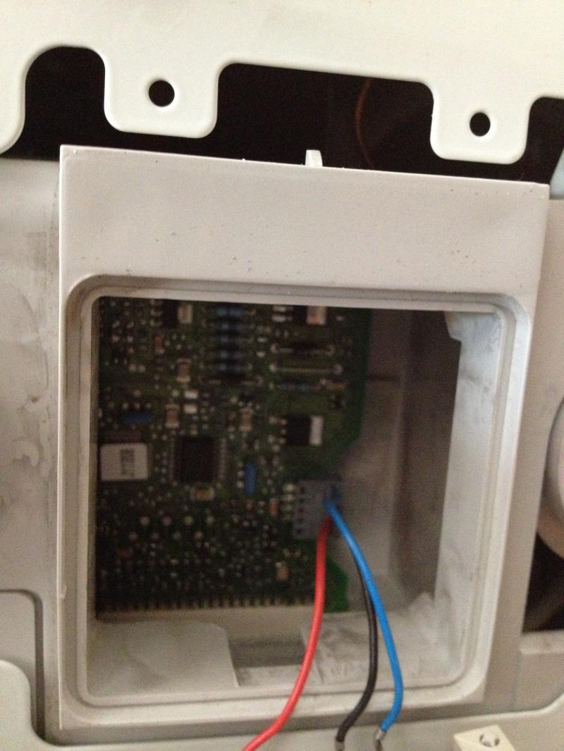

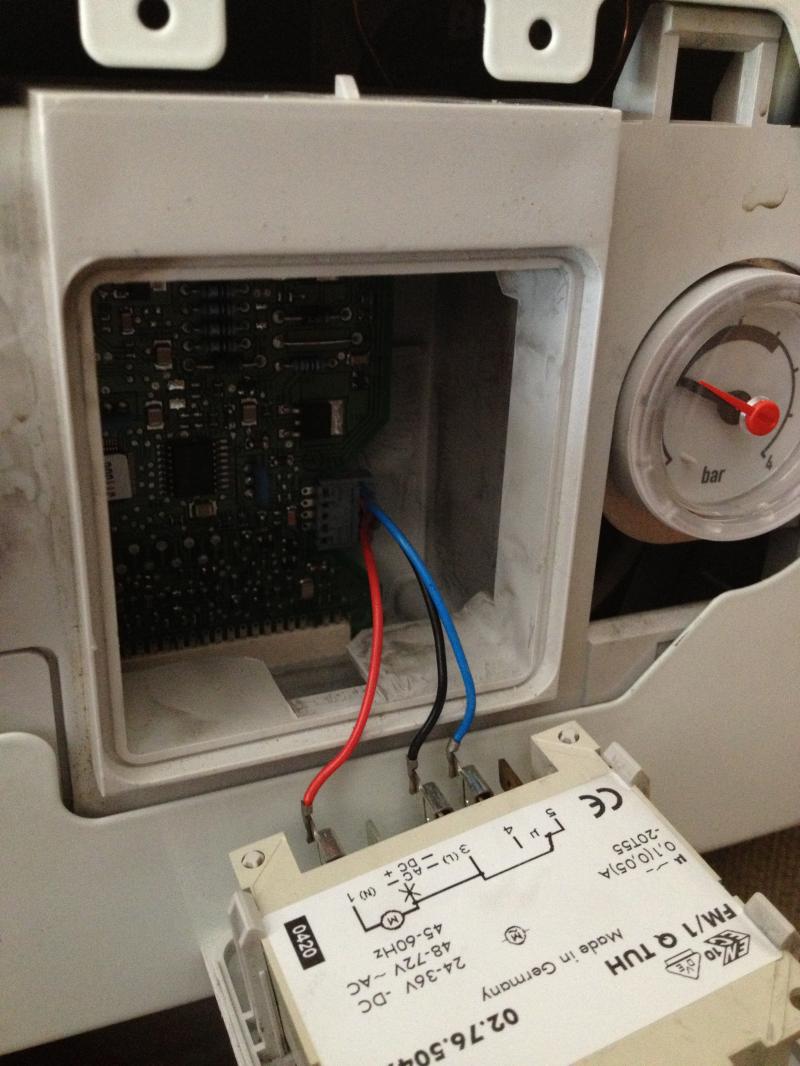

Hi How do I wire a Danfoss TP5000-RF Si+RX1 to a worcestor 24 i combi boiler,Iv pulled the old timer out and its got three wires on it a black a blue and a red( see pic) iv tried looking on a previos thread about another worcestor boiler and I didnt understand,in plain english please
You can't use the same connections for the Danfoss stat; it has to be connected to the boiler's Ns, Ls and Lr terminals. Connect as follows

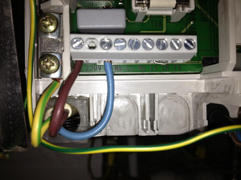

Hi,thanks for ur speedy reply and sorry for the delay in the return post,I have dug a little deaper into the boiler and removed the metal cover and the plastic screw on cover over some electrical connections and I think this is the bit im looking for see pic two on the new pics,so if i run some wire long enough to mount the rx1 to the wall and then tag into the connections show in pic (fingers crossed iv got it right now)all should be ok,did you say I would have to leave the manual timer on constant,what will this do,im sorry for sounding such a nummy but just wanted to be 100% before I started job as not to break anything,
You can see the terminals Ls, Ns and LR in the picture on the left. Connect the receiver to them with a 3 core heat resistant cable. You should not use the green/yellow earth wire as one of the wires, so you may have to buy 3-core plus earth.
I forgot to mention that you must remove the link between Ls and LR.
