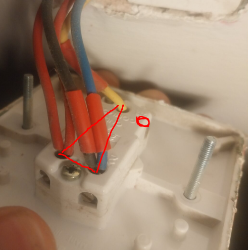

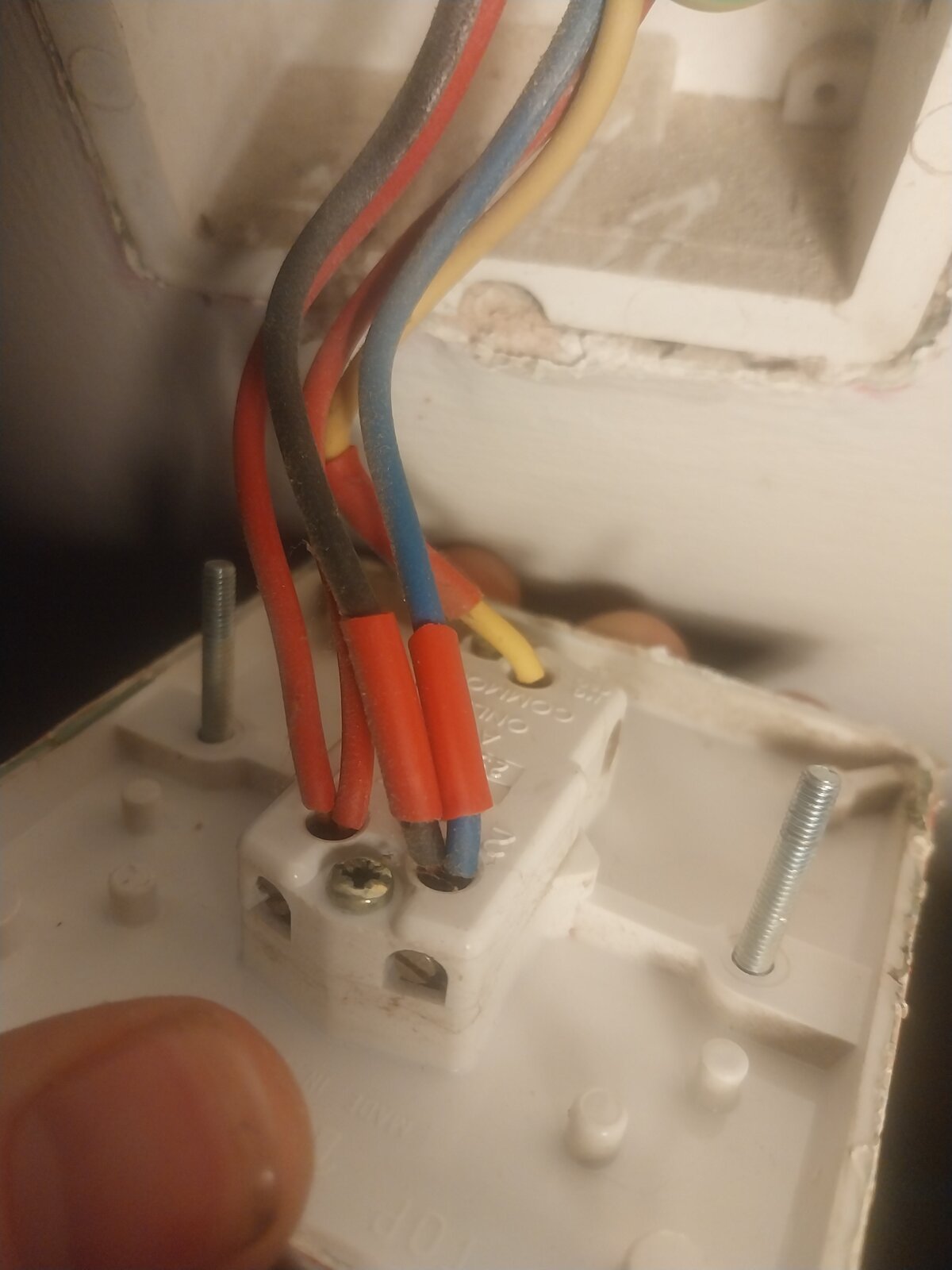

I am wiring and old switch which has L1 L2 and common to a new switch which has 2x L1 2x L2 can anyone help please
You have bought an "intermediate" switch but it will still work.
Just copy the triangle of wiring connections and ignore one of the terminals at one end - it doesn't matter which.
