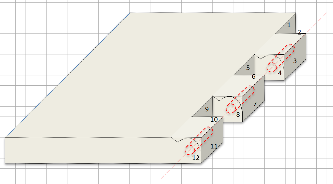

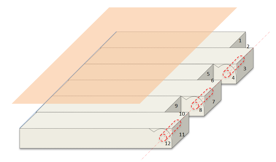

a foot long, 6mm diameter, in a thin board?
I want to make a comb hinge. There's no particular constraint on the finger width, maybe 40-50mm so there would be half a dozen of them on the edge of the board (ply).
(The ply is about 250 wide and will have another on the other opposite side edge.)
The hole/board thickness may get changed. Say hole is 6-8mm.
The lighter bit is where the finger sticks out. OK you knew that...
I have a thought but will wait for yours.
Any tricks?
Consider making an aluminium jig which when held in place will give you the centre you require - perhaps with a 3mm guide pilot hole.
Use the jig to mark each piece separately and once youre happy with it, upsize to 6mm.
John :)
Errm, not sure what you have in mind.
This help? Faces are numbered including the ones you can't see.
The Zip attachment is just the Word .docx =the sketch file, which is 3-4 repeated shapes. You should be able to edit:

For sure, extra long length HSS jobber drills are easy enough to get from Cromwell tools or similar - the issue is stopping the drill running off, and getting it plumb in the first place.

Yes I see I can get 300mm drill bits, and yes it's the wandering-off which I'm concerned about.
I thought someone might have a cunning method.

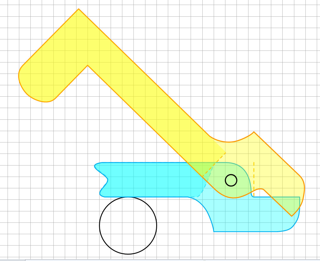

It's the wheelchair footplate extension thing posted here.
It makes a very long post to explain all the constraints and desirabilities of the the overall requirement. I can think of a dozen ways to go about it, but in most cases hit a particular snag, as with this one. Hence I'm looking here for a technique rather than a design.
That thought I had, as it's plywood, was to use two, part-thickness sheets with a semicircular groove in each half, made with a core box bit or started with just a saw. It's plywood anyway so the glue line wouldn't be much different.
Plan behind this one was to use brass tube pieces rather than a rod, with a series of bales catches in the tube section ends. Then if Dad steps on the flap, it comes apart non-destructively.
When the flap is up, it doesn't matter where it goes exaclty, >90° will do.

Thanks Rog that's the sort of thing I was hoping someone would come up with. I'd had thoughts around it using 3 sheets of ply to leave a groove, but not seen it done. I wondered abouth the same core box bit. I don't have a saw bench so his method didn't occur to me
There is another way, clear if I take the lid off that other sketch. Bit of a pain though:

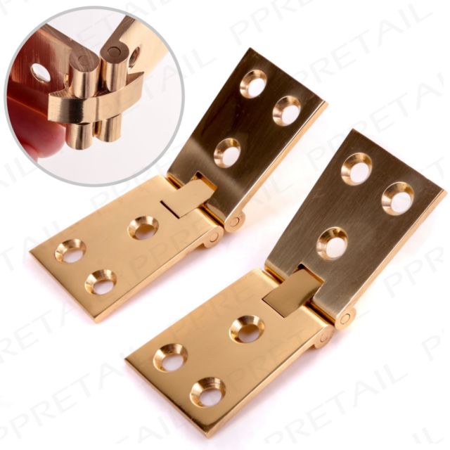

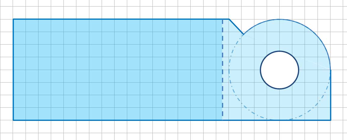

This is like a countertop flap hinge: I could maybe just use those but they tend to be too big, and/or the fixings screws would go into the steel tube which I'd rather avoid. Then, again, they aren't designed to be stomped on. Remionder - if the plate is more than 12mm, it won't lift, so I can only increase the edge thickness, where the metal tube isn't. Maybe an inch.
Ctop hinge:

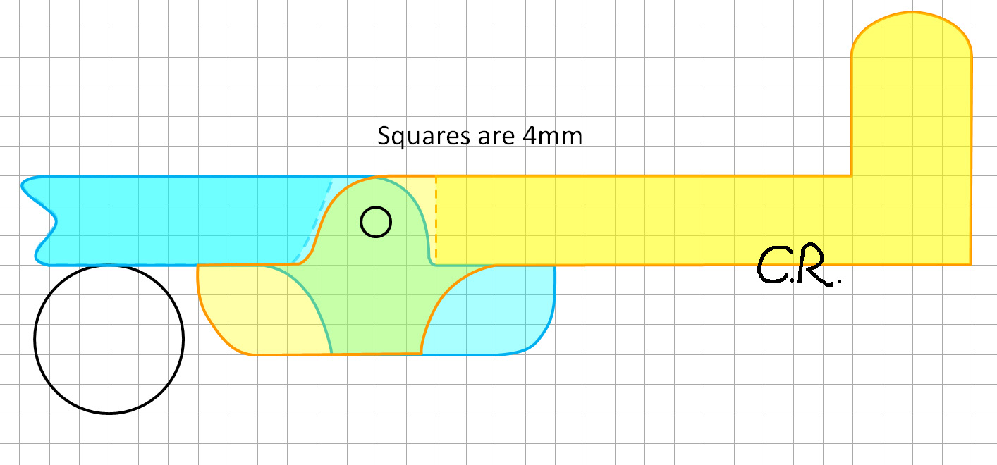

My variations:

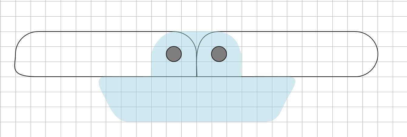

Either two pins and a "boat":
or one with just one pin and two under-fingers:
fp3.jpg which actually leaves a smooth corner when its folded up
FOlded1..jpg.
you just wont get structural strength into any wood less than 12mm
you can use a piano hinge as i said before to take a bit off weight if set up properly but only a few kilos per ft so never any real strength just a bit off side support
metal and brackets probably welded are more than likely the only option that will give you piece off mind
