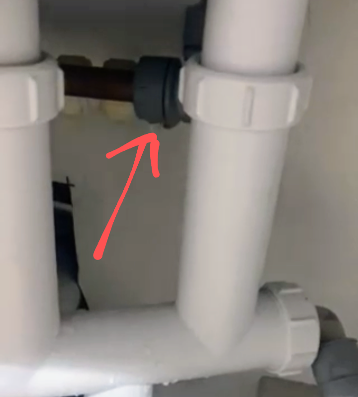

There's a leak at the marked area under a sink. The fitting looks like the linked toolstation one, although another poster thought that it could be a hep20 fitting
For the grey fitting the pipe appears to go to an isolation valve
I am after advice on the best way to repair this leak. Apparently, hand tightening the joint failed to stop the leak.

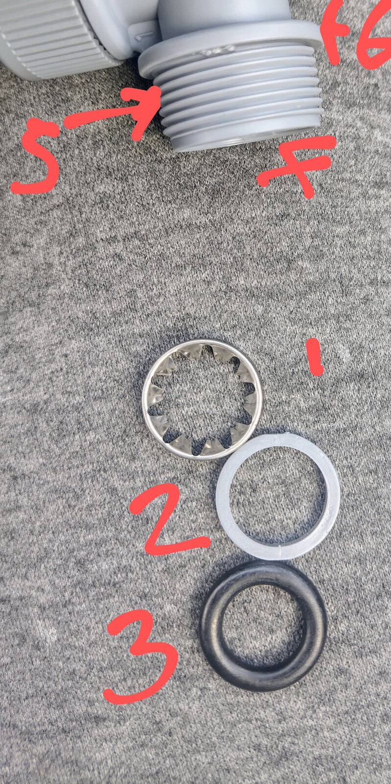

Pair of pliers, they snap easily.
Please explain it to me like I'm 5
I have attached an image of the part, unscrewed with the internal parts on display (ie 1, 2, 3)
So i do the following
1. Unscrew the fitting
2. Do i pull the pipe in one direction and strike the fitting at 4 or 6 with the pliers?
Or an i supposed to compress the fitting with the pliers at 4, 5 or 6?

Unscrew the fitting and pull the elbow off. Grab 1 with the pliers, on the edge, and turn till it snaps.
They are dismountable, but it depends on what is on the other end of the pipe.
You can also cut the pipe and remove the grab ring by pulling it backwards, towards the cut end.

No - follow @denso13 's advice if there's enough pipe between the fitting and the valve >0 unscrew the grey nut of the fitting > pull off the elbow > then draw the nut a backwards towards the valve (if there's enough pipe) > that'll expose the grab ring and washer > grip the grab ring side on with a pair of pliers and twist it >the grab ring will snap then pull off the washer and nut.
If there isn't enough pipe to expose the grab ring then just cut the plastic nut lengthwise and pull it off (dremel, junior hacksaw, etc)
