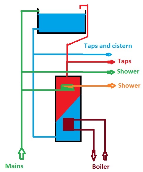

Before choosing an unvented cylinder, you first need to get your incoming mains tested to ensure it is actually up to running it. There's absolutely no point having an unvented cylinder if the mains isn't powerful enough to drive it.
System boilers and heat only boilers work in essentially the same way. The two major differences are that a system boiler has a pump built in, whereas on a heat only it's external, and a system boiler is usually fitted to a sealed system whereas a heat only can be fitted to either sealed or open vented systems. Your existing system & rads should be OK but there's no real way of knowing until you try it.

So there's still only one flow and return to a system boiler, like I have just now? And it still heats the DHW via a coil in my (new unvented) cylinder?
I note the general consensus that it maybe isn't last orders yet for my Ideal Classic. So what's with the light scorching on the inside of the casing - just an age thing and nothing to worry about? Are new casings still available for the old girl?
Yes, it does exactly what your existing boiler does.
If you want mains pressure hot water, an unvented cylinder is required. That could be supplied from a new boiler, or the boiler you have now.
There are so many ways boilers can heat the house and DHW. The cylinder can have the hot coil at mains pressure, the tank at mains pressure or both using a header tank, with the latter a pump can actually result in better shower pressure than mains, you are not allowed to pump direct from mains.

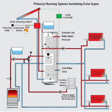

Having some sort of cylinder means you have more options, this Torrent pipe example.PNG shows where solid fuel, electric, and solar are combined, and it can also include a boiler, well maybe boiler wrong name, in the main if it boils we consider it faulty.
