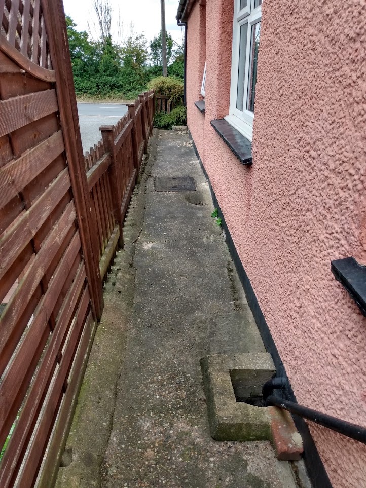

Concrete path goes up to damp course in places, covers one air brick completely, partially covers others. Have been dealing with rot inside, need to get rid of that path.
Had a quote of £400 just to break it up, £500 to also take it away.
Can weekend hire a 30kg breaker for £55 - https://www.hss.com/hire/p/medium-duty-breaker-hilti-te2000
Will this get through my path? I guess it's about 20cm of concrete in places, but probably less in other places ... sounds hollow in some areas, but looks thick around the drainage areas.

It will take you longer to move the material than break it, try to break it in largish pieces, much faster to move then.

this often happens when old clay drains have cracked and leaked, so excavate cautiously round your gulley and its trap

Avoiding the drain positions, once you have a start good thumps with a sledge hammer about a foot from the broken edge often does the trick.
yeah, I broke up the garden path at the back with sledge hammer, but this does seem more solid, plus next to neighbours drive, so don't want to send chunks flying too far. I did whack it a few times with the hammer, but that was when I decided I might need a better tool!

Definitely do it yourself - that's an expensive quote. That breaker should go through fine - I've done a whole bunch with a Titan job from Screwfix (15kg). Not the most fun you'll ever have, but it is what it is.
Recommend a grab wagon to get rid of it - book in advance, shift the broken concrete to your drive and let them come and pick it all up for you. Should be £2-250 I'd have thought.

After looking at HSS hire it seems that I will also need to pay for bits, power cables, transformers .... so maybe closer to £100 to hire something. Does that sound about right?

I've found HSS to be very hit and miss, that feels expensive but it's been a few years since I hired one. Maybe try Jewsons - they can spin a deal sometimes. Remember you really only need it for one day, so you can cut costs there - but again, sometimes they do good weekend discounts
