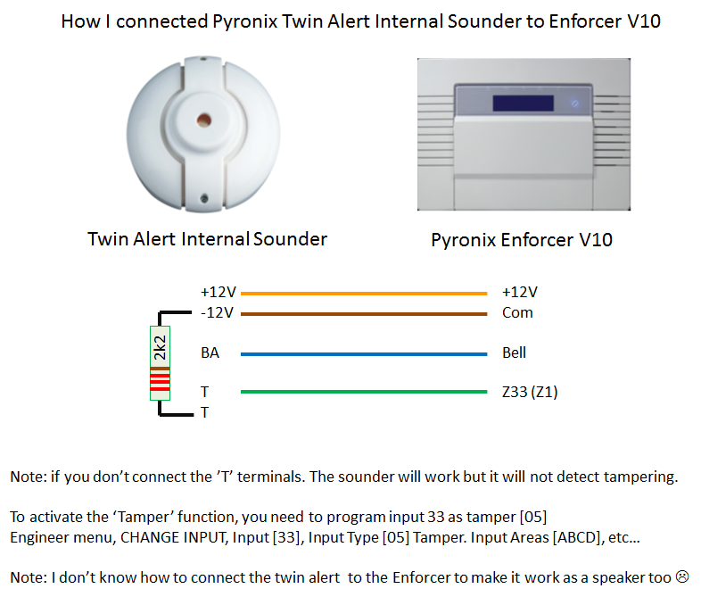

This is how i connected Twin Alert Internal Sounder (siren) to Pyronix Enforcer V10

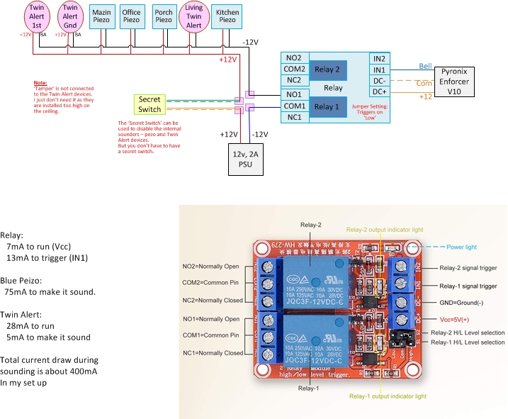

Connecting peizo and Twin Alert to Pyronix Enforcer V10
