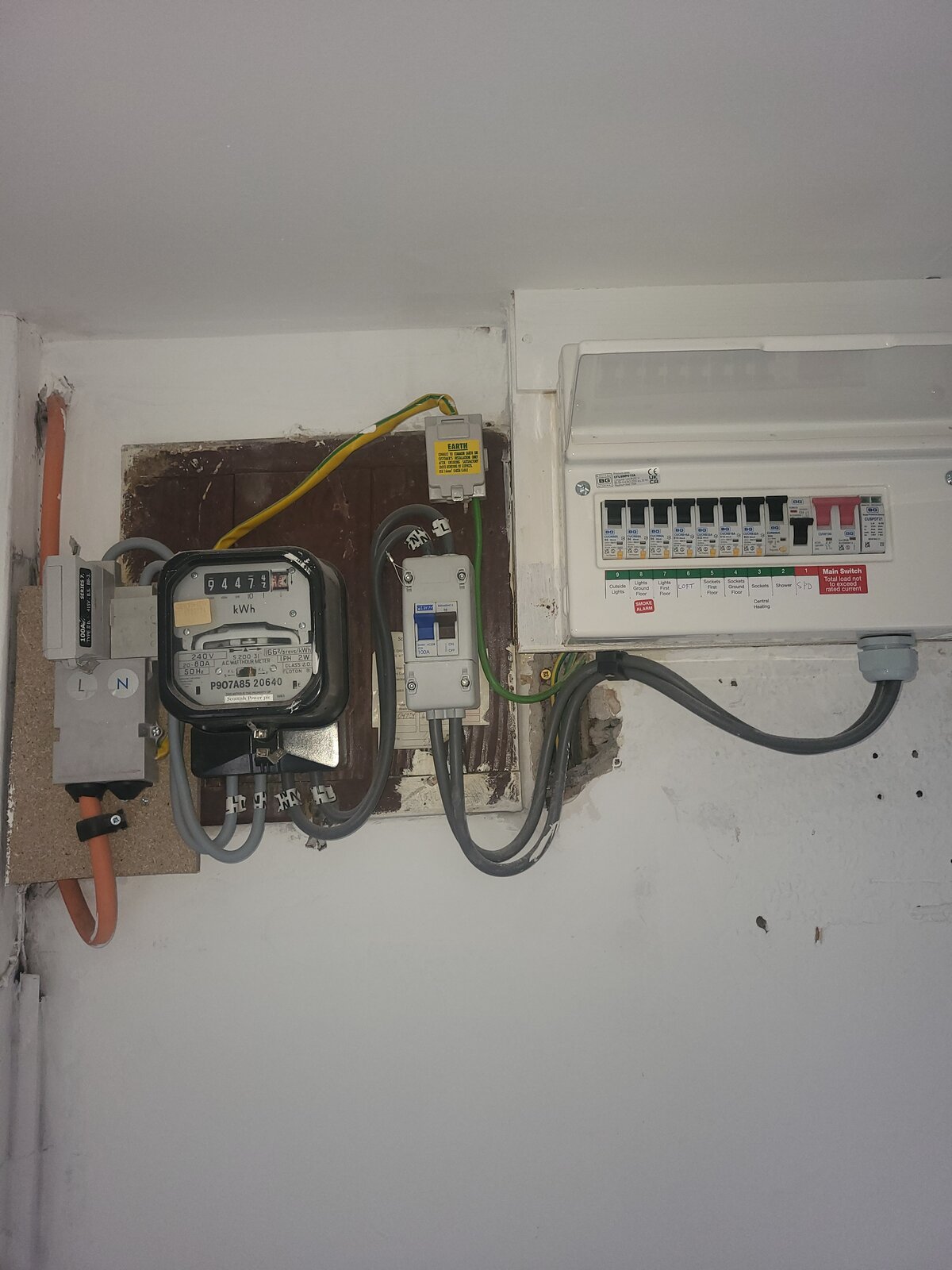

Just booked in for a smart metre, bit nervous if I am doing the right thing.
Also wanted to know if it will be connected to the electric with its own fuse spark isolator ie if something goes wrong with it that it won't trip anything else in my property?
Here's the current set up ie a photo.
Any advice appr
eciated
It will be connected exactly the same as the present one.
Thanks. Is the present one on its own fuse circuit so if something goes wrong with it and it trips, it won't trip anything else in the home?
Well, there is a fuse in the thing on the left but if it blows you will obviously have no electricity even though nothing on your consumer unit might have tripped.
Why do you think a smart meter will do this even though the existing meter never has?

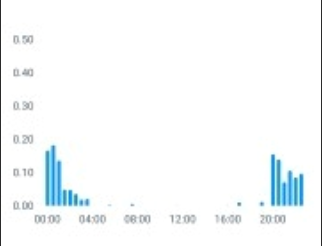

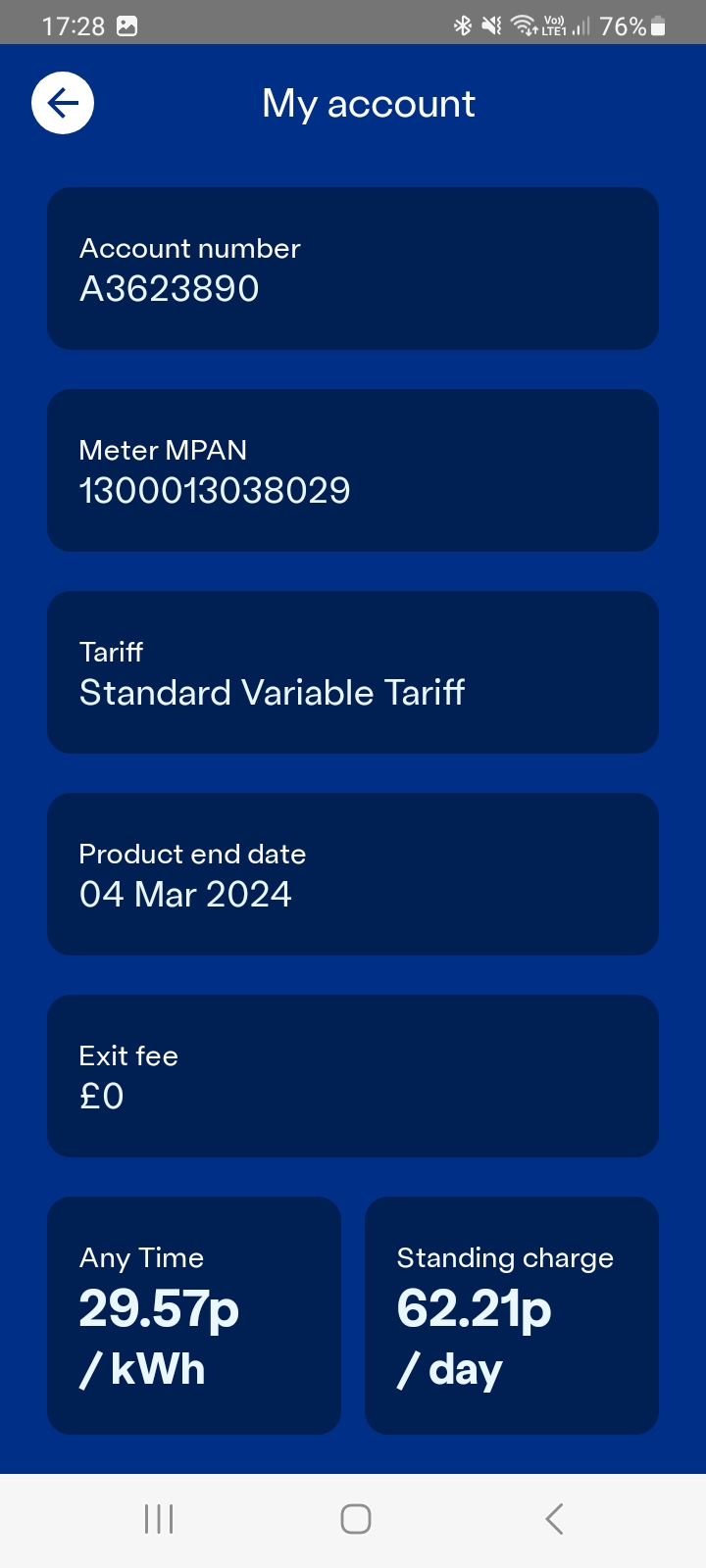

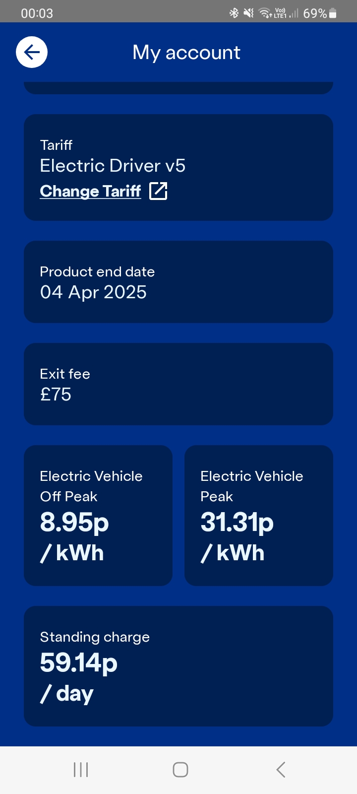

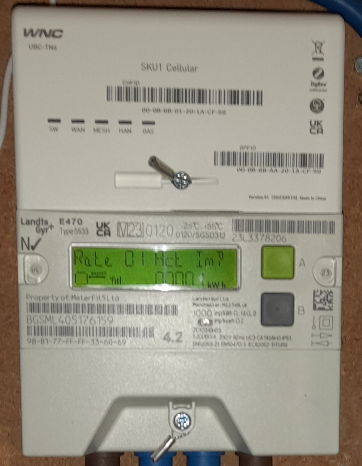

I had one fitted, I find it hard to read, Smart meter reading 4.jpg not a clue what these all are, the IHD (in home display) Exporting 1.jpg shows importing or exporting, but little else the advert Fred Bos smart meter.jpg is miss leading, no way can I turn lights on/off by clapping my hands, hey google works, but that is nothing to do with smart meter. The app on the phone Screenshot_20240304_172809_BG Energy.jpgScreenshot_20240305_000323_BG Energy.jpg took nearly 7 months to start working reasonably but the changing of the tariff to an EV tariff has saved me a lot of money, where I now charge my solar panel battery at night at 8.95p per kWh but this means day tariff went from 29.57p to 31.31p and the standing charge has gone down.
Typical day 1722959373458.png so use electric in the evening once solar stops, and in the morning on low rate, but rest of day hardly use any power, but unless you have solar panels, EV charging point, storage heating, or storage battery, it is unlikely you will get any gain from a smart meter.

Just that in my last home, after a smart metre was fitted the electric kept tripping. May have been a coincidence but just thought that I wanted to have it on its own breaker, but guess that wouldn't make any sense really as if it was faulty as it's the electric metre then we would have no electric anyhow? Is that right?
Maybe best just leave it how it is. Everything works fine. So why change it?
You don't seem to understand.
The meter is not "on its own fuse circuit".
It is on the main supply cable delivering the electricity to your property so that it can measure how much you use and you can then be charged for it.
It doesn't "trip" and won't cause anything in your property to trip.
That's about it for the existing meter.

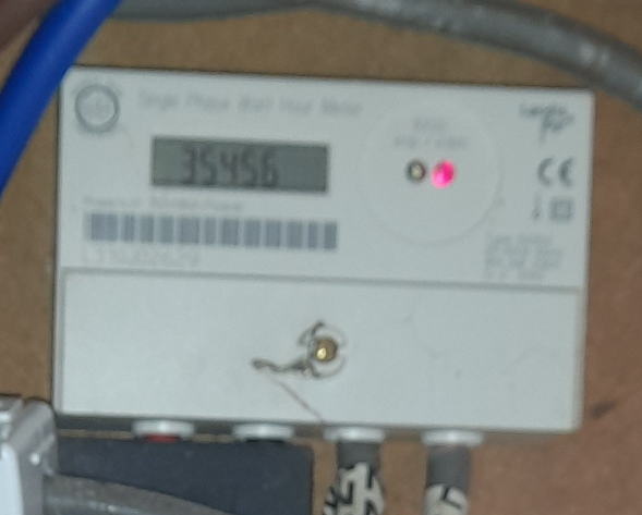

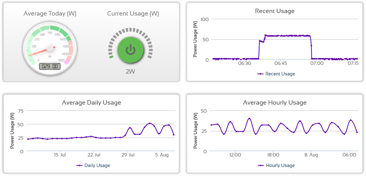

Until the radio 4 long wave switch off. The rules mean you can't be forced to have a smart meter, but neither can the supplier be forced to offer a duel tariff. The old meter was easy 1723096405893.png to read and see if energy is being used, these were replaced by a more compact design 1723096725852.png the lack of the wheel turning resulted in it being hard to work out how much was being used at any point, the flashing lights replaced the wheel, but still reasonably easy to read. The smart meter 1723097046077.png changed that, they vary, but to read one needs to press buttons, and how these are used was never explained to me, as shown with post #6 it shows a lot of info which in real terms we simply don't need to know. The in home display is easier to read, and should show far better how much one is importing or exporting at any point of time, however in my case the whole reason for the smart meter was because solar panels and battery had been fitted, so for most of the hours I am awake, the IHD shows either import or export, but not how much one is using in the house. So to try an work out back ground load and reduce it, I need to use the solar panel software, 1723097716185.png this does show how much the house is using, 337 watts at the moment, and to further work out what items use, we need plug in monitors, this 1723097884143.png is showing me how much one upright freezer is using, before the more straight line was how much chest freezer was using, the defrost cycle of the upright causes the sine wave on daily usage.
But the smart meter is a day behind with the phone app, and is a simple bar graph, so yesterday I know I used 0.40 kWh, about 0.12 kWh first thing in the morning, and 0.28 kWh last thing at night, but for the rest of the day, no information. And the app does not show export, and does not match up with the solar info, which says I imported 9.3 kWh which since we had 4 showers that day, and charged a 3.2 kWh battery, seems far more likely to be correct. The shower uses more than the battery or solar can provide, so it may only show 6 kW being used instead of 9 kW, but we will always use power from the grid when having a shower. Go back another day to the 6th and app for smart meter shows 5.39 kWh and solar software 5.6 kWh there is some confusion at the moment as when the day starts, does it start at 0 UTC or 0 BST? which for the 6th will explain why they don't match. But since smart meter shows I have used less than the solar software I am not worried.
But the app shows what used each ½ hour, so not really that useful. With solar software 1723099535563.png I know my wife likely went to bed at 3:25 am and made herself coffee before retiring, and I can see my battery lasted until 1 am when I started to recharge it, and at the moment we has just enough sun shine to start recharging battery from solar, compare the info from solar to info from smart meter, and it makes the smart meter look rather dumb.
